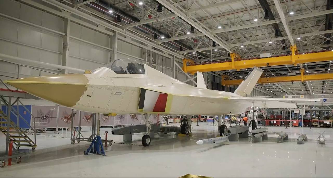

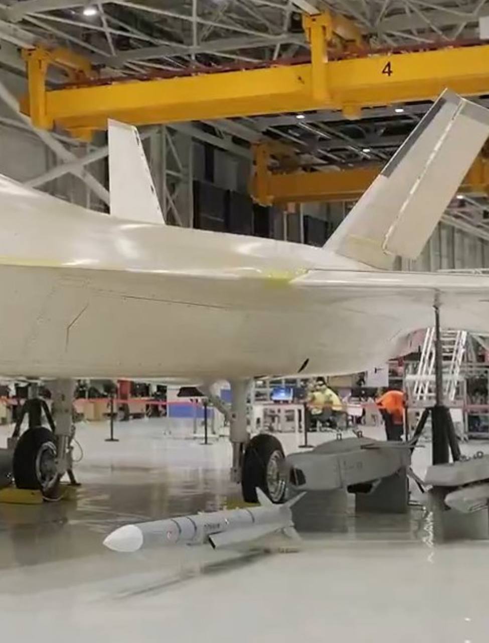

Could the Kaan carry a missile similar to ASM-3 inside weapons bays?
Weapons bay of Kaan is not like F-22 or F-35, more like SU-57 with the weapon bays between the engines. Allowing for longer length missiles/bombs.
Could it carry a 6 metre ramjet missile in stealth configuration?
In order to inflict enough damage to a ship a missile needs to be :
1. able to carry adequate explosives and/or
2. have plenty of kinetic energy during impact.
The ASM-3 missile is approximately 1000kg in weight. So it should have enough explosive on board to sink a ship.
At nearly 3 mach speed on impact, it possesses enough kinetic energy to rip through any ship’s hull.
It has a diameter of 35cm and a length of 6 meters.
We can just about fit SOM-J in to the IWB of KAAN. SOM-J is 3.9 meters in length and 540kg in weight.
The measurements related to KAAN and its internal bays are classified information. We can only make educated guesses. But what we know tells us that it is not possible to carry such a large missile in IWBs of KAAN.
ps SU57 IWB length is 4.4 metres
