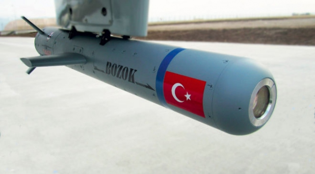

BOZOK Laser Guided Ammunition, developed by TÜBİTAK-SAGE, successfully completed its firing tests and started mass production.
> It has been quite some time till i heard about BOZOK but it finally entered serial production.
Ammunition Weight: 16 Kg
Ammunition Diameter: 120 mm
Ammunition Length: 80 cm
Miniature Design
- BOZOK Phase-I has a range of 10 kilometers. Thanks to the specially developed Tungsten multi-particle warhead, BOZOK will be very successful in anti-personnel missions.
Miniature Design
I guess Bozok is set to replace MAM-C or at the very least be preferred over MAM-C.

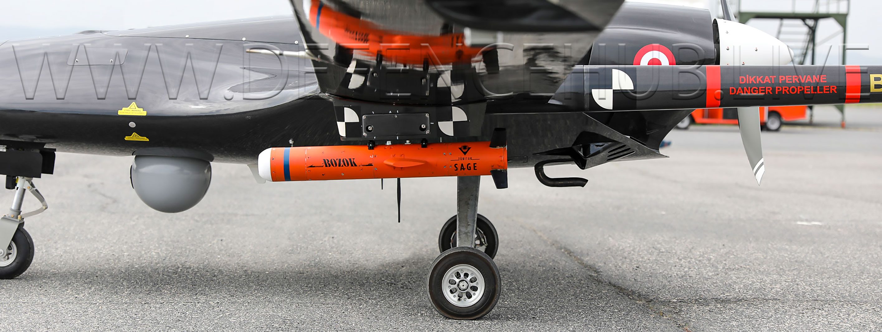

Instead of 4 MAM-L the TB2 is maybe able to carry 6 Bozok.
Keep things small and affordable to punch the maximum damage. You don't need F16's with million dollar missiles to destroy enemy tanks, destroy them at the most affordable way and the enemy can't keep up with the cost that war brings upon him.

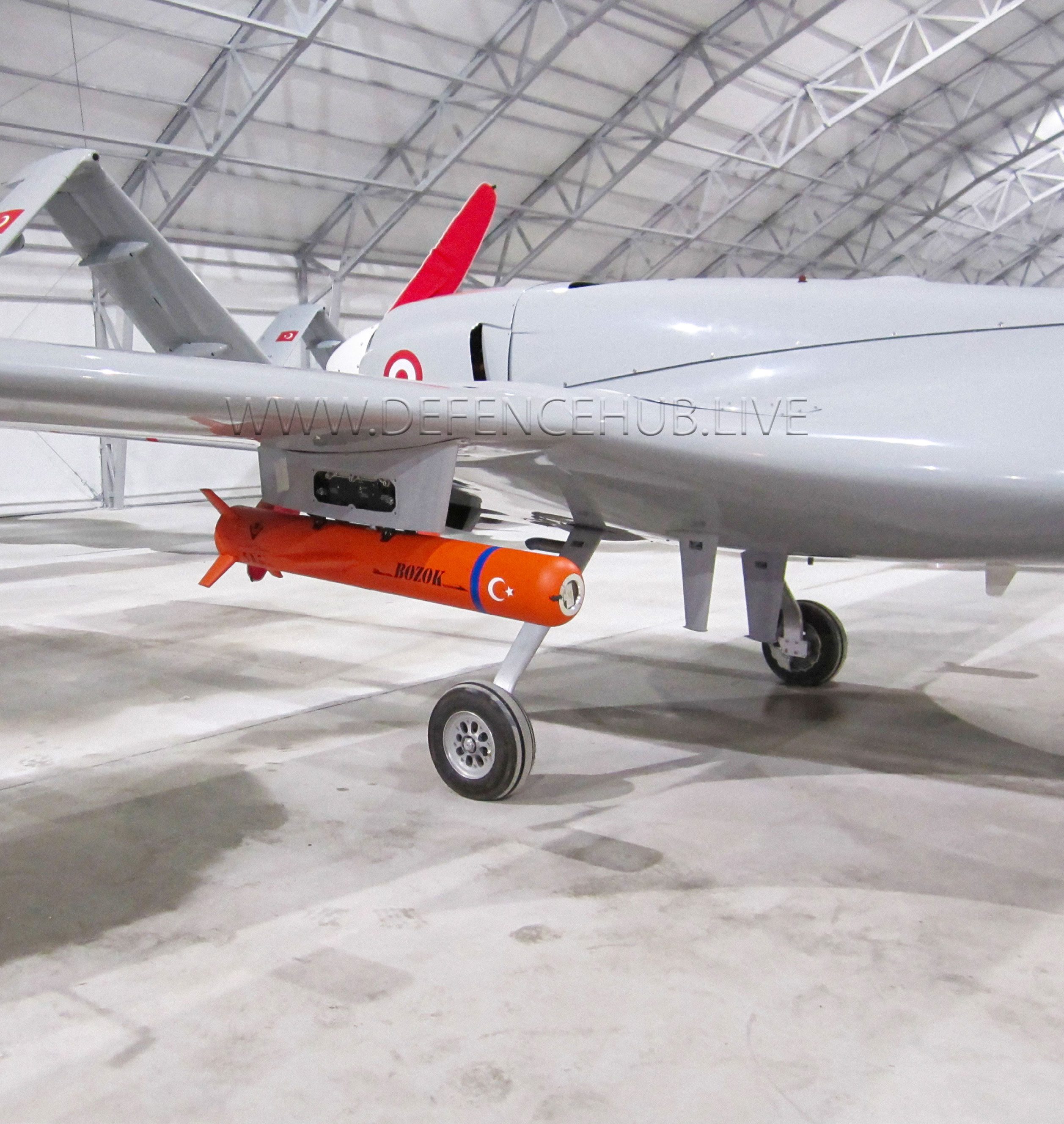

But aren't weights of Mam-c and Bozok different? I though Bozok is somewhere between Mam-c and Mam-l
Specifications​
MAM-CBOZOK Phase-IMAM-L
Weight​
6.5kg16kg22kg
Warhead Weight​
2.5kg5kg (*based on old brochure)8-10kg (Depending on warhead type)
Range​
8km11km8km - *Optional 14km with mid-course navigation package
Length​
970mm800mm1000mm
Diameter​
70mm120mm170mm
Seeker​
Semi-Active LaserSemi-Active LaserSemi-Active Laser
Mid-Course Navigation​
MEMS-IMUMEMS-IMU and Inertial Navigation System/Global Positioning SystemMEMS-IMU (*Optional - Inertial Navigation System/Global Positioning System)
Fuze​
ImpactImpact and ProximityImpact and Proximity
Warhead Types​
  • Tri-Mode
  • High-Explosive Blast Fragmentation
(First phase of development has one type of warhead,
further iterations could see various warhead types)​
  • Tandem Effective Against Reactive Armor
  • Thermobaric
*Inertial Navigation and Global Positioning gives weapons ability to be used in all weather conditions - it also allows multiple weapons to be launched at separate targets simultaneously as the terminal-phase semi-active laser seeker isn't required to home in on targets. (downside, accuracy is reduced but within certified CEP)
Mam-L has tandem anti armour head. Bozok does not. You need the explosive weight of the Mam-L to penetrate tank’s armour. Just check out #964!
