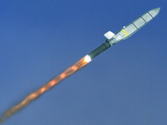

Why is there no surface launched SOM-C as it seems superior to the ATMACA?
Two different designs. They are superior to each other in their own right.
Atmaca
There is a version that is being prepared for launching from land to sea targets. (The initial firing tests were done from land positions toward the sea)
Also beach and inner areas of land will be targeted with the new version that is coming.
Atmaca is a sea skimming circularly shaped missile. It is optimised for hitting naval targets. It is our answer to new versions of Exocet and Harpoons.
SOM
This is a missile that is optimised for air launching. It has a very different geometry with it’s wings if compared to Atmaca. It’s shape, which is made of straight surfaces is a stealthy shape. It’s paint is supposedly has properties to absorb radar signals. Not easy to launch from land with that shape. As it can follow contours of land after launch, a standard SOM missile will go low and be out of radar detectability.
A special booster has to be used to launch it from land. It’s aerodynamic shape is not easy to assist land launching.

I meant ship launched like the LRASM from the MK 41
It’s certainly possible to do right?
It is possible. Yes. But when you have two different forces (airforce and navy) that want different missiles for themselves, you get a Harpoon beater and a storm shadow lookalike.
Now that we have Mr Ismail Demir in charge of all new such developments we hope that one Swiss knife that serves both purposes will be possible.
According to Gurcan Okumus, the head of Tubitak Sage, the SOM missiles have a modular and expandable architecture. Hence can be easily modified so that it can be launched from Sea and Land positions with the help of a booster rocket. There is ongoing work on the matter and the missile will gain Sea and Land launch-able capability when the work is finalised. Even though they have not got a contract to do the work , Sage is still working on it to make it happen.
