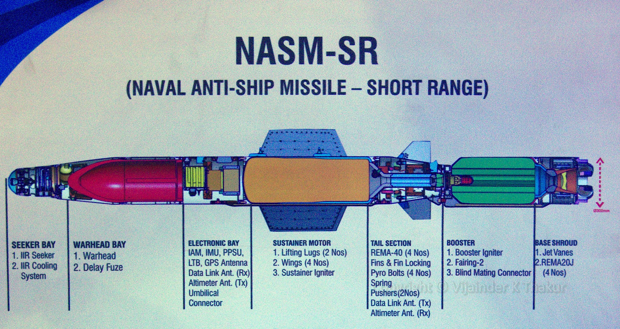

Another upcoming cruise missile :

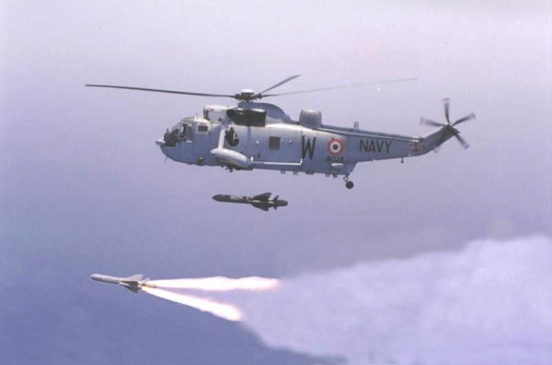

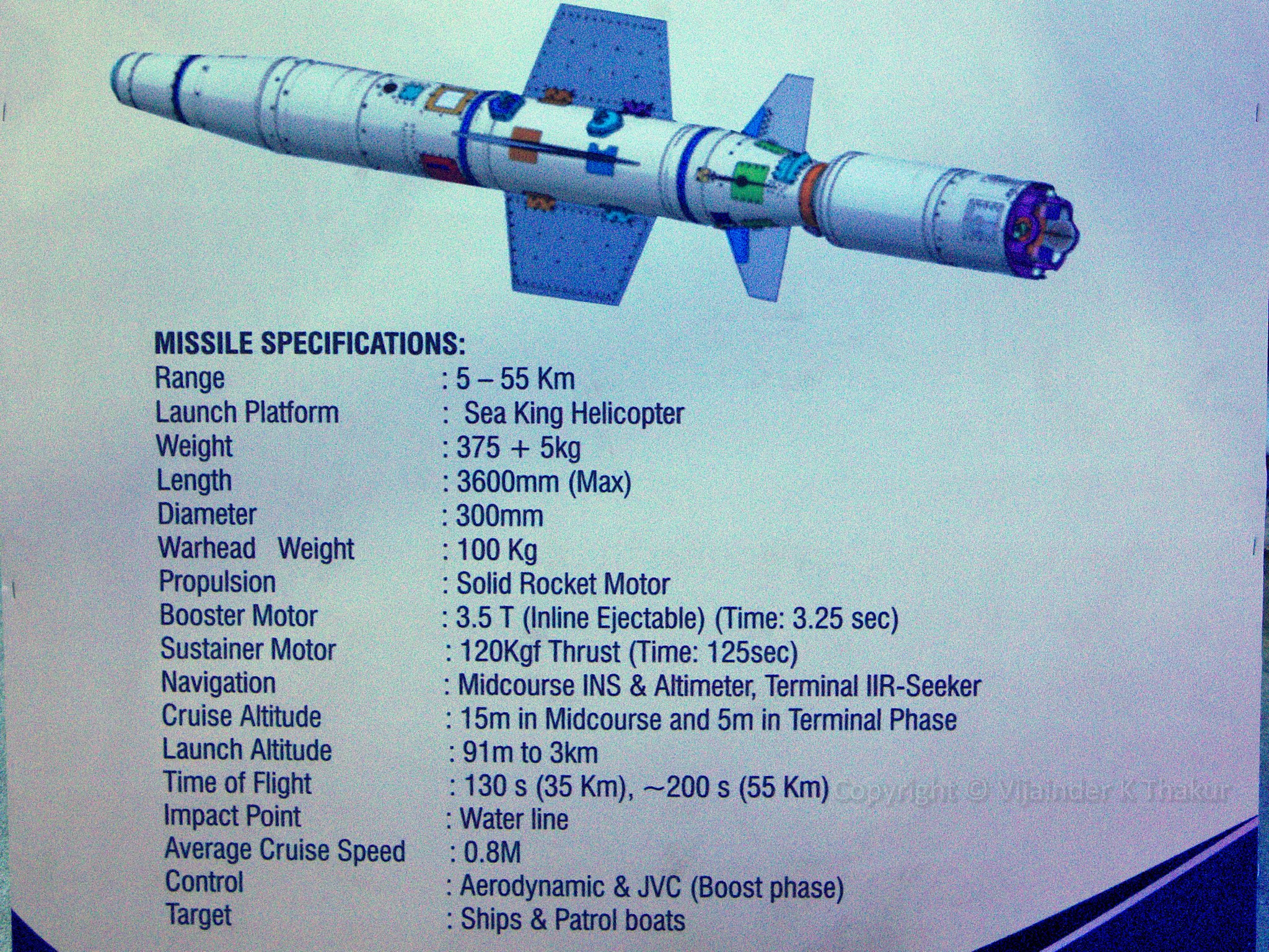

The sea skimming missile is being developed for use from Sea King helicopters. It's an air launched anti ship missile to enable carriage by Indian Navy's shipborne Sea King helicopters to replace the currently in use Sea Eagle missiles(pic below). The SR in the name suggests there will be a MR and LR version in the future.
I'm intrigued by the jet vanes on the booster. Why so much engineering into something that will ultimately be dropped into the sea?
Gautam
159
1 696
The NASM will have multiple variants both by range and by operating platforms. We have plenty of large patrol boats that are essentially unarmed. At some stage it is likely that some variant of the NASM will find itself mounted on those boats using inclined launchers. Those jet vanes will come in handy in case you need over-the-shoulder missile firing capability.
The production line for all the variants of the missile will be the same, at least initially. So it makes sense to have maximum possible commonality in components, LRUs etc. You can save a lot of time & money that way in the long run. This is a lesson we learned the hard way with the Pinaka MBRL.
11,084
153 22,645
Probably also helps with fast acquisition of pitch and roll stability (esp in adverse conditions). Leaves less for the main motor and its control system to do...they can then be optimised by mass/size more.
