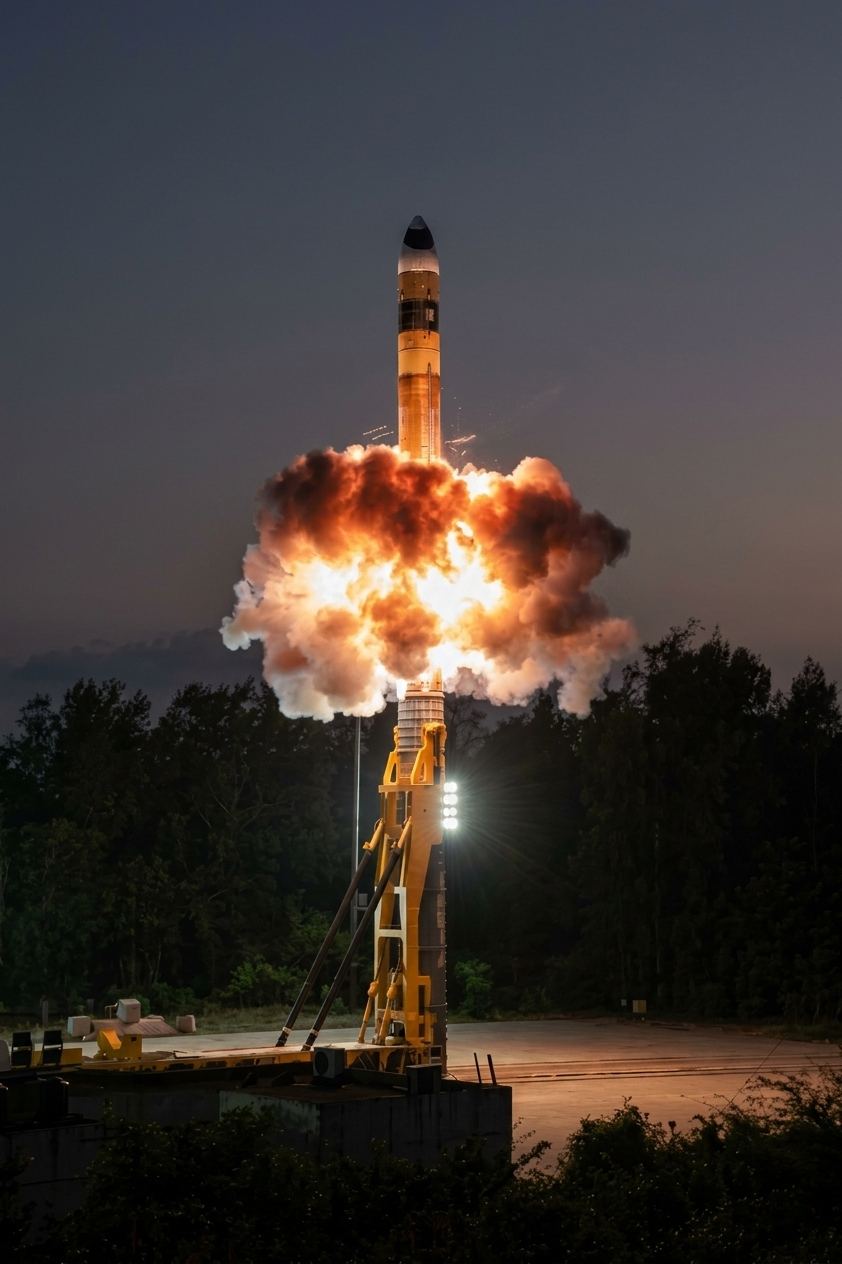

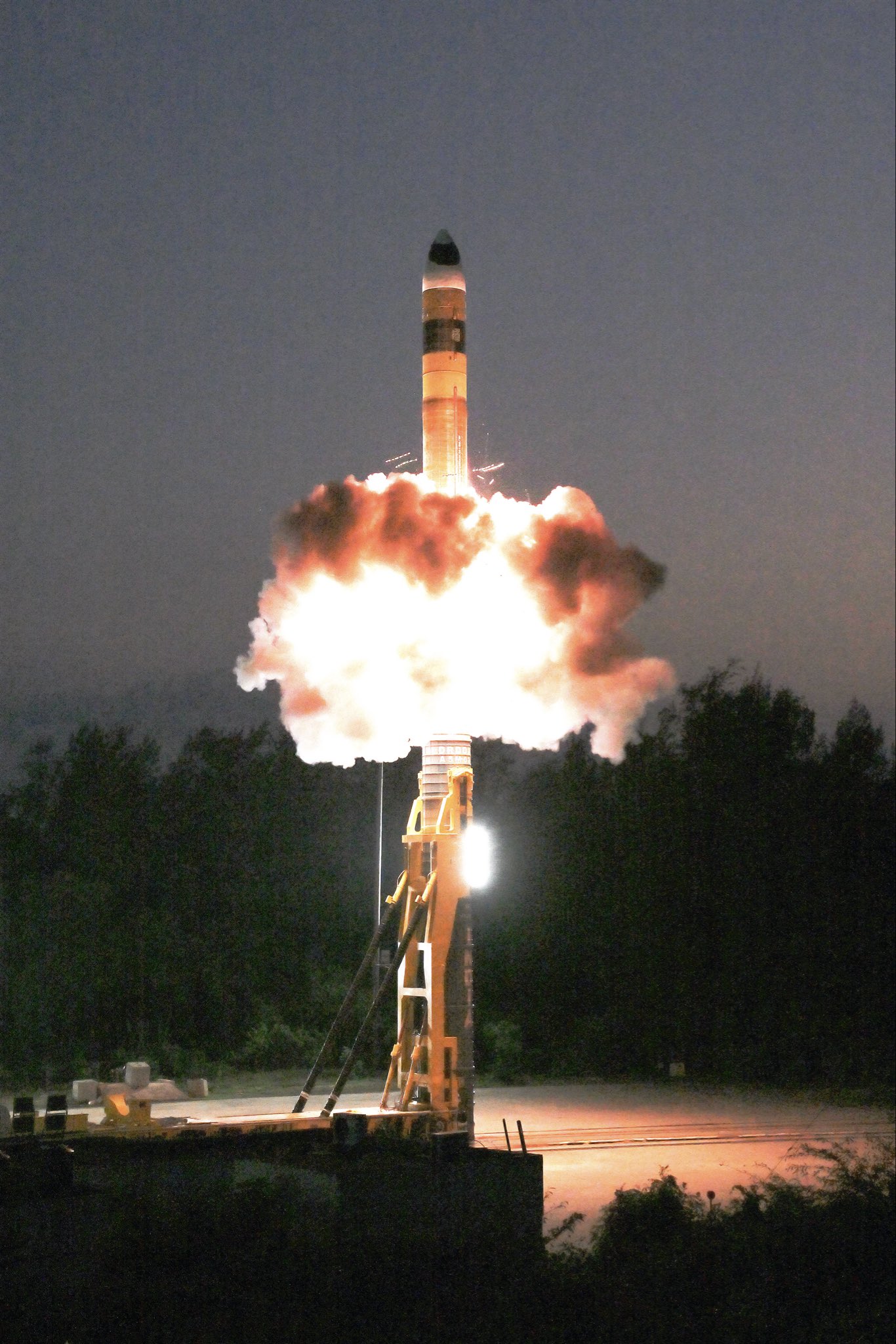

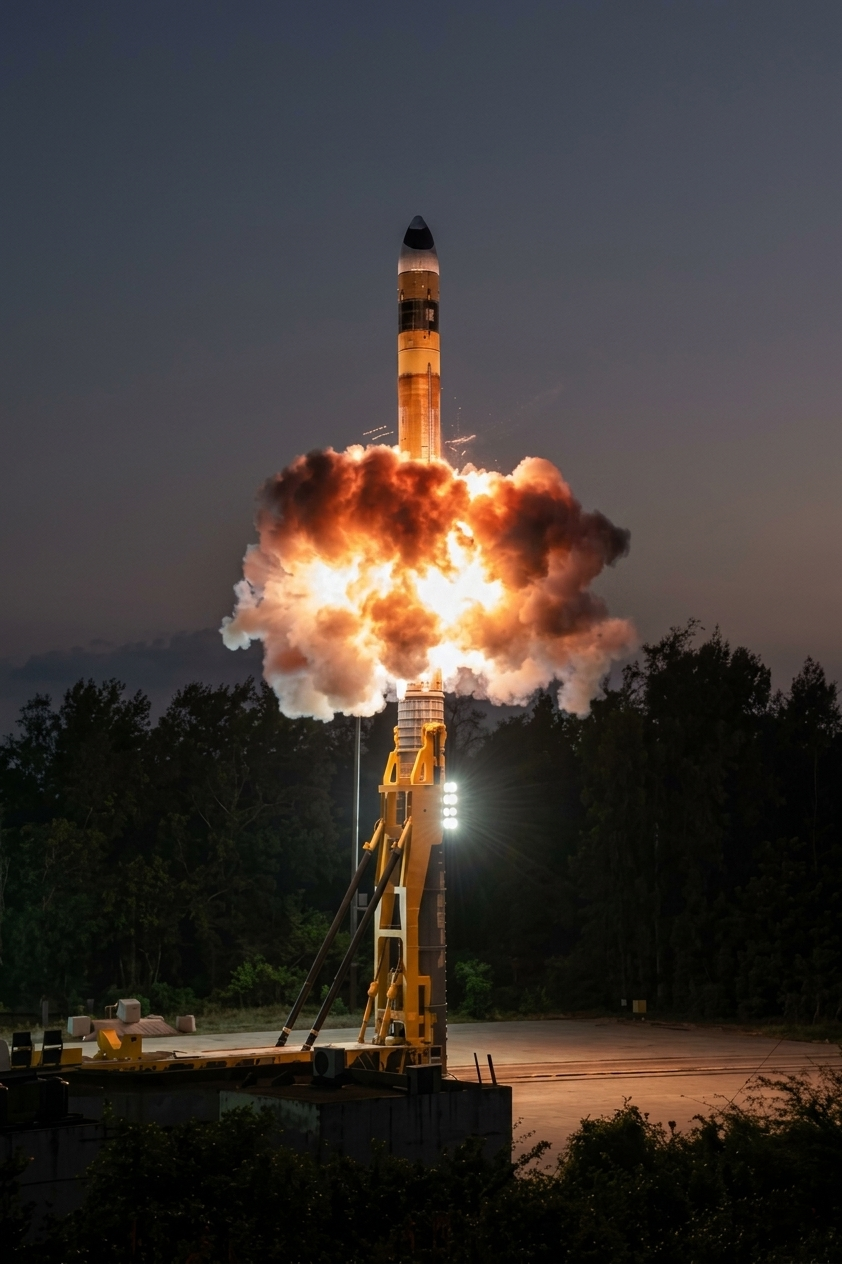

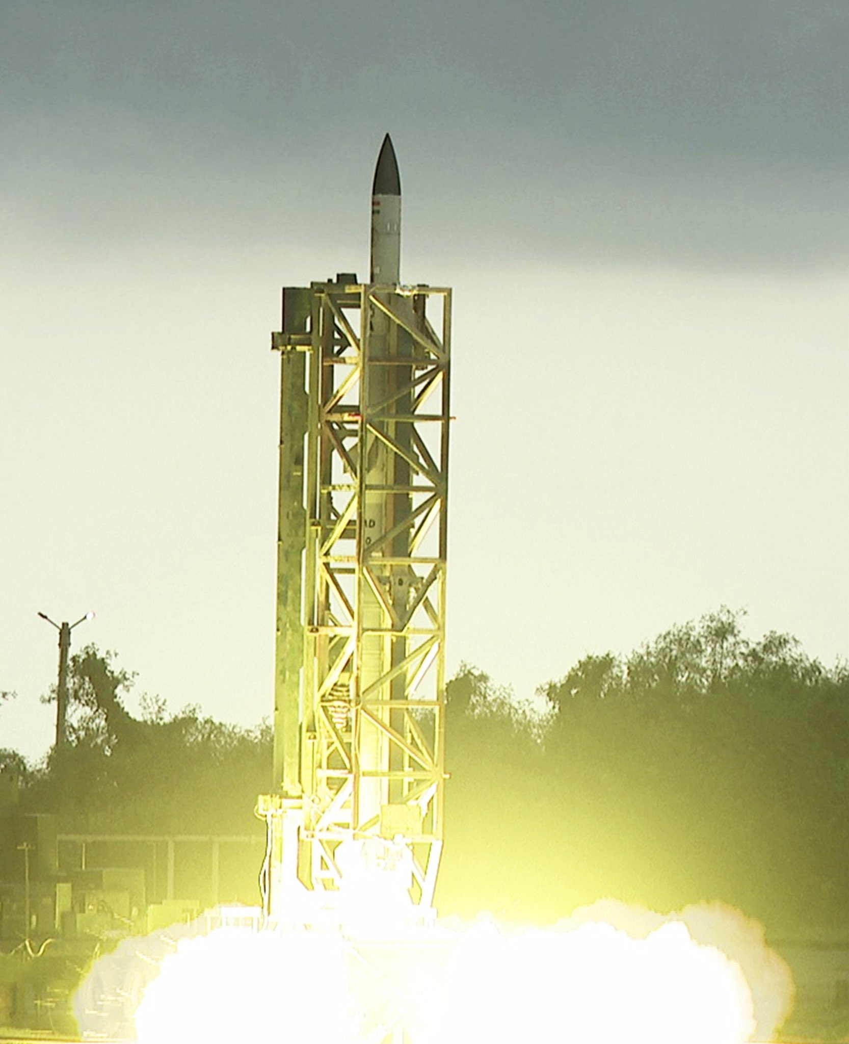

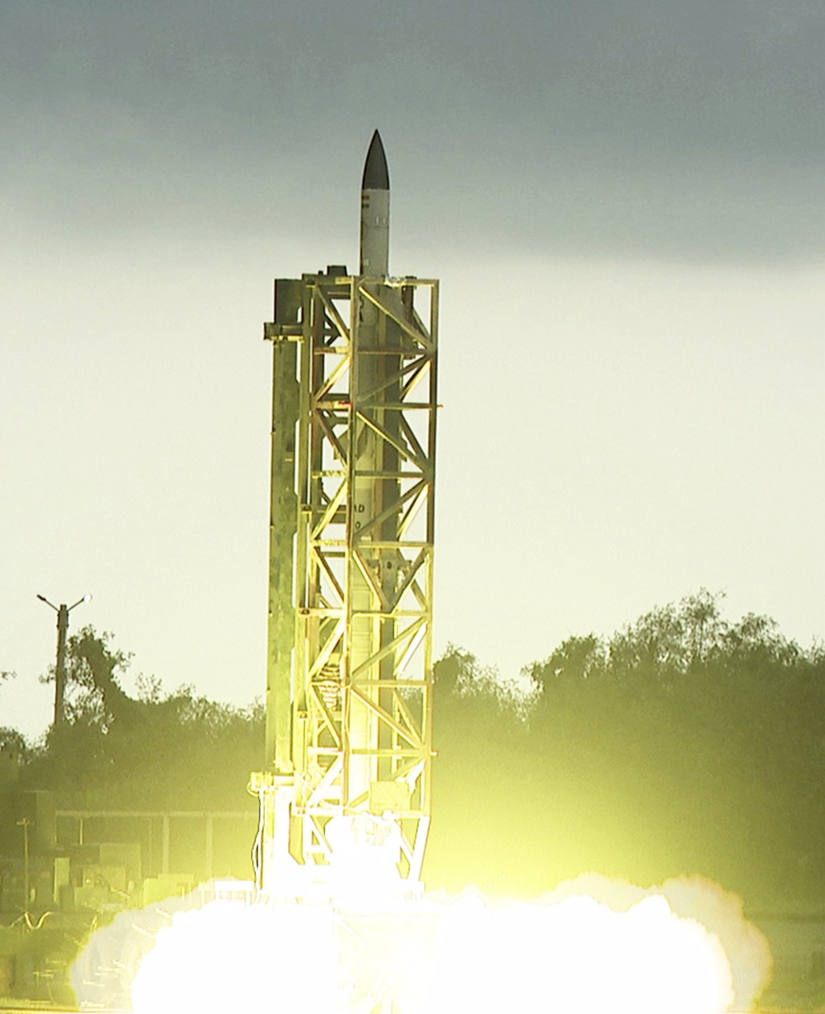

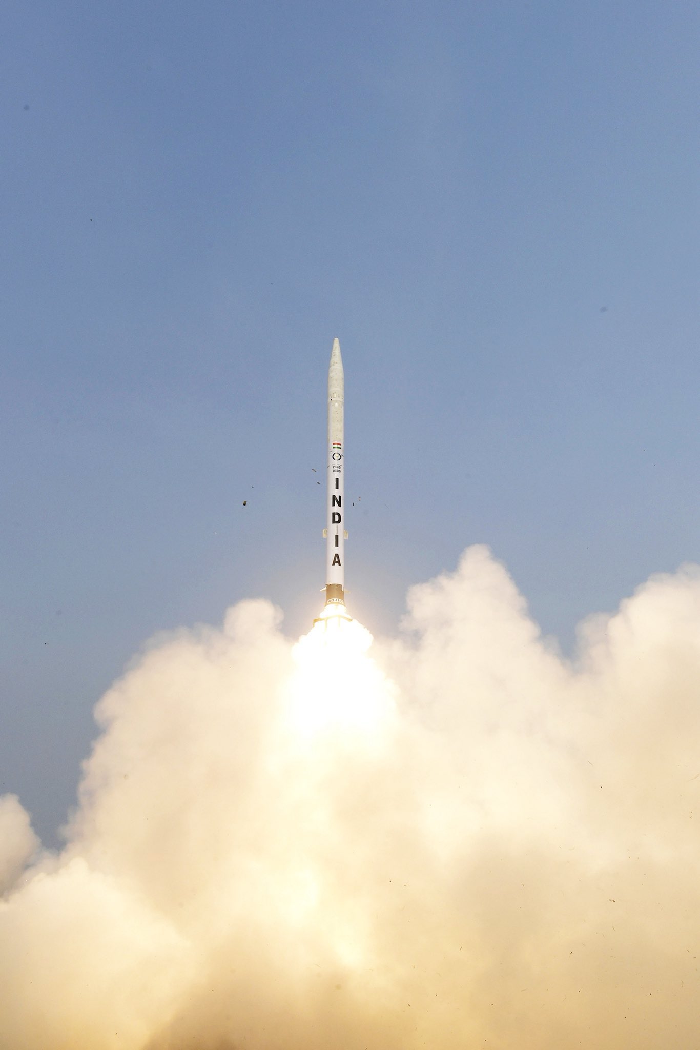

Here we go - it was a MIRVed Agni!
"Advanced Agni missile with MIRV (Multiple Independently Targeted Re-Entry Vehicle) system was successfully tested from Dr. APJ Abdul Kalam Island, Odisha on 08th May 2026. The missile was flight tested with Multiple payloads, targeted to different targets spatially distributed over a large geographical area in Indian Ocean Region."
Edited & color-corrected version of the pic found on another forum:
This is the first (known) night-launch of the MIRVed Agni. Note that they do not specifically refer to it as Agni-V anymore. I speculated previously that the MIRVed platform represents the notional 'Agni-V Mk.2'.
Seems the "Advanced Agni" is pretty much that. Also worth noting is that it seems this test was conducted on a lofted trajectory (hence the ~3500 km NOTAM instead of the platform's original +5000 km reach), though I have to wonder if that's not a result of the increase in payload.

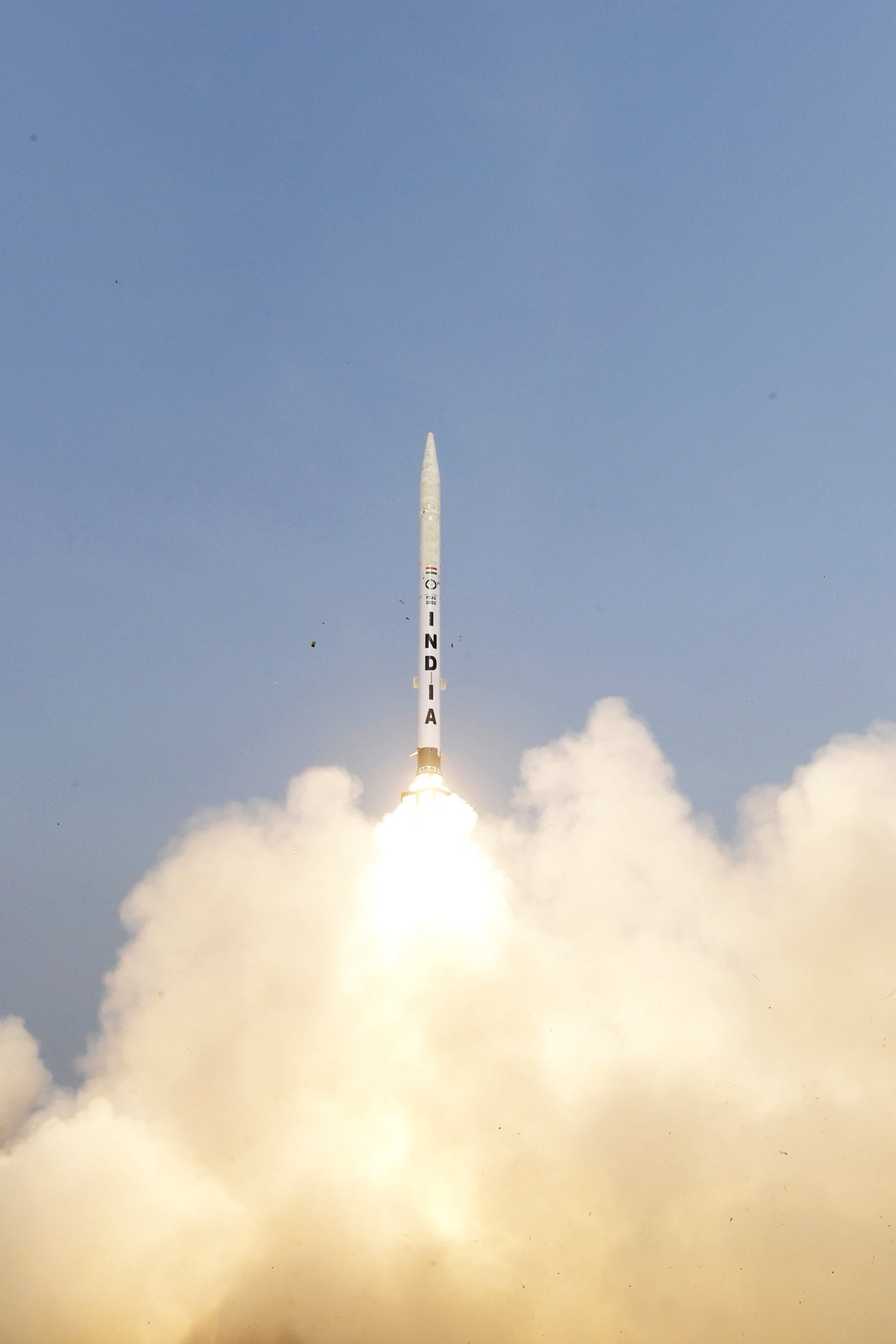

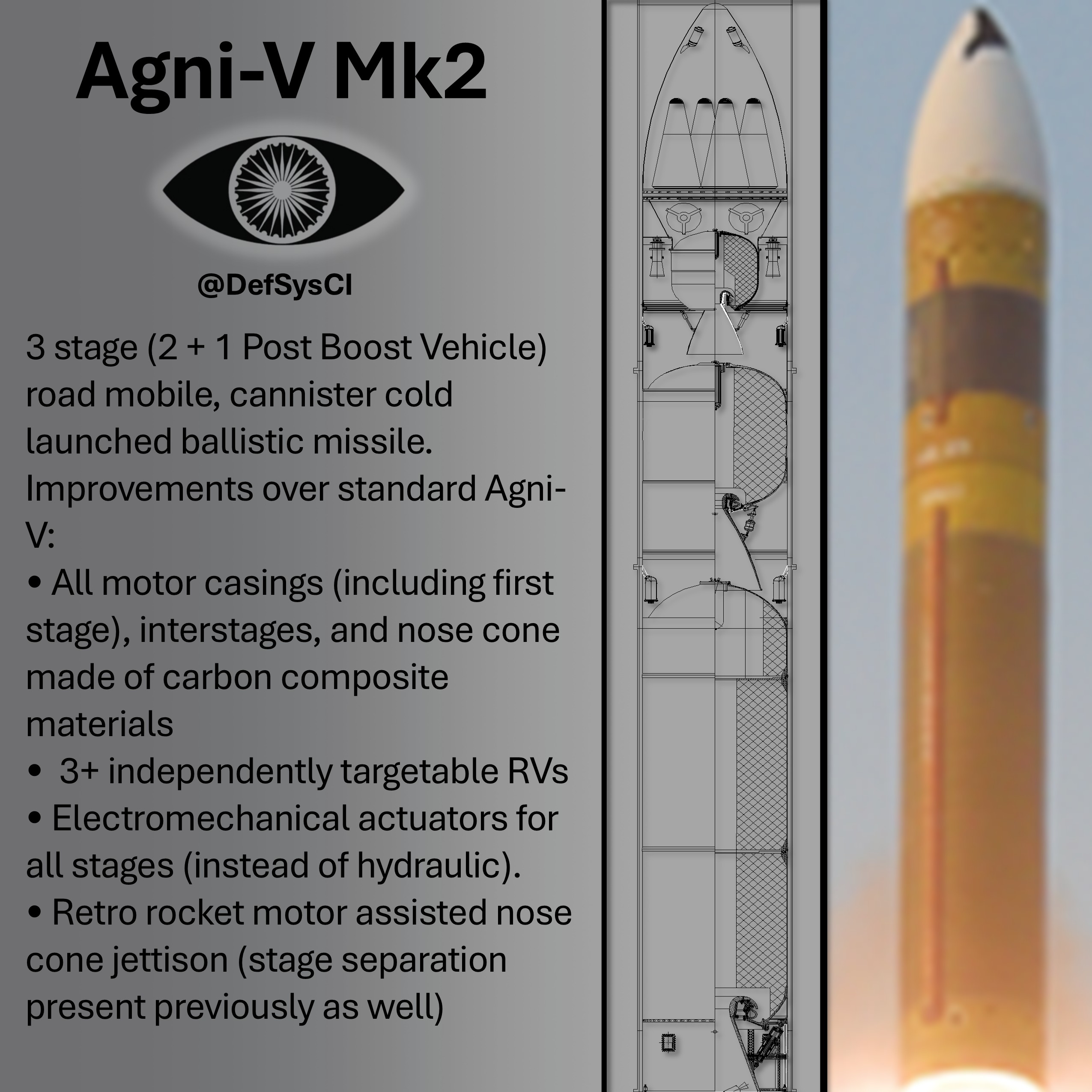

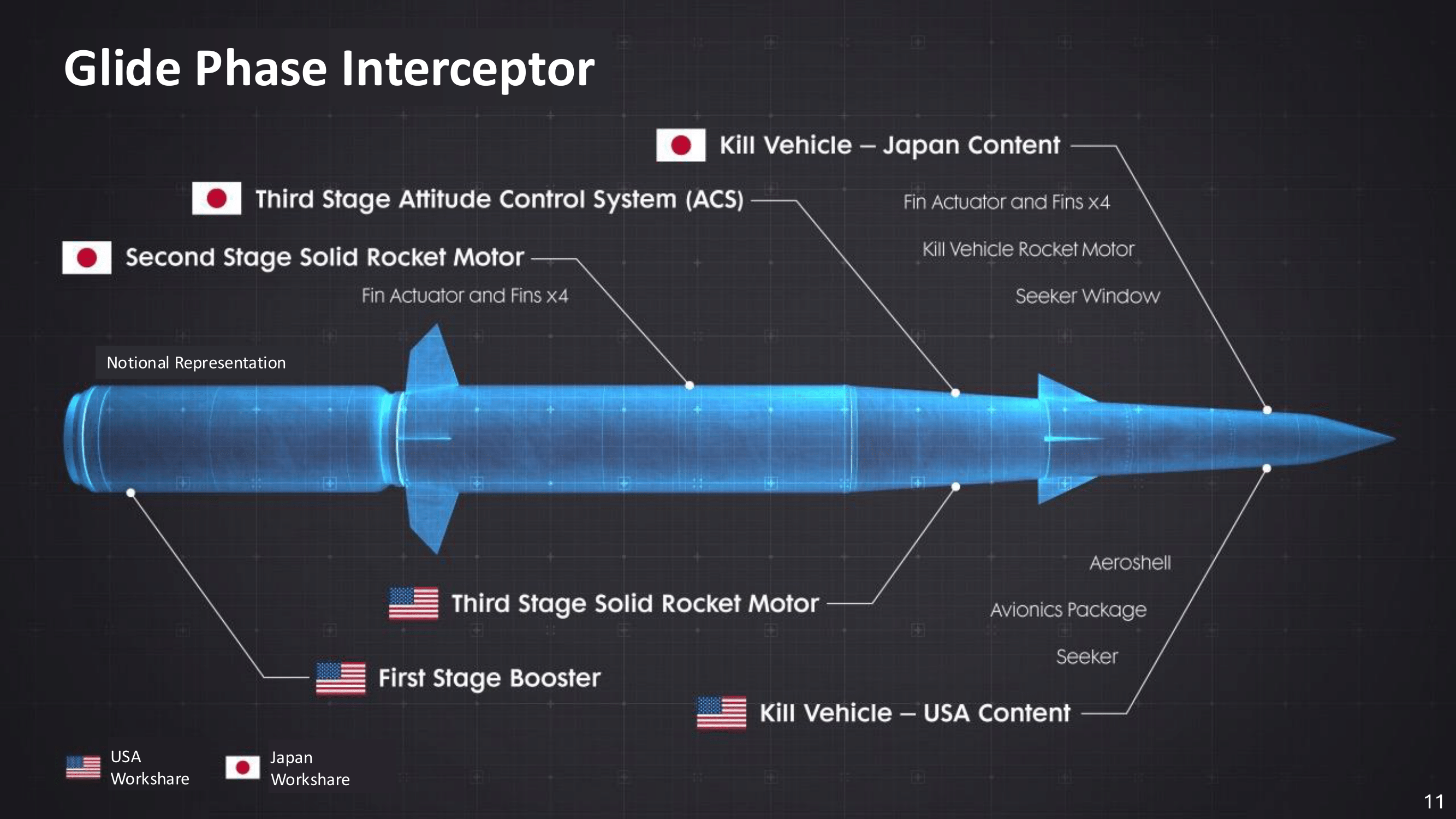

The Agni-V Mk2 (Divyastra) is an advanced, MIRV capable iteration of the Agni-V. Major improvements include replacement of maraging steel first stage casing with one manufactured using carbon composite filament winding, It is India's largest composite casing for now.
That, combined with the use of electro-mechanical actuators, rather than electro-hydraulic ones, for the flex nozzle control for all stages, have lead to weight savings as compared to the baseline Agni-V, which weighed around 50 tons.
The PBV may be separate from the 3rd stage, as per some knowledgeable watchers.

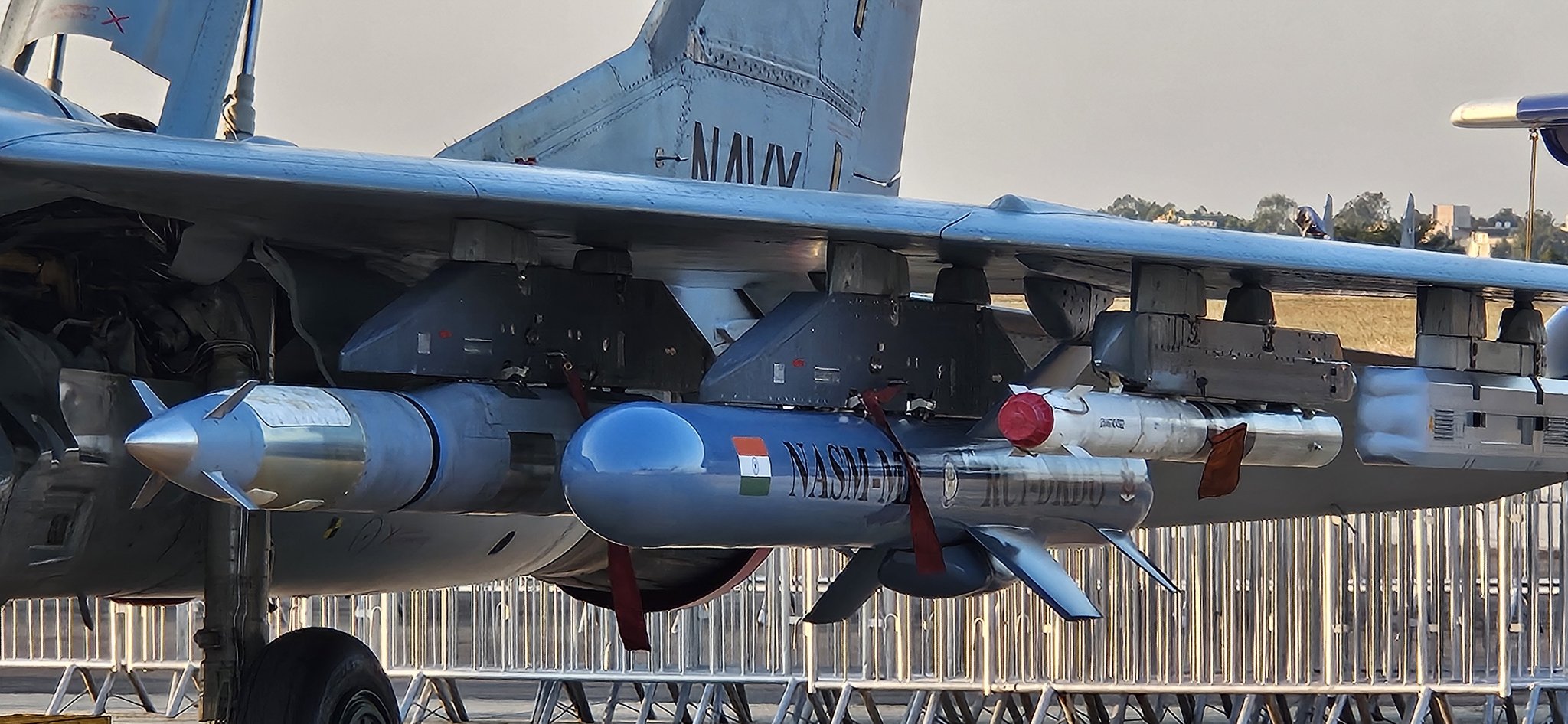

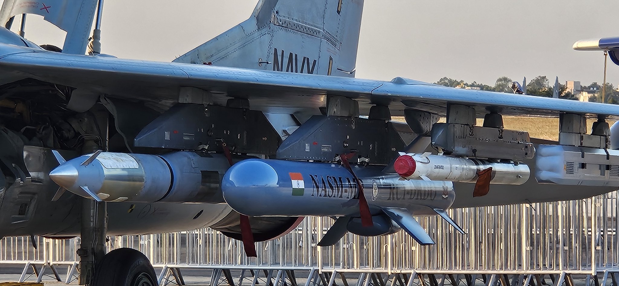

NASM-MR, a longer-ranged member of the new NASM family. Unlike the short 55 km-ranged NASM-SR which is entirely rocket-powered, the NASM-MR has an air-breathing turbofan (believed to be a scaled-down version of the STFE Manik developed for Nirbhay/LRLACM):
Specs:
Display model mounted alongside Rampage on a Navy MiG-29K:

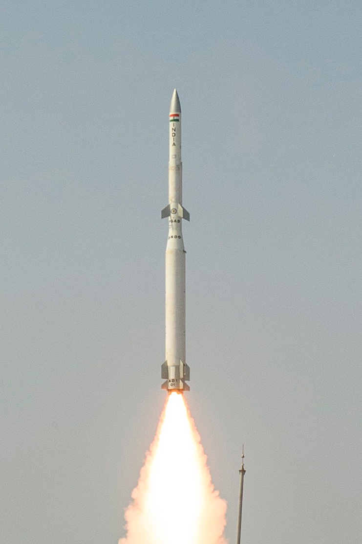

Video of recent launch, I'm guessing this was AD-2:
I had a feeling you would give us a good follow up. Thanks bud.

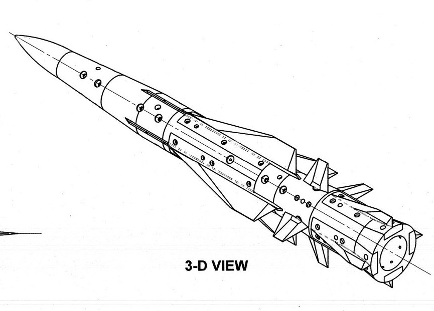

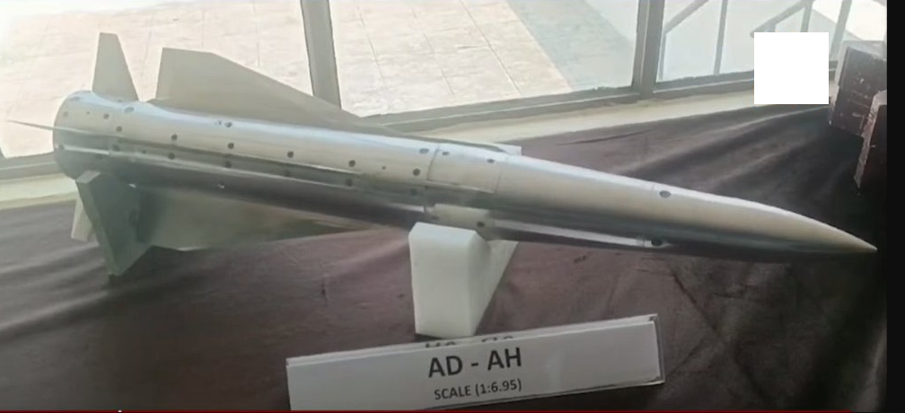

We have seen a hypersonic wind-tunnel model of the AD-AH (Anti-Hypersonic?) flight body before:

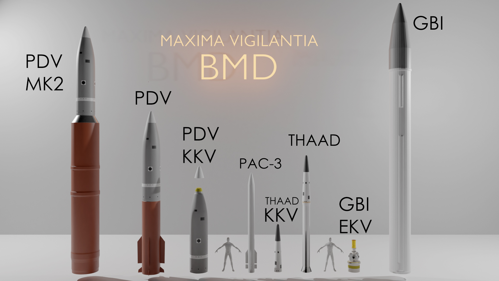

And this tender document image:
Along with some nice graphics (based on those model) made by various people on Twitter:
It's quite evidently meant to be a "anti-HGV" system, which at least nominally makes it similar in intent to Northrop Grumman's GPI (Glide Phase Interceptor) now being jointly developed by US & Japan...

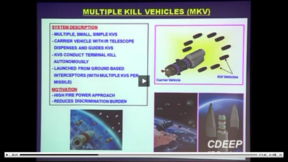

The AD-AM (Anti-MIRV?) on the other hand has never been seen publicly in any form, to the best of my knowledge. On the face of it, this is a similar capability as what is envisaged under the US MDA's Multi-Object Kill Vehicle (MOKV) program:
It serves to know that DRDO has had an ambition for this anti-MIRV capability for over a decade at this point, as this slide from that famous 2014 VK Saraswat presentation at IIT-Bombay shows:
The US is no longer pursuing the MOKV as a standalone capability but expects the NGI (Next-Generation Interceptor, replacement of current GBI) to have similar MKV/MOKV capabilities incorporated to tackle Russian/Chinese MIRVs.
With China having a mature & proven MIRV capability (and Pakistan also possessing a limited version of it), I think it's fair to say that AD-AM will be the culmination of whatever MKV-related R&D that we had been cooking for the last decade plus. If we put the AD-AM KV on a K4 SLBM-sized booster (like we did with the PDV Mk-2/XSV-1 ASAT), we get an interceptor that begins to approach the dimensions of the NGI/GBI, this could be necessary to tackle Chinese SLBMs, while a smaller Agni-1P booster should be sufficient for Pakistan's Ababeel or any possible medium-range MIRVed SLBM they could acquire in future (this is all assuming boost- or ascent-stage interception fails).

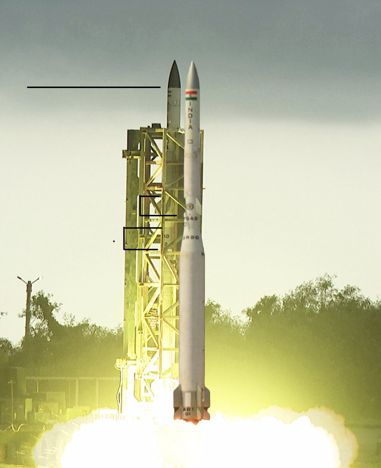

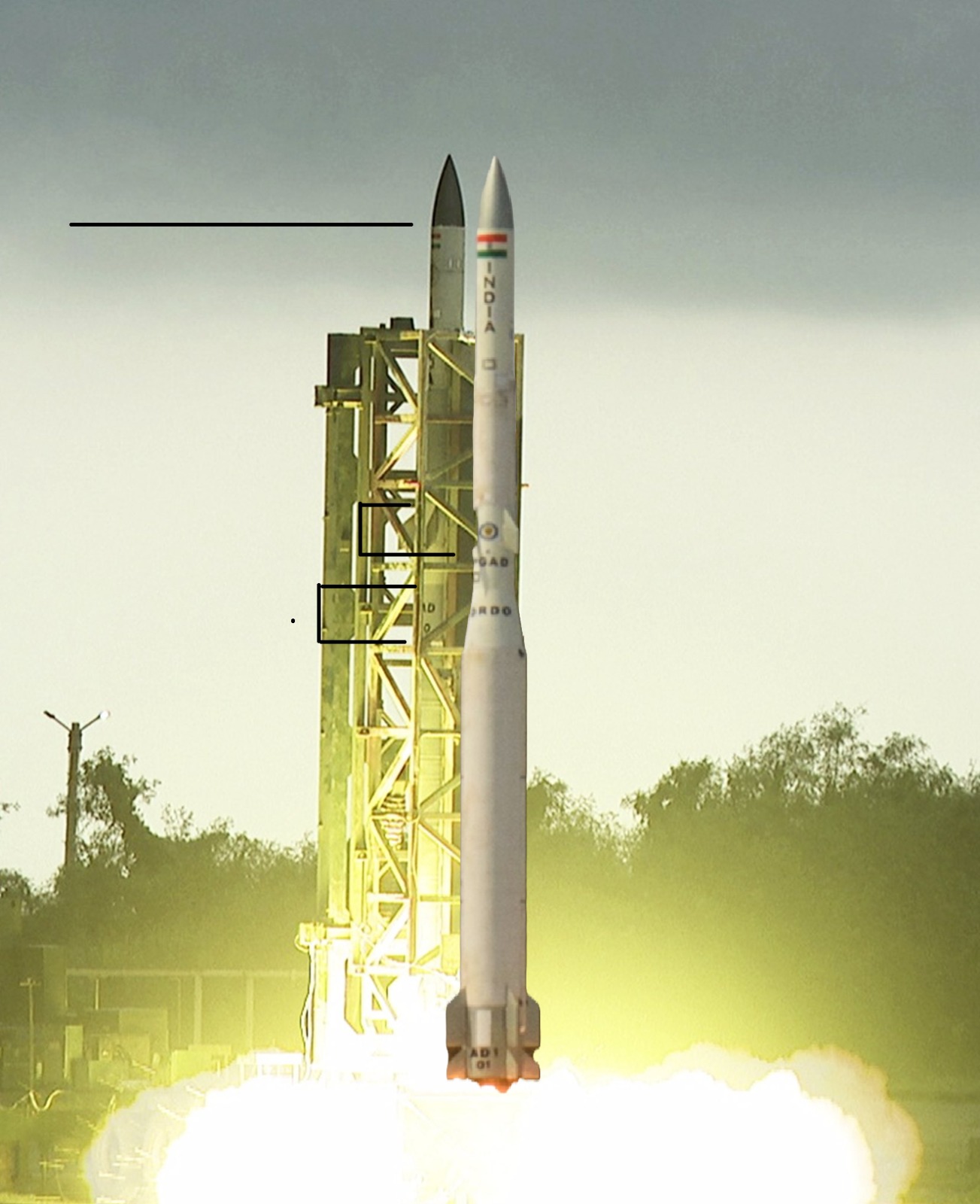

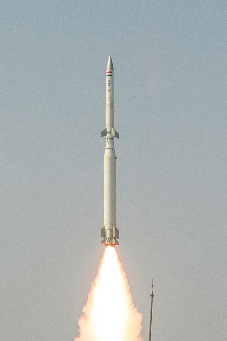

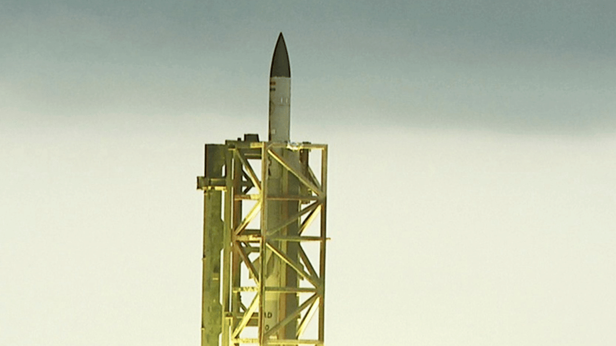

It appears the booster rocket has changed design:
Earlier booster:
Additionally, it seems the latest launch was conducted from an actual sealed canister instead of the skeleton-frame launcher used for earlier tests. Operationally, it would be deployed in canisters so that's progress. This test is also confirmation that LRLACM would use a 8x8 truck. A recent L&T poster displayed a test configuration of 4 x LRLACMs on a 8x8 truck (without canisters of course):
AI gives us a closer look at the bottom-right:

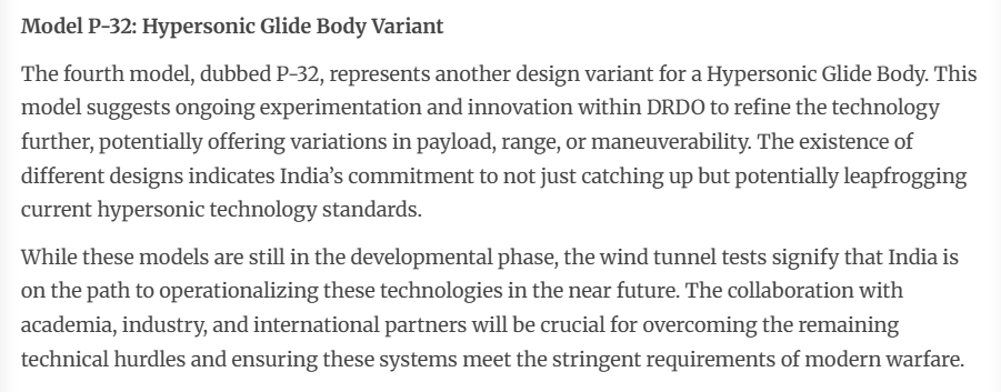

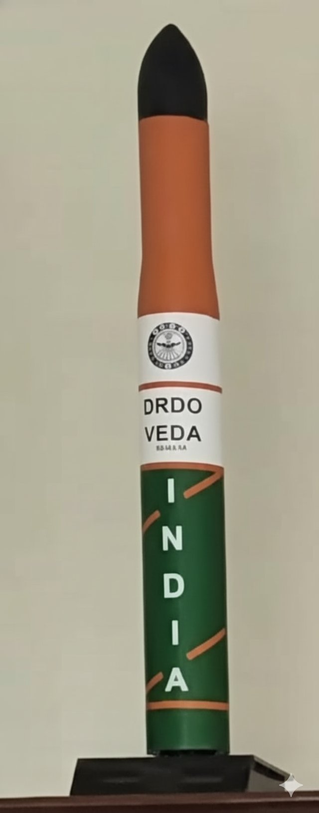

Seems a new system is getting close to launch testing. The shape (wider booster section that tapers into a slimmer upper stage) resembles the VEDA satellite launch vehicle, which we know has been under development:
But GODOFPARADOXES indicates this is "P-32", which was previously reported by some as a Hypersonic weapons program:
So it remains to be seen what exactly this is. Very interesting nevertheless.

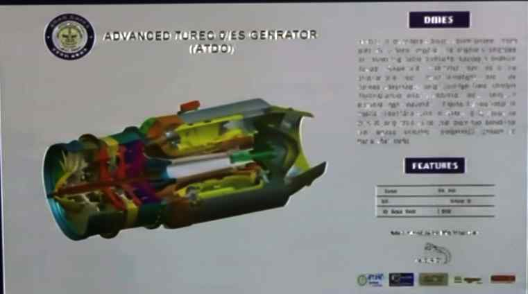

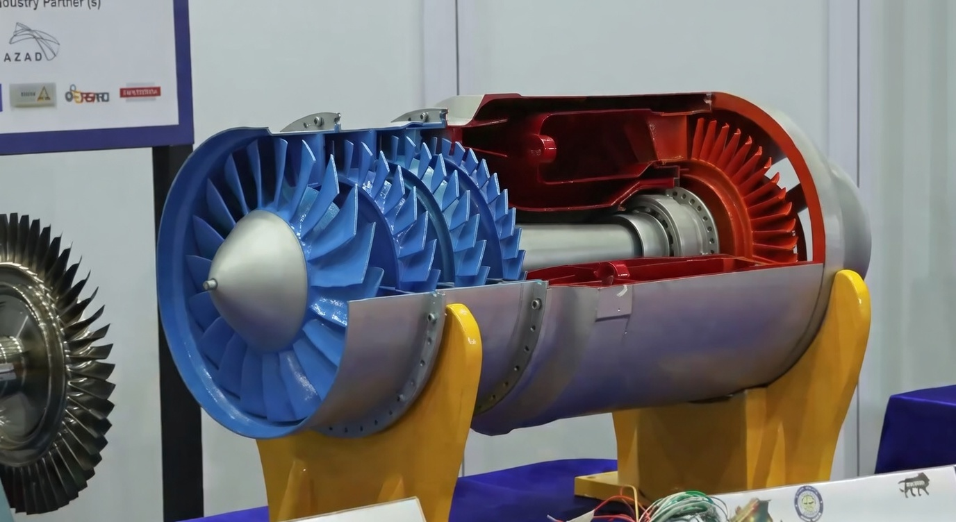

...Unlike the short 55 km-ranged NASM-SR which is entirely rocket-powered, the NASM-MR has an air-breathing turbofan (believed to be a scaled-down version of the STFE Manik developed for Nirbhay/LRLACM):

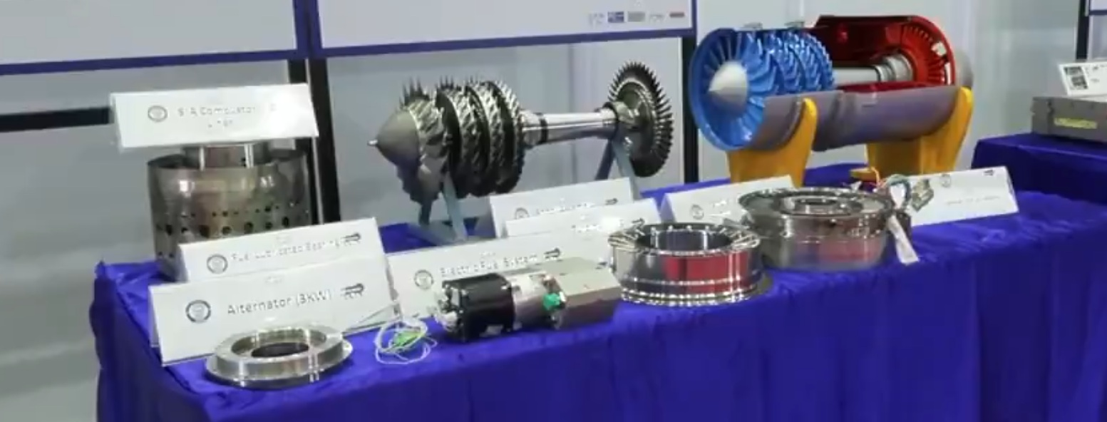

It seems the NASM-MR is actually powered by a turbojet, specifically related to/derived from the ATGG developed by GTRE:
If so, it would make sense. The Manik turbofans are more powerful, but also more expensive. Probably best reserved for 1000-1500 km range class of missiles like LRLACM, while the <300 km SSMs like NASM-MR should be fine with a turbojet.
