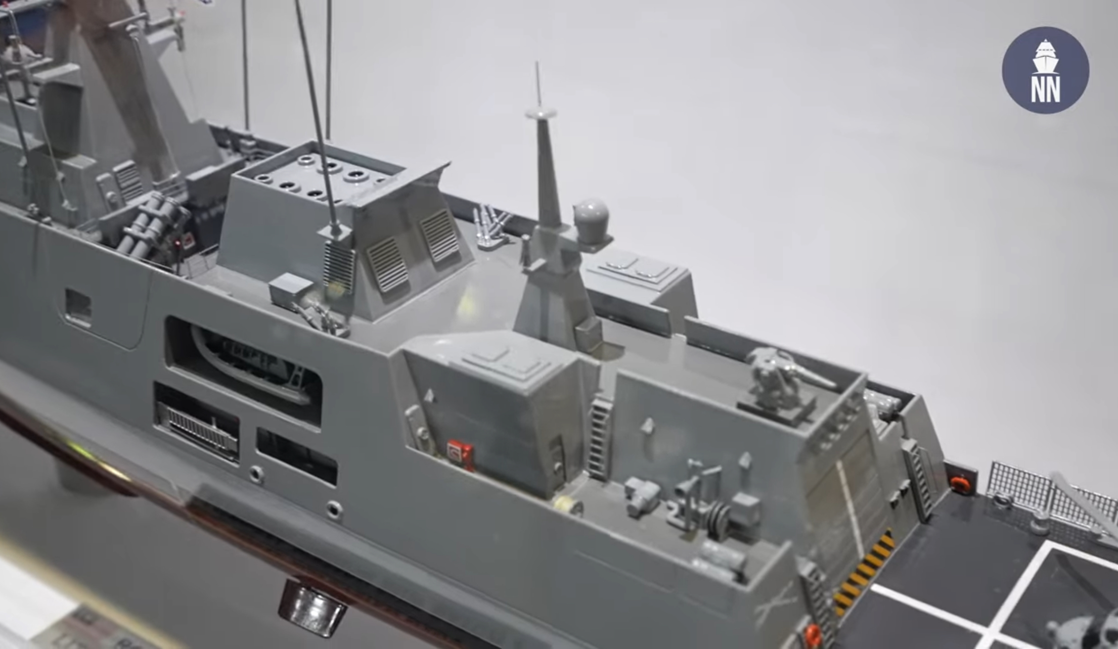

If this is a variant of MIDLAS that will allow for a peripheral installation, it is likely that the proposed missiles will also be of Turkish defense industry origin in the first place. Btw, If what is shown is a scale model of the ADA class, then this structural block containing the peripheral VLS shown is certainly too large in its internal volume to be just 2 cells, it could be the entire system for integrating a VLS as a package, for ships without VLS. I don't know, but I really like this approach and I hope it's not just a whatif study or just a proposal based on Malaysian requirements.
EDAS of Tübitak supposed to have peripheral versions that do not cut through the main deck (or what we call as strength deck) thus not causing a structural re-work (in terms of certification). Similarly KVLS or MICA-VL installation does not penetrate through this main deck but sits on it with a foundation.
Since EDAS with cold launch seems to gone, i can't think of MIDLAS without an individual launcher unit and making it available for peripheral or modular installations like Ex-LS, KVLS. Though at the moment they are working on Strike length version, i think a short individual unit representing self-defence version will be present along with Hisar-D Block II.

Imagine as if Levent or Gökdeniz SUNGUR, Bozdoğan,UMTAS,CIRIT
@Anmdt @Yasar_TR @dBSPL
The LMP Multipurpose Modular Launcher from Naval Group
Concretely, the LPM is a mobile modular system of 3 tonnes, composed of 4 containers each capable of implementing 4 Mistral 3 anti-aircraft or anti-missile missiles, 2 anti-submarine grenades, infrared decoys or 10 laser-guided rockets of 70 mm.
pyrotechnic* deflectors located at the rear of the launcher prevents combustion jets from causing damage to fragile structures such as antennas.
Our point defense systems should have this pyrotechnic deflector shits in order to put launchers on everywhere of a warship.
This rather gives me the question of redefining CIWS which would be yes. Up to this point, we mostly took CIWS as something to shoot incoming missiles with surface targets placed at secondary but with the recent developments, I guess it is about time we place more emphasis on the latter.

Kalkan Decoy launcher may be configured like this. Though project is still on system requirements identification stage but if it goes through it will be present aboard all major ships in place of fixed decoy launchers and will be capable of launching RF-emitting/reflecting and IR signature mimicking decoys.
