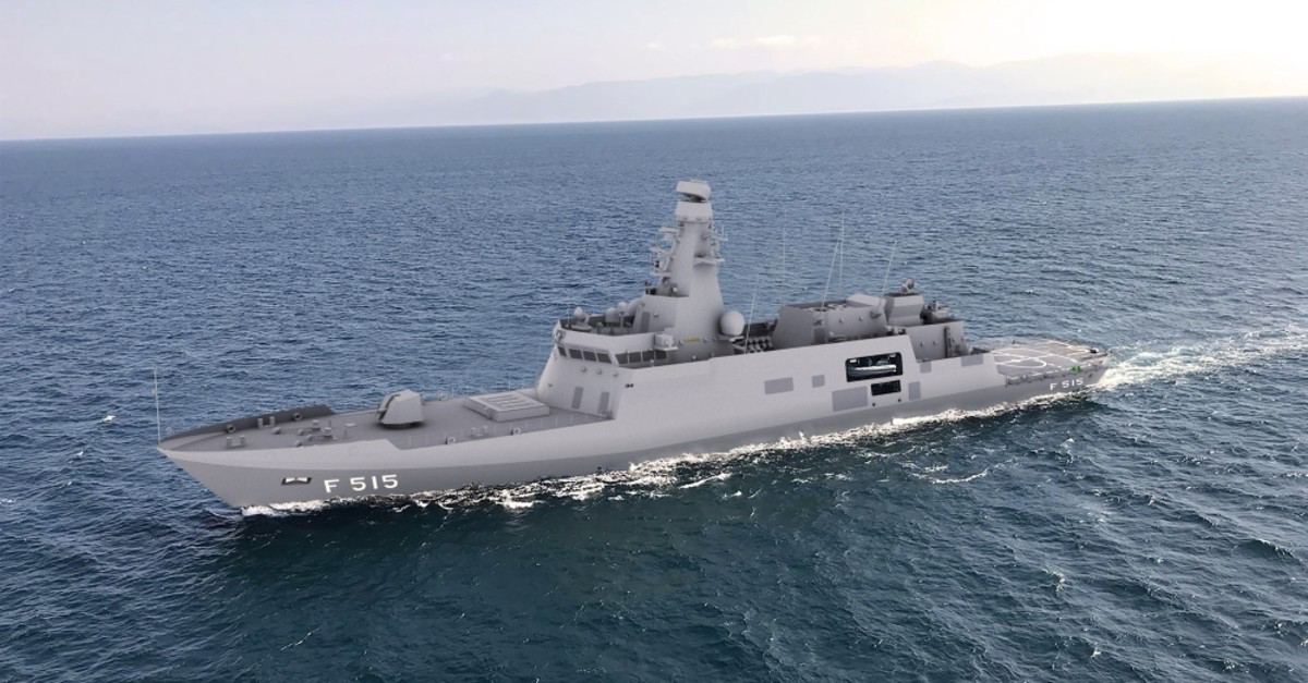

But our I-Class frigate will have just one radar not two separated. I mean Gökdeniz /CIWS will relied on it.
Turko
gökdeniz will have its own search radar, either mounted or on a separate location.
Dear I can't see second search radar here:( do you mean AKR-D ?
