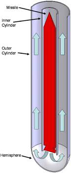

But there's no MK41 one cell. MK41 8 cell self defense variant which is lighter and shorter than others just weight 12 tonnes.
You can't fit mk41 on little naval vessels. İndeed Umkhonto VLS is very compact, light, short and ideal for 4-6 missiles.Easy to maintain. Easy to load.
Also it must be cheaper. You don't need extra canister for transport.
Canister length 3800mm
Diameter 650mm
Mk41 one cell is minumum 5700mm.

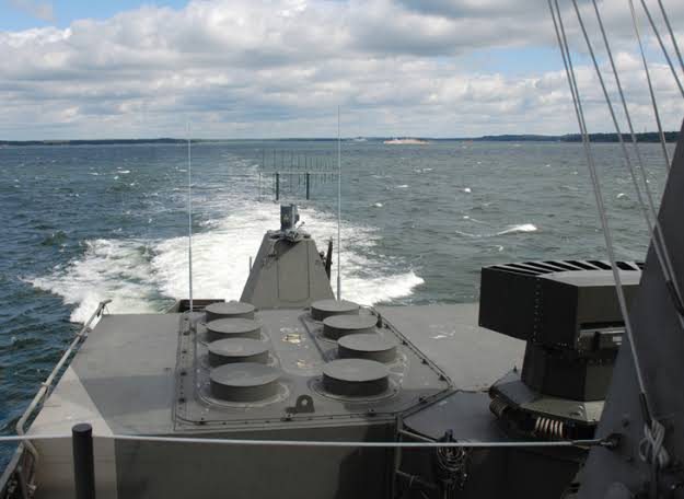

Look here are the 8 missiles , it doesn't seem to occupy more space than two cell of MK41.
Güney Afrika büyük savaş gemilerinde geniş geniş koymuş, ama Hamina Klasta gayet kompakt.

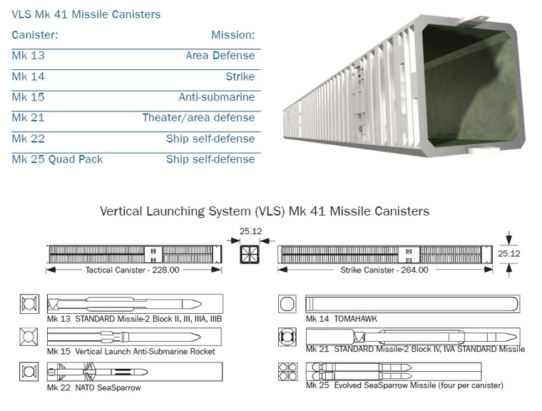

Same diameter as single MK41 cell. But you can load 4 times more missiles.
İt is not a cell, it a canister. Lockheed Martin doesn't produce one cell mk41 VLS! How could you run the quadpacked canister? You need a Launcher while Umkhonto is a single cell launcher as well as a transport canister.
There is a just single-cell mk57 which more expensive, longer, heavier than Umkhonto.

For MK41s you need additional transport canisters.

Just MK41 costs min 30-40 million USD without ESSM missiles ( also very hard to maintain)

Guys look again , what's wrong with the Hamina Class?

MİDLAS heavier than MK41
Mk41
tactical length:13.500kg
Strike length: 14.500kg
