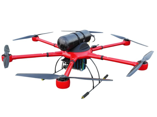

İf Houthis use hydrogen in their drones, the fuel cell technology has become totally cheap. So our future midget submarines will have fuel cell technology.
We might see hydrogen powered torpedos?
