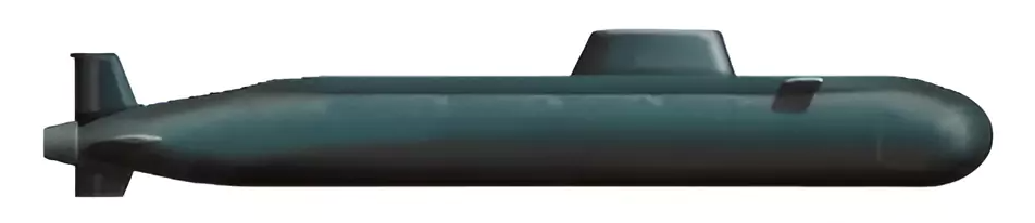

Artistic impression of the Indian SSN by H.I. Sutton of Covert Shores​
With around ~60MWe of total electrical power (assuming a 33% efficiency on a 190MWth thermal output), the P77 SSN would be well-placed to incorporate the 35MW Nuclear-Electric Propulsion (NEP) setup. This would involve a silent electric motor replacing the noisy reduction gearing used in older submarines. This is also known as Turbo-Electric Drive, known to have been in the works for the Indian Navy. Assuming this setup is indeed intended for the SSN project, it can be a reason as to why a significantly higher degree of redesign may have been necessary for the CLWR-B2's power delivery system - especially the secondary loop setup - as the OK-650B was not originally meant to work with NEP.​
For comparison, the French Navy's Barracuda/Suffren-class SSN uses a 20MW NEP setup fed by a 150MWth LEU reactor to drive its pumpjet propulsor. Notably, the setup on Barracuda-class is only designed to use the nuclear-electric solution up to a certain speed (let's say 20-25 knots) for relatively silent transit. Beyond 25 knots the submarine has to rely on its backup conventional propulsion that is understandably more noisy - in order to attain higher speeds (up to a maximum of 30 knots I would assume).

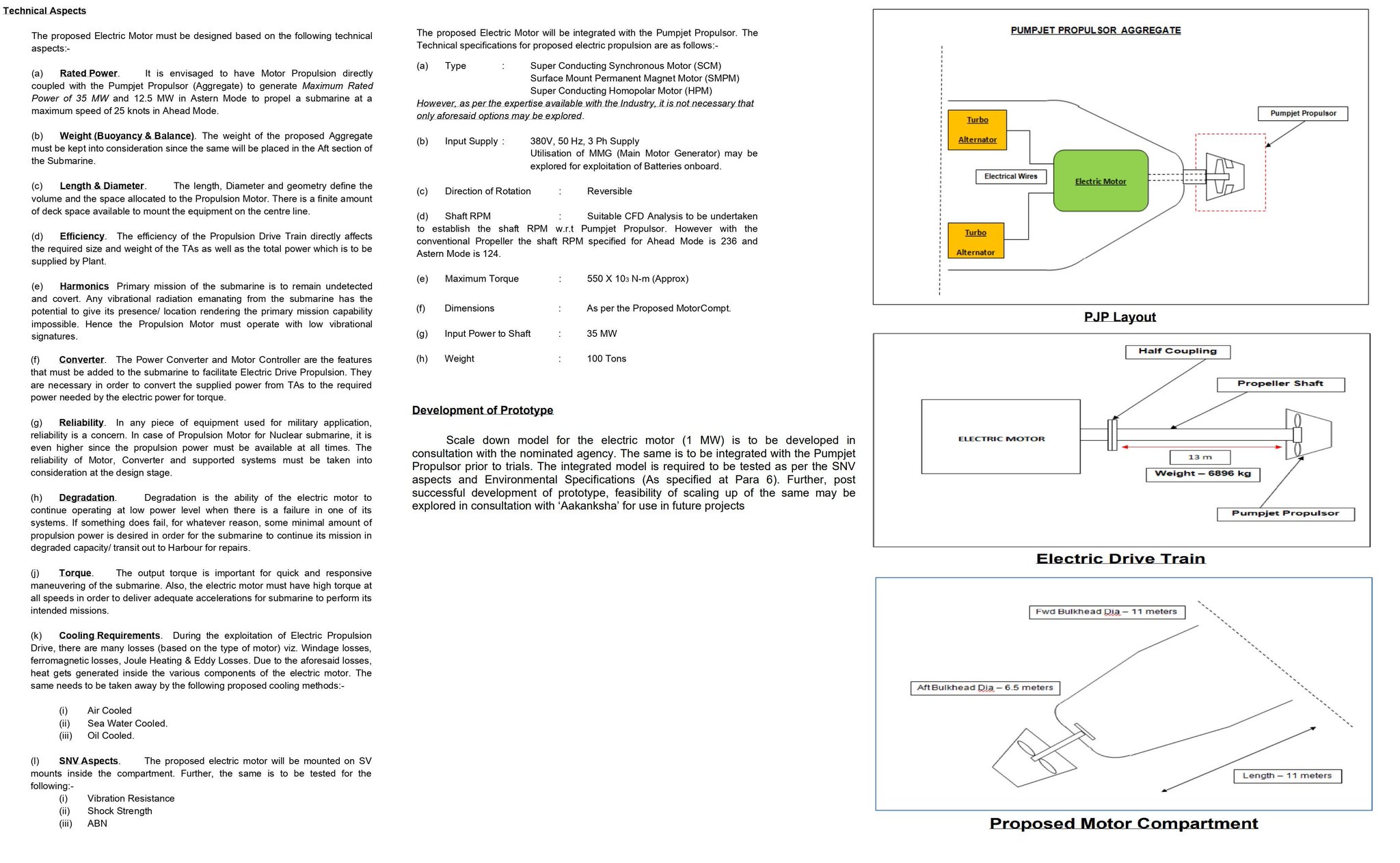

The Expression of Interest (EoI) documentation above also calls for the Indian NEP setup to drive the submarine to a maximum speed of 25 knots. It's likely that the P77 would also have to fall back on a conventional setup to go faster (again, let's say it can do a maximum of 30 knots or more). Either way, even without the NEP, this reactor should put the P77 in a very good place in terms of speed and performance when going up against any given opponent SSN, such as the new Type-093B of the Chinese PLA Navy. Actually, the P77 is very likely to enjoy an advantage in those regards against the Chinese boats - barring any considerable improvement the PLAN manages to make in the decade-plus it would take for the P77 to arrive.
Also worthy of note is the fact that, at least according to the the EoI document above, the nuclear-electric setup being pursued by the Indian Navy clearly calls for the P77's NEP to drive a pumpjet propulsor. Is that enough reason to assume the P77 will have a pumpjet? We'll see.
This same reactor and NEP propulsion setup are also likely to drive India's upcoming "S5" class of next-gen SSBNs. The S5s will be much larger than the 6,000-7,000 tons (surfaced) Arihant & Arihant Stretch. The S5 is believed to displace between 13,000-14,000 tons surfaced, with 12 or more vertical launch silos. The S5s will perform a very different mission (deterrence). Hence their reactors will have to cater for different SSBN power delivery needs (smooth and gradual acceleration) compared to the rapid stop-starts of SSN operations.

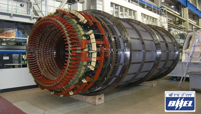

Example of a turbo-electric generator manufactured by India's state-owned BHEL corporation for commercial applications. BHEL is very likely to be the contractor responsible for building any NEP solution for future submarines.​

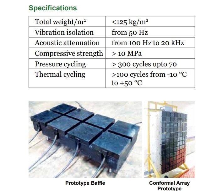

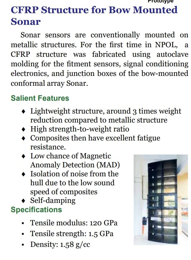

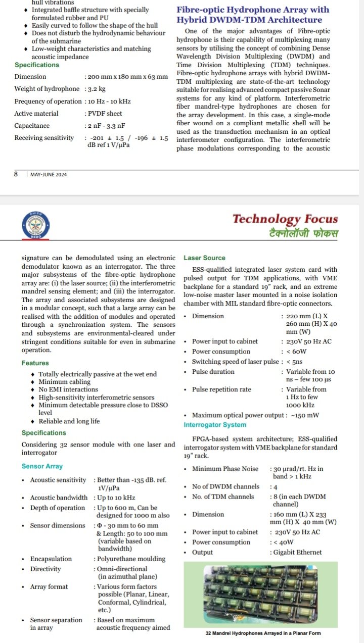

Based on reports from official DRDO publications (pictured below) it's evident that R&D work on both conformal bow-array sonars as well as planar-arrays (ostensibly used for flank-array setups) is/has been ongoing in India for several years. It's difficult to say which R&D program might or might not find a real-world application on upcoming submarine programs. I think it can be safely said that there's at least a determination in the Indian Navy to advance past the older cylindrical-array sonar setup used in the bow of the current generation of Indian nuclear boats. Among SSNs that are currently being built, the British Astute-class comes to mind as one that has a conformal bow array.
Screen-grabs from the DRDO's official 'Technology Focus' publication, detailing some R&D work on next-generation sonar solutions.​
While there's no official word on this, I would estimate using a 190MWth reactor, there would be enough power on tap for the P77 SSN to incorporate additional mission sets beyond pure hunter-killer duties. This could include carrying a pack of vertically-launched Land-Attack Cruise Missiles (LACMs) like the Nirbhay. It remains to be seen what the configuration of the P77 SSN class will be. I would estimate its surfaced displacement to be somewhere between 5,000 and 7,000 tonnes. P77s will likely be larger than the 5,300 ton French Barracuda/Suffren-class but possibly smaller than the Royal Navy's 7,400 ton Astute-class and the US Navy's 7,900 ton Virginia-class (Blocks I-IV).

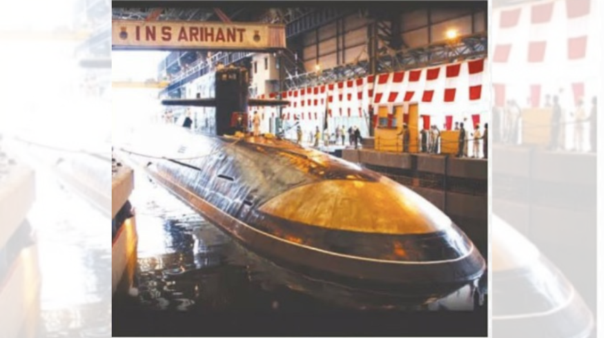

It's worth noting that even going by what's known so far, every single Arihant-class boat appears to be significantly different from the last owing to continuous technology insertion i.e. improved reactor and hull extension. It is also possible the upcoming S4* might turn out having a pumpjet. This is if a decision were taken to de-risk the P77's and S5's next-gen propulsion setup by testing the pumpjet on S4* instead of putting both of the untested technologies (NEP & Pumpjet) on the SSN & S5 SSBN directly.
It's also possible that the eventual requirement will be extended beyond the six P77s currently sought, to twelve. As six might be too few to fulfill the wide frontage of offensive & defensive needs of the Indian Navy. This is keeping in mind the construction of a new large, higher capacity, dry-dock at SBC (image below). It is very likely that at some point within the end of the 2020s, the Indian Navy could have both the new SSNs and S5-class SSBNs under construction at the same time, They might also be delivered simultaneously over a period of time in the 2030s. Unfortunately, being a strategic program (for carrying nuclear weapons) the funding modes for the S5-class boats will be secret. None of the public reporting such as cabinet approvals or funding details applied to the P77s will likely apply to the S5s.

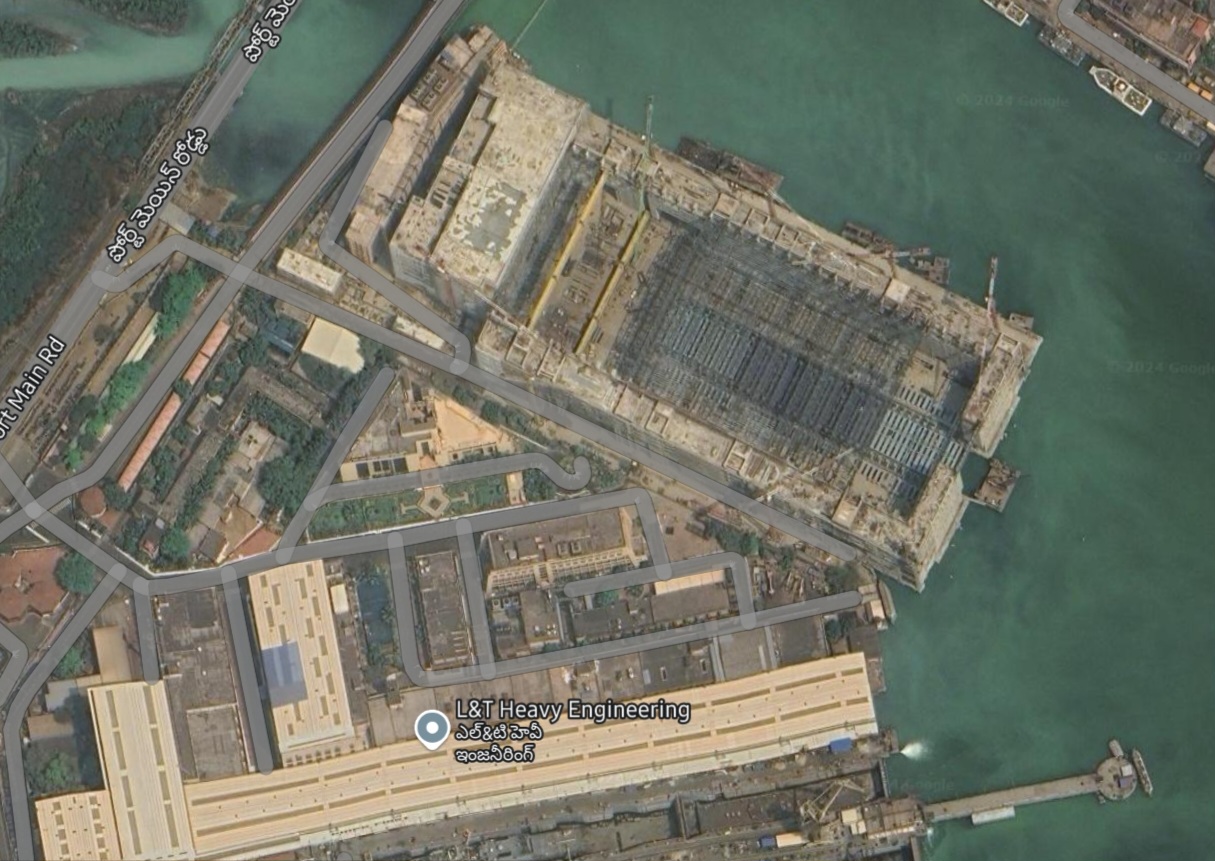

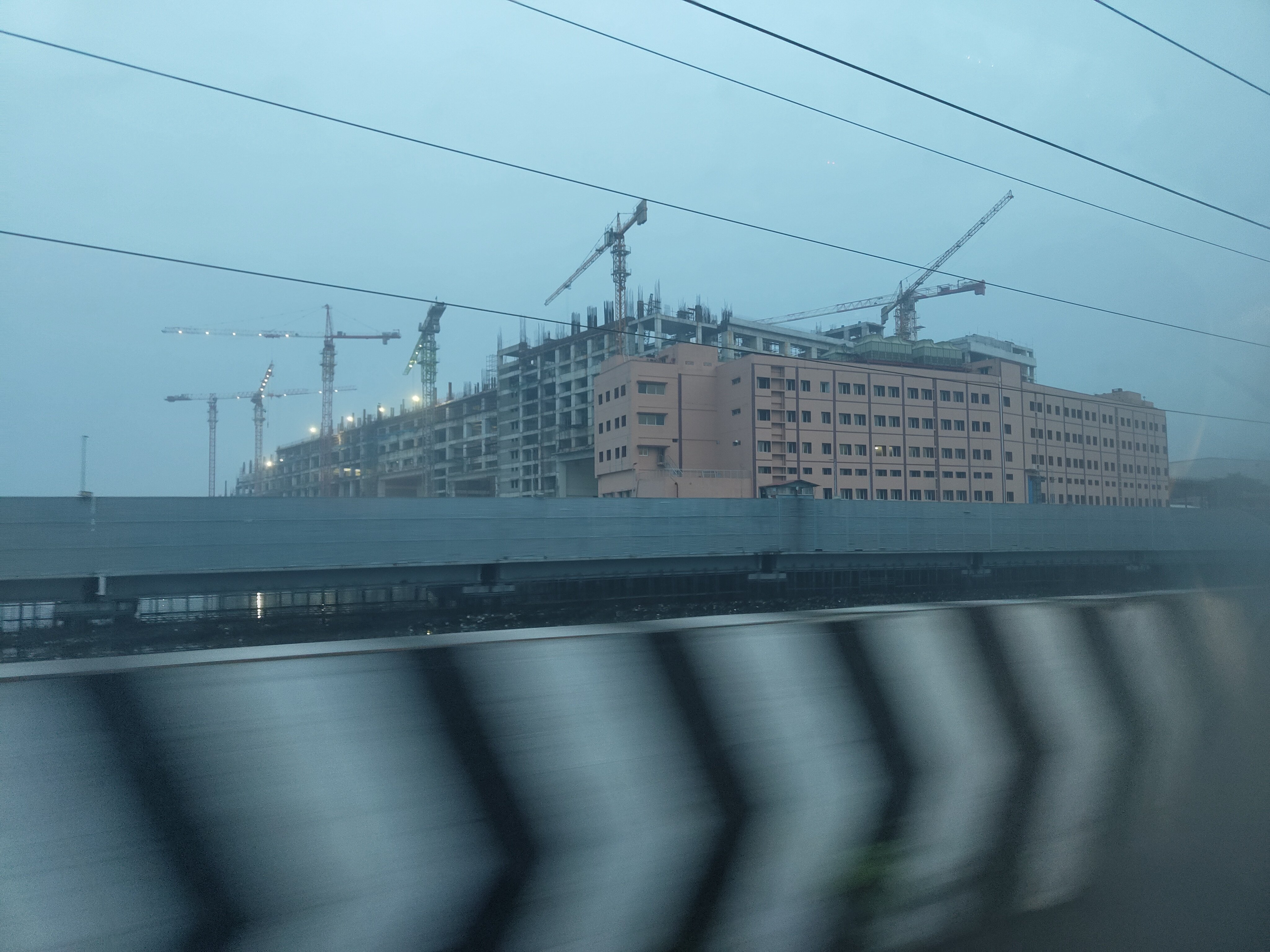

The new, larger dock (northern one) and the older, smaller dock that built Arihant and its Stretch versions (southern one, with the "L&T Heavy Engineering" pin on top)

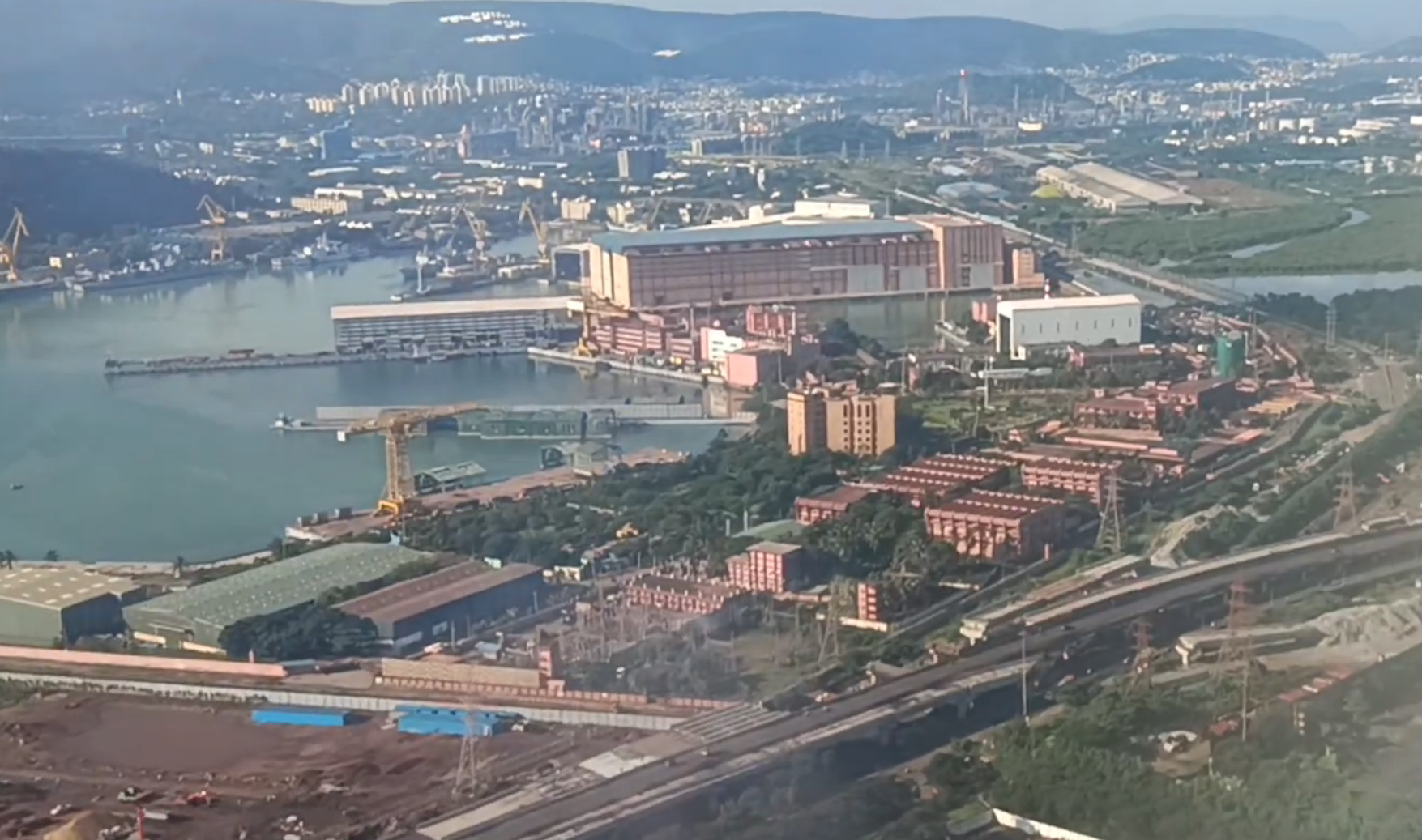

The 'administration' building coming up behind the new dry dock, as seen from the motorway by civilians

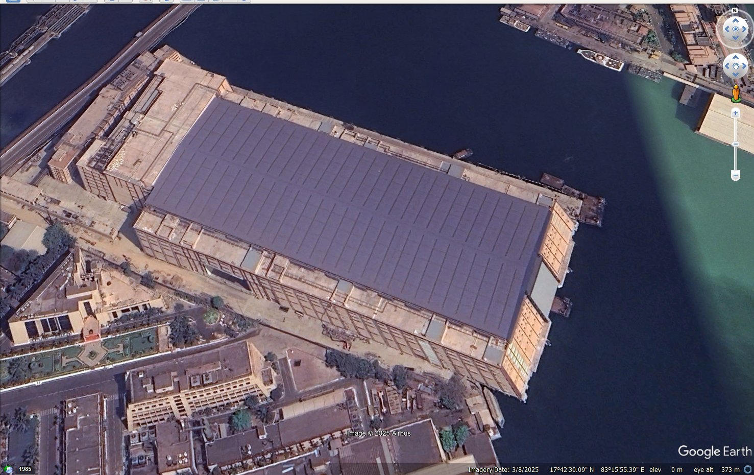

That means the S5 class will indeed be built in the existing dry dock at SBC Vizag (the same one that built the Arihant-class boats), whereas the new larger dry dock that's coming up beside it (pictured in post above) will exclusively cater to the Project-77 SSN program.
While I estimate the new dry dock to be capable of comfortably accommodating up to at least 3 hulls side by side under various stages of outfitting at the same time, the Navy has only ordered 2 SSNs in the first tranche. So I don't expect the new dock's capacity to be fully utilized from the get-go.
