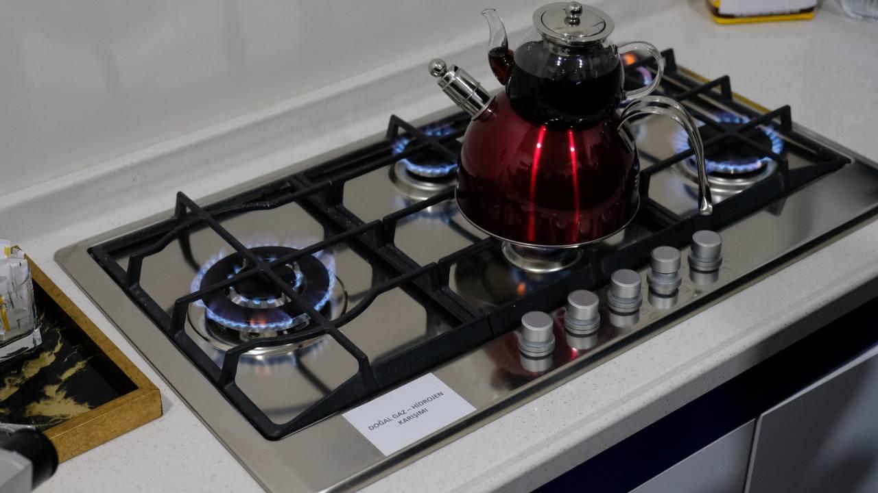

They want to produce Hydrogen from coal and renewables and mix in NG. Also use H for railroad locomotion.
