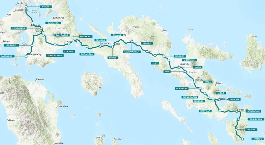

The Philippine Railways Institute’s map of the Bicol Scheme (Public Domain)
The Philippines’ Department of Transportation (DOTr) has awarded a $2.8bn contract to a Chinese consortium to build the first phase of the 565km Bicol rail scheme on the country’s main island of Luzon.​
Philippine National Railways (PNR) is planning to build the link between Metro Manila and the southeastern tip of Luzon, with the first phase to start in the first quarter of this year.
In a statement issued on 18 January, the department said a team consisting of China Railway Group, China Railway No 3 Engineering Group and China Railway Engineering Consulting Group would design and build the 380km stretch through the centres of Banlic, Calamba and Daraga.
According to the department, the first phase will cover four provinces and 39 cities and municipalities. This will include the construction of 23 stations, 230 bridges, 10 passenger tunnels and a 70ha depot at San Pablo in Laguna Province.
