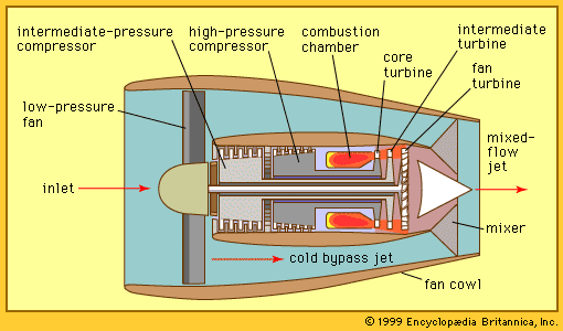

Y
I like the explanation of how much air goes around the engine. But does that mean a lot more air goes around the engine that doesn't get used for thrust ?
My amateurish understanding tells me, the more air we can get to go into and through the engine the more thrust we would get.
So any air not going into the engine is wasted.

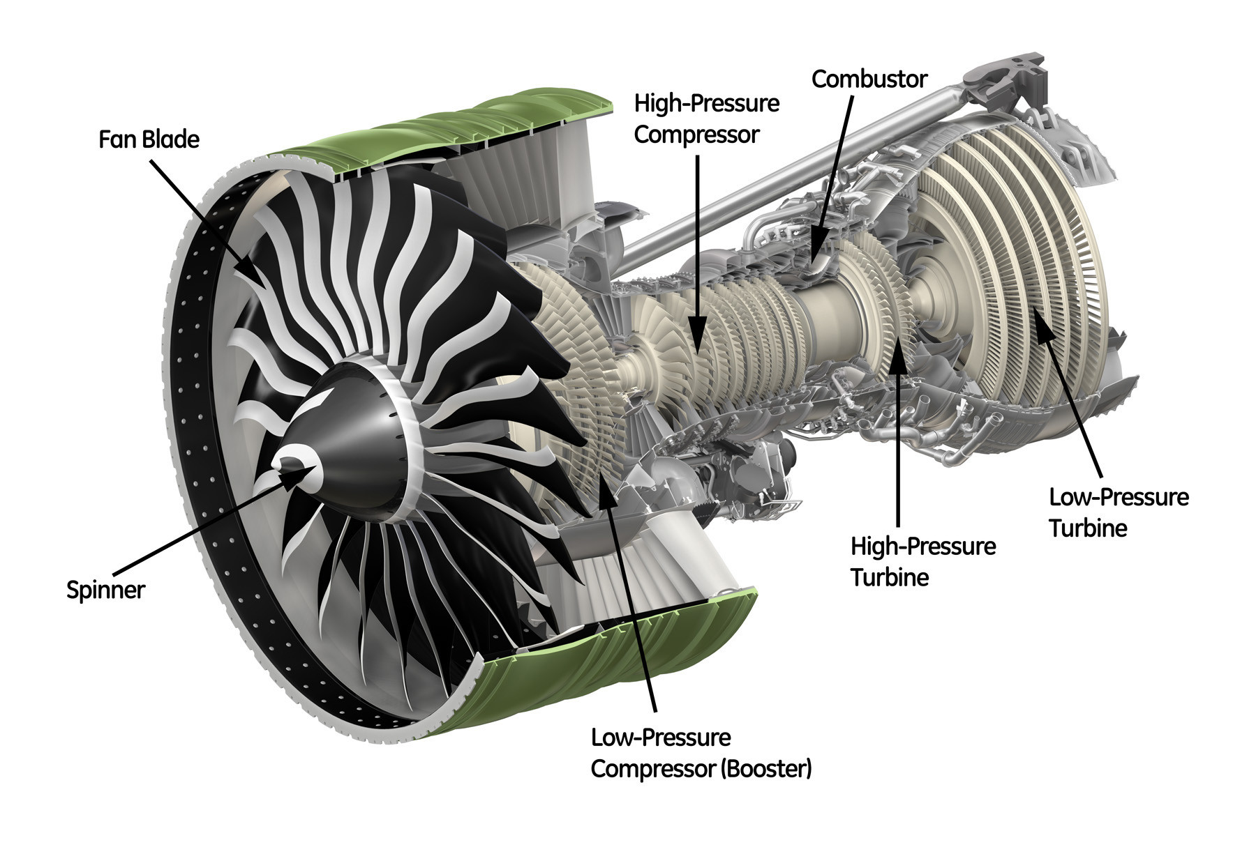

I am afraid it doesn’t work as you think.
For turbofan engines :
Bypassed air contribute to the thrust as well.
The cold air going round the core of engine and thrown out of the nozzle together with the hot air coming from the core BOTH contribute to total thrust. As Dr Akşit mentioned, 40% of TF6000’s thrust is provided by this colder air.

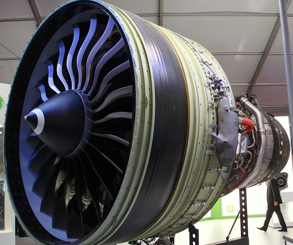

In commercial airliner engines the bypass ratio is much higher. Say an engine like GE90 with a bypass ratio of 9:1 means: for very 1kg of air passing through the core, 9kg of air goes round the engine and thrown out together with the hot air coming from the core. So in commercial turbofans you have a huge fan driven by the core. that acts like a propeller sucking air in to engine but most of it being thrown out round the core. 80 to 90% of all thrust in a GE90 is provided by bypassed air.
NOTHING IS WASTED
Check out Boeing 777 engine GE90
EDIT :
This means Turbofans love working where there is dense air. Then it can suck in and throw out air much more efficiently. Where air is rare, like in very high altitudes, it would be labouring. That is where turbojets come in to play. The very high altitudes are the domain of turbojets. With turbojets there is no bypassed air. It is all hot air being ejected from the nozzle.
