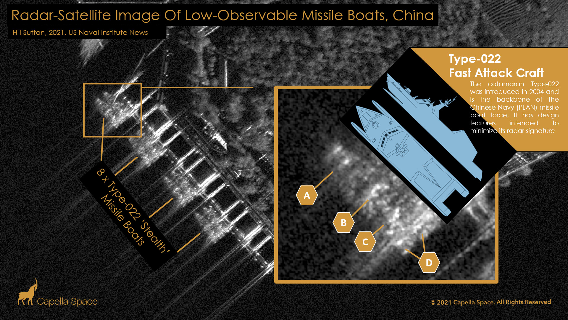

I don't know about very long radar but current military radar, some have SAR (Synthetic Aperture Radar) ability and able to generate images.
For example F-16 SABR radar able to do ground mapping and even object/target detection and identification.
Maybe if the radar is good enough and at sufficient distance the resulting SAR image produced will be enough to scrutinize the target plane, like what stuff is being carried by the target. Etc.
Maybe it can be improved further by also incorporating AI.

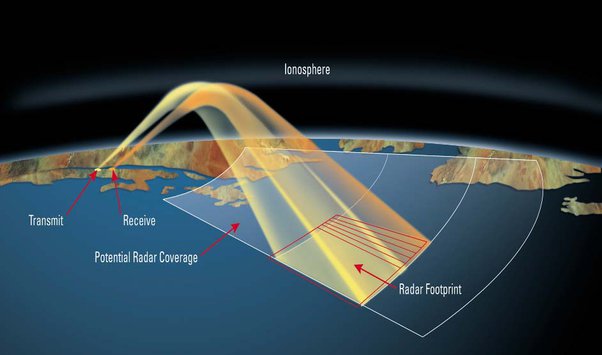

Long range means less resolution.
Long range radars are not used today for a reason.
BHAN85
Member
13
14
Spain
Spain
That can technically work but radar resolution with an HF frequency radar will be so low that unless its an ICBM I doubt it can differentiate the target.
Besides ionosphere is unstable.
e.g: You can start a WWIII nuclear war when a solar storm modify ionosphere and the enemy wont see you.
