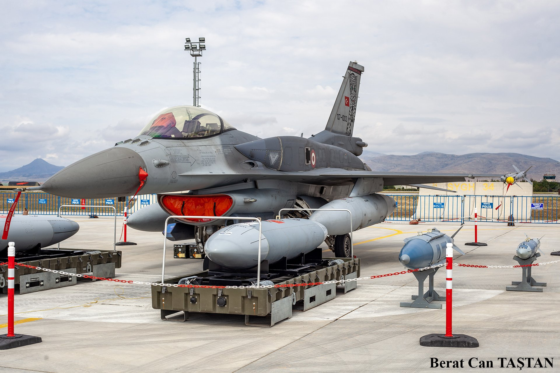

Tubitak bilgem F-16 ED pod.I have been skeptical about this pod because normally this kind of pods would be at two wings to secure pinpoint accuracy detection.This picture show us there is at least 4 may be 6 antennas to secure the problem in one pod.If roketsan make akbaba missile,we will have our wild weasel F-16.As far as I understand multiple antennas covers more than 180 degree.

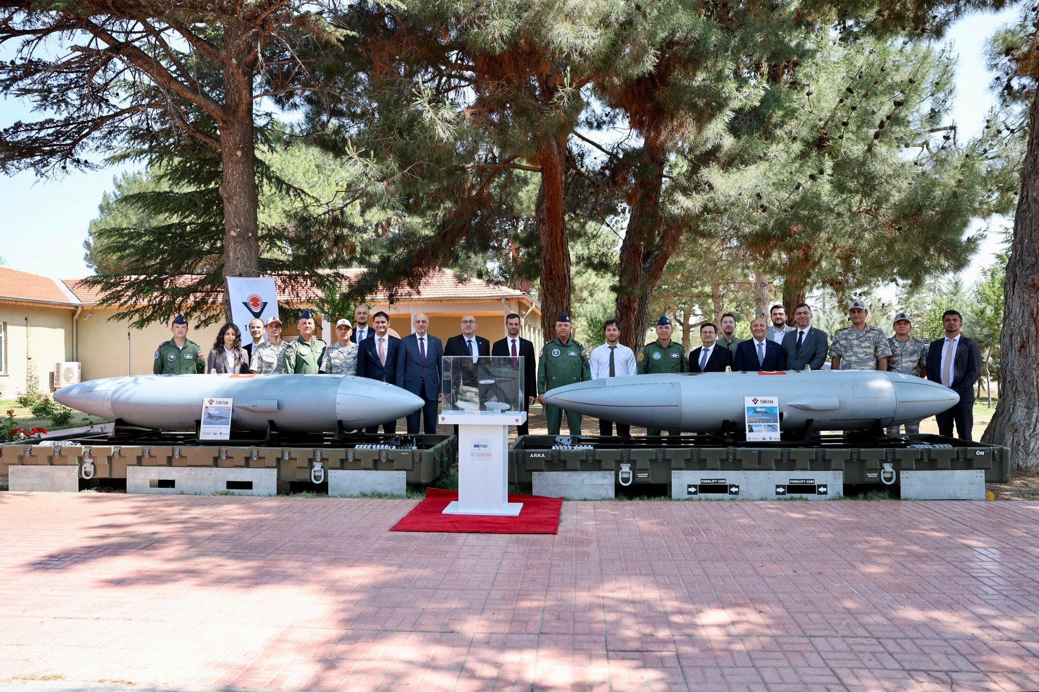

Tubitak bilgem F-16 ED pod.I have been skeptical about this pod because normally this kind of pods would be at two wings to secure pinpoint accuracy detection.This picture show us there is at least 4 may be 6 antennas to secure the problem in one pod.If roketsan make akbaba missile,we will have our wild weasel F-16.As far as I understand multiple antennas covers more than 180 degree. View attachment 79278
Will there still be a need for this EHpod once the Murad AESA-type aircraft radar comes into use?
I was against an EHpod without an AESA antenna system from the beginning. Because there is a huge difference in capabilities between old-type sensors and jammers and EW systems with AESA antenna systems.
We understood this difference in the Koral system. The simplest difference is called RF bandwidth.
How effective will the EHpod system be against AESA-type aircraft, ground and missile radars?
