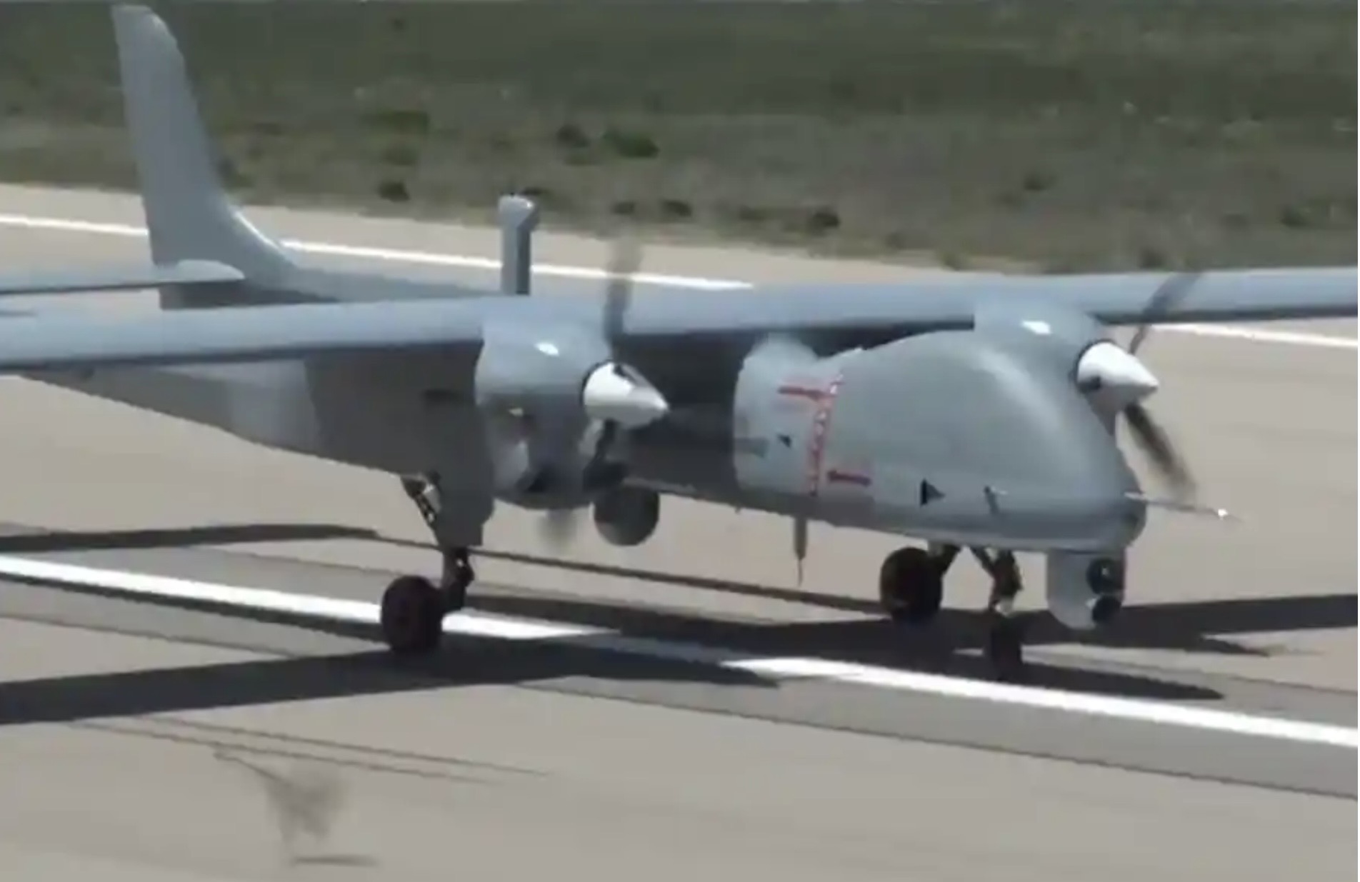

This is like a revolutionary upgrade to the MILSAR we knew that had an under 30km range.
This new version developed for Maritime use, specifically for Aksungur, will give an effective range of 90 Nm(166km). Aksungur can accommodate a tandem use version. It can also be used to give mid course correction to surface launched antiship missiles (land or ship launched).
The primary advantages include:
  • Dual Capability in One Unit: The system combines high-resolution imaging (SAR) for stationary targets and tracking of moving targets (MTI) into a single, versatile package.
  • Adverse Weather Operation: Because it is a radar system, MILSAR can operate "over-the-cloud," providing ISR (Intelligence, Surveillance, and Reconnaissance) capabilities in low-visibility, day-or-night conditions where Electro-Optical (EO) sensors fail.
  • "Slew-to-Cue" Functionality: On larger platforms, the SAR and MTI can work together, allowing the radar to immediately shift focus to a moving target identified by the MTI mode, increasing efficiency.
  • Operational Flexibility: MILSAR offers both Stripmap mode for wide-area surveillance and Spotlight mode for high-resolution imaging and classification of specific targets.
  • Low Size, Weight, and Power : With a weight of less than 30kg, it is designed for easy integration onto tactical UAVs (e.g., Bayraktar TB2, ANKA) as well as larger platforms (e.g., Aksungur).
  • Immediate Target Data: The system provides real-time data on target location, speed, and direction, which can be displayed on geo-referenced, digital maps for operators.
Because of it’s geometry it can be used in Tandem form from Aksungur;
Having a tandem MILSAR (Miniature SAR/MTI Radar) system, which integrates both Synthetic Aperture Radar (SAR) and Moving Target Indication (MTI) capabilities, provides several tactical advantages for unmanned aerial vehicles as pointed out above.
Dimensions (D x H)37 x 44.5 cm
Weight28 kg
Power20-30V, 600W average
Max Altitude22000 ft
MTIMax range up to 90 nm depending on target
Max no of targets: 1000
track capacity: 200
SARMax range: 15 nm
Image resolution: 3 x 3m, 1 x 1m, 60 x 60 cm, 30 x 30 cm

Our TB2 are using the old radar, so basicly TB2 can be upgraded. What they should do is with this radar installing Cakir on Aksungur.

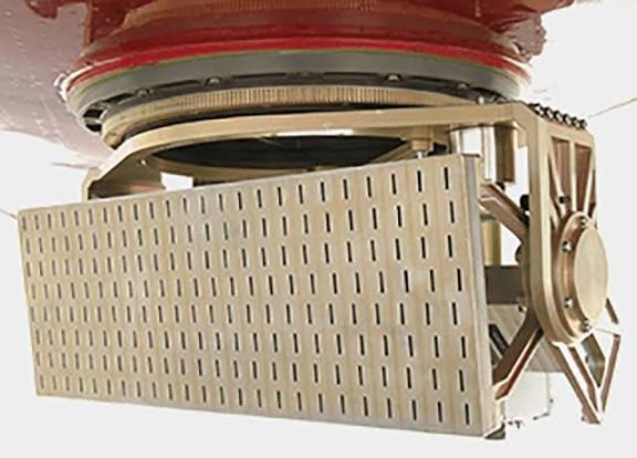

Could the increase in Milsar radar's capabilities be due to its upgrade from a PESA radar to an AESA radar?
MİLSAR is not explicitly described as a PESA (Passive Electronically Scanned Array) radar.
Instead, it is defined as a Ku-band Synthetic Aperture Radar (SAR) and Moving Target Indication (MTI) radar.
MILSAR is also not an Aesa Radar. Although Aesa radars have SAR capability to increase their operational range and ground image clarity especially above clouds, they are different.
Meteksan has a Retinar Aesa Radar to perform as an Aesa Radar.
  • MILSAR: A SAR/MTI radar designed for imaging and target detection, optimized for UAVs.
  • Retinar AESA: A separate radar system specifically branded and developed by Meteksan as an AESA radar for drone detection and surveillance.
Key Differences:
  • Definition: AESA is a radar antenna type (hardware); SAR is a signal processing technique (mode).
  • Function: AESA acts as a versatile sensor (air-to-air, mapping); SAR specifically creates photographic-like maps of the ground.
  • Movement: AESA can function while stationary or moving; SAR requires movement to build its "synthetic" image.
  • AESA Advantage: High-speed scanning, multi-mode functionality (simultaneously tracks air and maps ground), and low interception risk.
  • SAR Advantage: Provides very high-resolution, all-weather imaging, often superior to optical sensors in cloud cover.
While MILSAR uses modern radar technologies for detection, Meteksan's specific AESA technology is marketed under their Retinar AESA product family.
Increase in range is the result of product development and technology upgrade. Also you need to note that it is not the SAR capability range that is improved. It is the MTI (target indicator) range that is extended to 90nautical miles.

Actually, looking at the antenna of Aselsan's SAR radar here, I think the SAR radar is a type of PESA radar. That is to say, it's a PESA radar that also uses Doppler signal processing techniques.
Of course, it's a radar that can obtain images by processing variables such as speed, distance, and time. The single signal source and multiple array receivers technique is the PESA operating structure.
For example, the Doppler radars of RF-4E aircraft can obtain SAR images. Similarly, the Israeli EL-M 2032 F-4E PESA radar is also SAR + GMTI capable. So, Meteksan's radar is fundamentally a PESA radar.
View attachment 79520 For example, the Doppler radars of RF-4E aircraft can obtain SAR images. Similarly, the Israeli EL-M 2032 F-4E PESA radar is also SAR + GMTI capable. So, Meteksan's radar is fundamentally a PESA radar.
