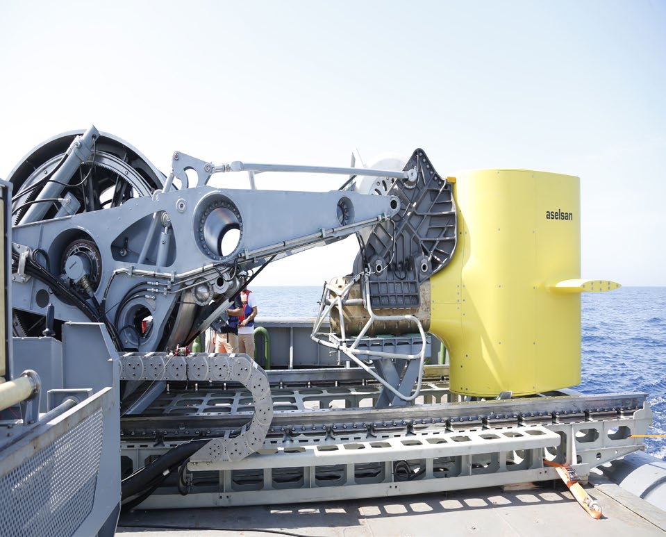

We have an Aselsan built towed array sonar called DUFAS too. But there are advantages and disadvantages as stated in below Infograph.
Summary Comparison
FeatureTowed SonarHull-Mounted Sonar
Primary UseDeep water, long-range ASW, detailed surveysShallow water, navigation, basic fish finding, obstacle avoidance
Image QualityHigh, due to reduced ship noise interferenceLower than towed (in deep water), affected by ship noise
Operating DepthExcellent (can reach specific depths to counter thermal layers)Limited effective range/depth
Ease of UseComplex; requires training and coordinated operationSimple; "set and forget" operation
Vessel SpeedLimited while deployedNo speed limitations
CostMore expensiveRelatively inexpensive
Although our DUFAS may or may not be as sensitive as the CAPTAS-4 used on FREMM frigates, it is still quite a capable system classified as long range low frequency towed array.
One special capability made public about DÜFAS is its ability to suggest appropriate countermeasure tactics and ship evasion manoeuvres automatically when a torpedo threat is detected. Most details are otherwise classified.
DUFAS was intended for the I-Class ships. But we don’t know if they are fitted.
Summary Comparison
Both Aselsan and Meteksan produces hull mounted sonars, as far as i know both using transducers / hydrophones made by TUBITAK. And both have been favorably performing well. Aselsan has the upper hand for supplying most of the sensors, to manage budget and integration. Meteksan on the other hand been prefferred for more niche requirements.
They also have renamed Hızır Torpedoe Countermeasure System as DUFAS, since the towed array makes a part of the whole DUFAS system. The current complete size of the DUFAS integrated separately with its own winch, yet I-Class has no sufficient space for this. Altogether, they may install DUFAS-CU, the compact version.
Hull mounted sonar also is not operable beyond a certain speed, due to the noises. Practically there is no limit, but technically it is limited.
Hull mounted sonar is operated by one console, Towed array + VDS has several consoles.
Let me correct myself; It was DUFAS which was called HIZIR-DUFAS at first, now each renamed in its own product family as HIZIR-100, DUFAS-100
Having a lot of acoustic sensors in the sea and networking them is more important than the capability of a single sensor. DUFAS or our hull mounted sonars might not be the best in the world, but deploying a lot of them together with a lot sonobuoy and networking them will net better results than using arguably better several CAPTAS-4. Listening to a lot of layers, listening with a lot of sensors, collecting and processing big data wins the underwater game.
Thats what Aselsan call it multistatic sonar system.Bythe way there are two companies for sonar systems,at first meteksan was chosen but later armelsan-aselsan get supported,thats not good for for a niche sector.Some products are overlapped such as yakamos/fersah systems.Meteksan yakamoz 2020 will be used on ada class 4 system,babür class 4 system,cinnah class 6 system,for ukrayna milgem 2 system (+2) ,romania 1,hisar class 10 system,almost 30 system is cleared.Armelsan fersah system,barbaros YÖM 4 system,İstif class 8 system,TF-2000 4 system,total 16 system,but tendency for armelsan will continue on surface and submarine ships,for example Preveze YÖM started with meteksan but later they transformed to armelsan/aselsan.Armelsan/Aselsan also made Düfas system which is very important for sub hunting,and also makes a mine detection,dipping sonar for helos,and also for submarine sonar systems.Meteksan now on struggle to live with,but they announced yesterday for the modernization of submarine sonar system for a unknown foreign country,thats a life kiss for them.If meteksan success making synthetic aperture sonar system,they will get an opportunity in civil sector.Another window for Meteksan is they are making sonar for akya heavy torpedos. Overall we have two firms on niche sector,I hope they both survive on long term.
