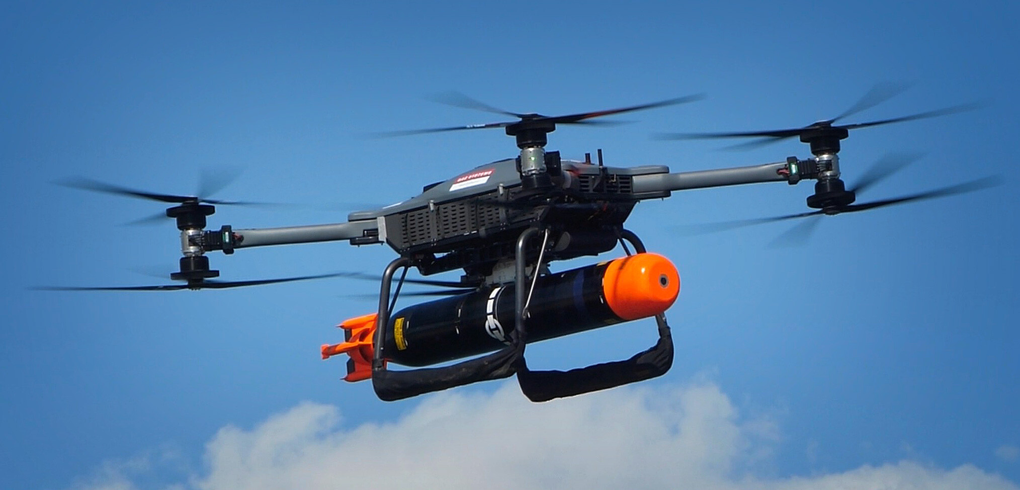

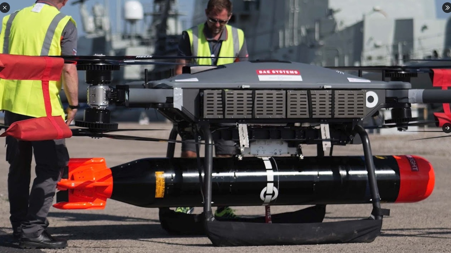

I also want to add that above Drone will have dipping sonar too with the light torpedo.
It speed is faster than helicopter
Ship will have many of them on board. ( Corvet ship will have 6 - 10 of them on board. It mean 6-10 helicopter job in ship o_O)
boredaf
1,685
26 4,764
You're mixing stuff up mate, or you have a source that isn't available anywhere. Not only I haven't seen a single mention of a sonar anywhere about this one, this drone was more of a tech demonstrator for this drone BAE actually plan to make:
And its top speed is 140 km, certainly not faster than a helicopter.

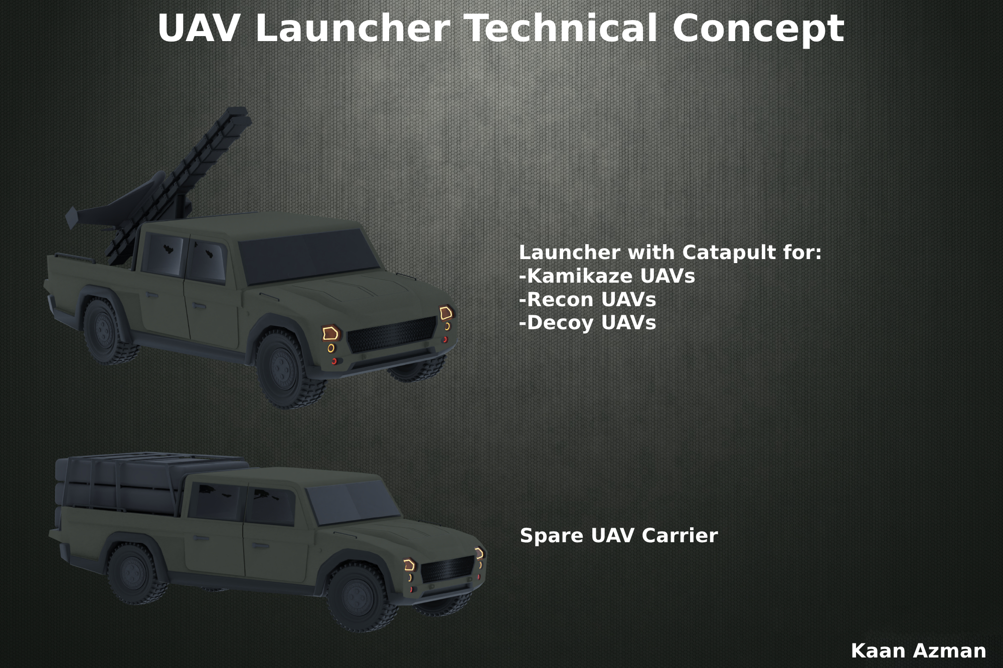

Feeling like we should embark on pickup-based solutions as well for potential customers with low budget.
I used AZAB T150 as a representative kamikaze UAV but assume it can be anything else.
Plus, BAYKAR launched KEMANKEŞ V2 from that type of vehicle so this tells me something.
We have a suitable platform and multiple options at this point. Nothing should be holding us back from doing it.
Lead Moderator
114 19,728
I agree 100%. The mobility and versatility of a 4x4 off road vehicle will provide a big plus to the user. Mobile, easy to service, easy to camouflage, big range etc. A very good solution in my opinion.
