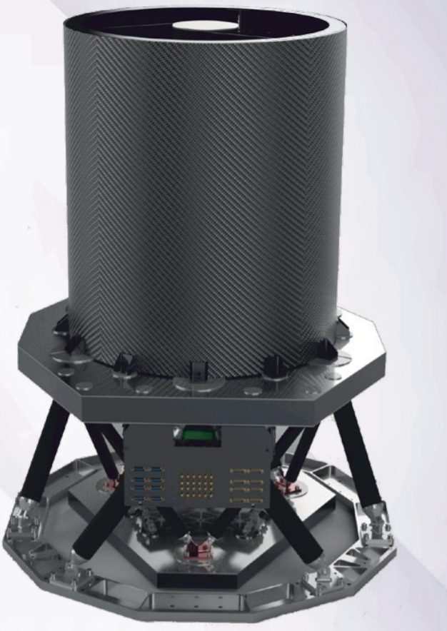

One of the most impressive CMOS satellite camera program (0,3m) is under the development phase. It will be integrated on YÇU satellite program that will be launched into space around 2023-24.
