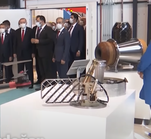

Composite propellant tank or housing for solid-propellant
Grid fins, course correction while in atmosphere or possible development of a rocket stages to return back for re-use.

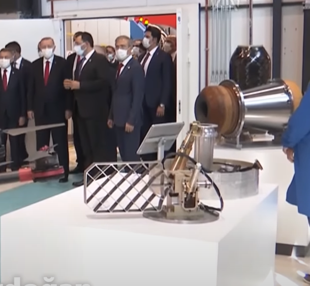

Roketsan MUFA SLV program;
  • First and Second stage will have solid propellant thruster with 1,35m diameter composite tanks equipped with swiveling nozzle. The tanks and nozzle is under the production phase in Roketsan at present.
  • Third stage of MUFA will be the liquid-propellant thruster. The rocket engine program that is using liquid propellant is being called as "Umit". In openning ceremony in Roketsan, A smaller liqued propellant rocket engine were spoted at the second stage of new TP series sounding rocket and I believe, The advanced variant of this liqued engine will be used as third stage for MUFA.
These technologies and the materials introduced on ceremony are actually enlightening the level of Turkish rocket/missile industry. From a simple perspective, Producing a SLV technology is more difficult than producing a ballistic missile. The nations who mastered on SLV technologies can easily develop a Medium to Long range ballistic missiles but Not all nations who is able to produce ballistic missiles can easily develop a SLV. MUFA tech is more or less a Chinese Medium range ballistic missile. The people who wonder the level of Turkish industry in this field should take a look at these technologies to realize where Turkey has been climbing at present.

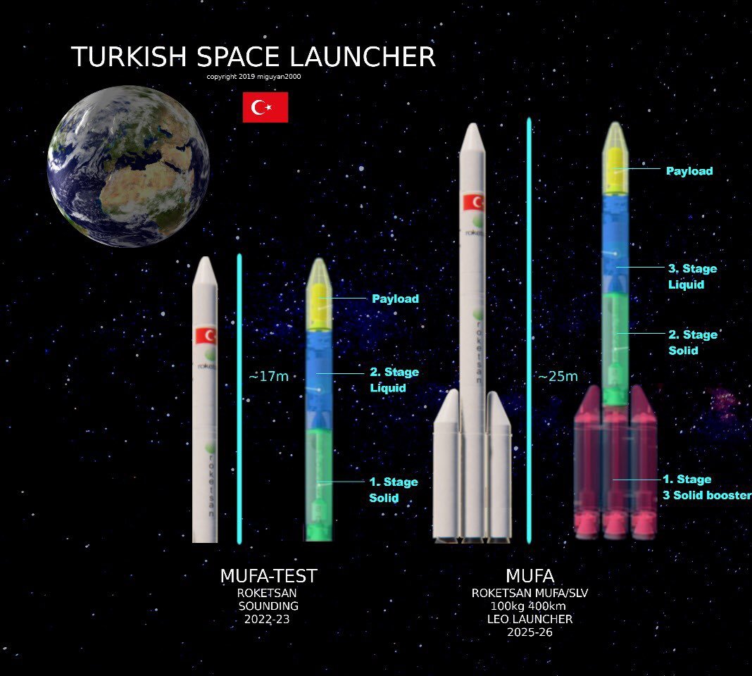

Bro, I think the roadway is going in this direction.
By 2021-22, MUFA test will be launched and We will see the MUFA SLV in 2024/25.
TP-02: 1. Stage: Small scale Solid; 2. Stage: Small scale Liquid
MUFA Test - 1. Stage: Full scale(1,35m) Solid; 2. Stage: Full scale Liquid
MUFA SLV: 1. Stage: Solid Booster; 2. Stage: Solid; 3. Stage: Liquid
