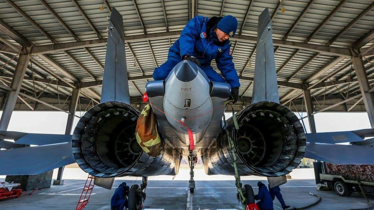

China displayed a TVC variant of the WS-10 at Zhuhai 2018. It is in the same class as the F-110/100 and AL-31 and would provide enough thrust.
Chinese engine is nowhere near as good as the Russian AL-41 series. It was lasting around 800 hours. They have only recently claimed that it can now last around 1500hours. If it is true, it is still far shorter than Russian engine (around 4000hours) and far behind the western counterparts (F110 manages around 6000hours).

Chinese engine is nowhere near as good as the Russian AL-41 series. It was lasting around 500 hours. They have only recently claimed that it can now last around 1500hours. If it is true, it is still far shorter than Russian engine (around 4000hours) and far behind the western counterparts (F110 manages around 6000hours).
The 500 hours between overhauls figure may be a 10-year old figure, if not older. However, the figures you mentioned are not official figures, so you shouldn't take them as definitive.
On the other hand, all J-10, J-11, J-16 and J-20s being built have switched over to the WS-10 now and no more AL-31s are being bought. That should tell you something about the state of WS-10.

First of all ; my mistake , not 500hours but 800 hours was the lifespan of the engine. Not time between overhauls. They are claiming now that it has been increased to 1500hours with the use of new materials in their single crystal blade manufacturing processes. This news is dated October 2020!
I think that news first came out in 2018 through minnie chan at SCMP, but you're right. It was 1500 hours engine lifespan and it was quoted from AVIC’s former chairman, Lin Zuoming.
But do note that ALL Chinese fighters, as I mentioned, are now using the WS-10. That should make it good enough for the TFX.
Also the Chinese progress is extremely fast so I would not expect those figures to have stayed the same. Already two next gen engines are under various stages of development -- the WS-15 having thrust comparable to F-119/F-135 in flight testing and the WS-19 is in development. Expect WS-10 to have improved and to continue to improve. It will surpass the AL-31 if it has not already (same for the Ws-15 vs AL-41).
