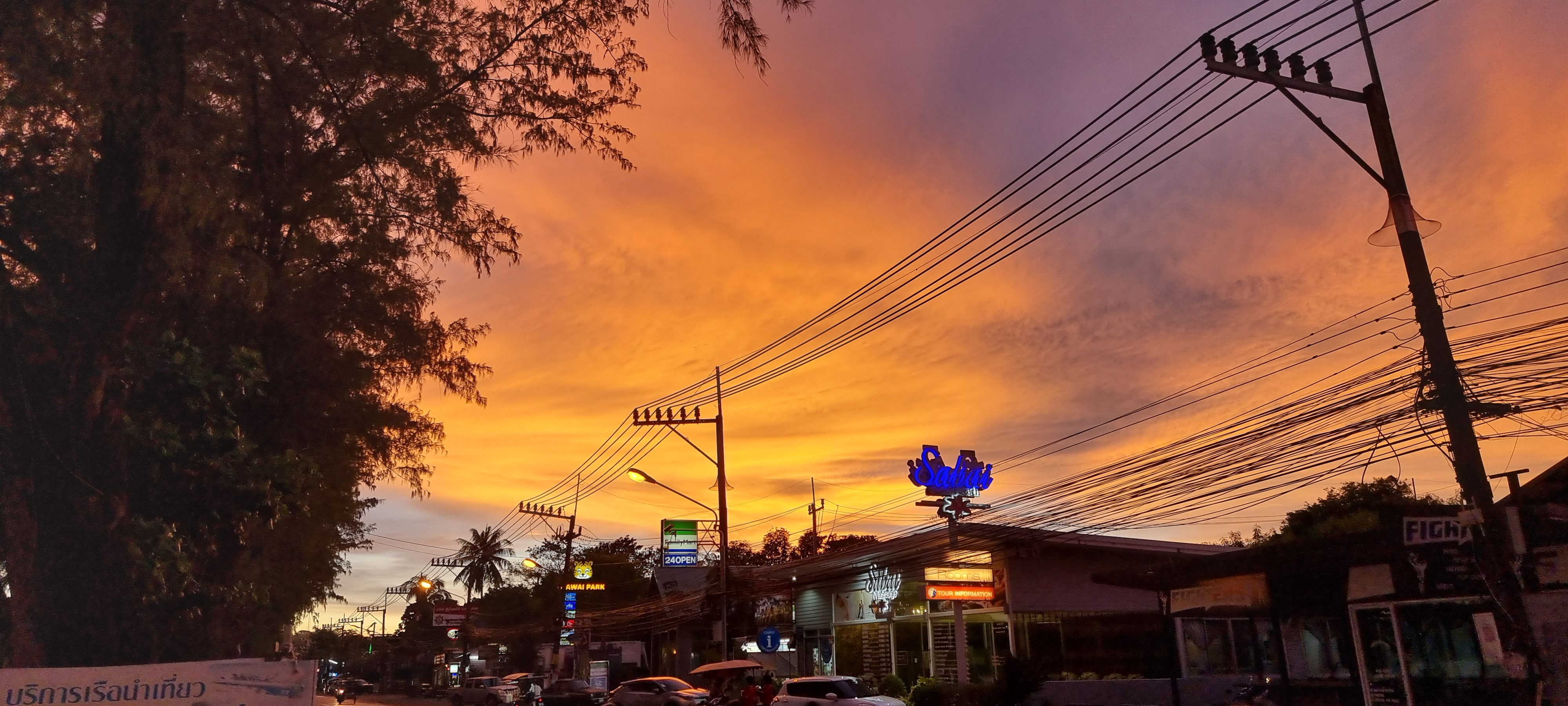

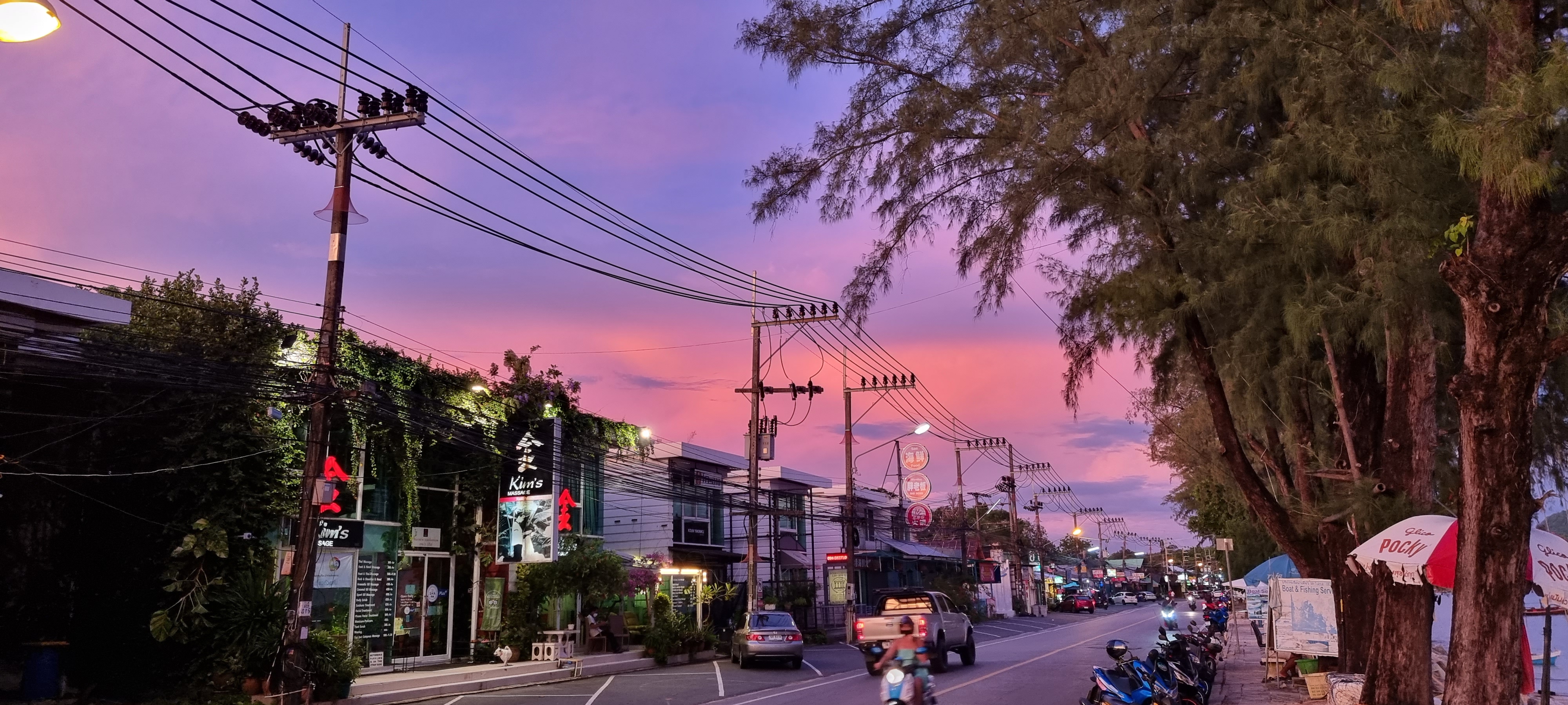

Yup, you can see those wires dangling down from poles in Thailand, sometimes as low as for me to be able to reach them, ofcourse they are usually insulated but the craftsmanship is so bad that the chances of a bad insulation through wear is quite high.
Adding to that, on rainy days you can hear a buzzing noises and small sparks from high woltage wires on the higher sections of the poles.
Lets just say an electrician doing such a job in switzerland would be jailed. :ROFLMAO:
Here are two pics that i took in rawai beach in phuket. Notice the wildlife barrier on the poles below the high woltage wires.
