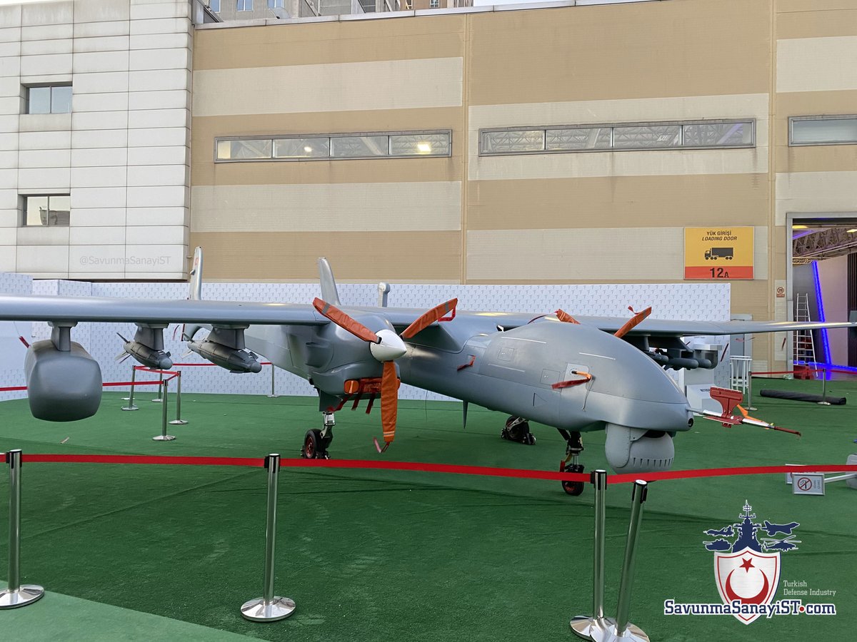

The serial production variant is much more handsome and several hundred kg lighter than prototypes. Sonobuoy pods will be integrated for Navy's Aksungur.

Bro, do they change random shape?
