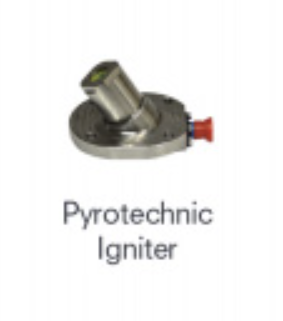

These strategic weapons do not rely on windmilling as a source of starting the engines, they have pyrotechnic igniters to start the engine...

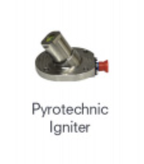

The igniter is likely to be in the role of a spark plug used to start the combustion and does not have anything to do with providing air for the combustion, so ram air is still required. By the way Akıncı's top speed is mach 0.296 and SOM has capabilities to start at various altitude and mach number conditions.
This isn't new technology, the use of such pyro igniters is well documented. Especially on how they work.
15 8,752
This seems to be used to complement the lack of ram air to drive the turbine fans. More like the first gear of the manual transmission car to get the car to move beating inertia. From all we knew from past disclosures about SOM ram air is essential for engine start. Perhaps a disclosure about this can be made down the road.
