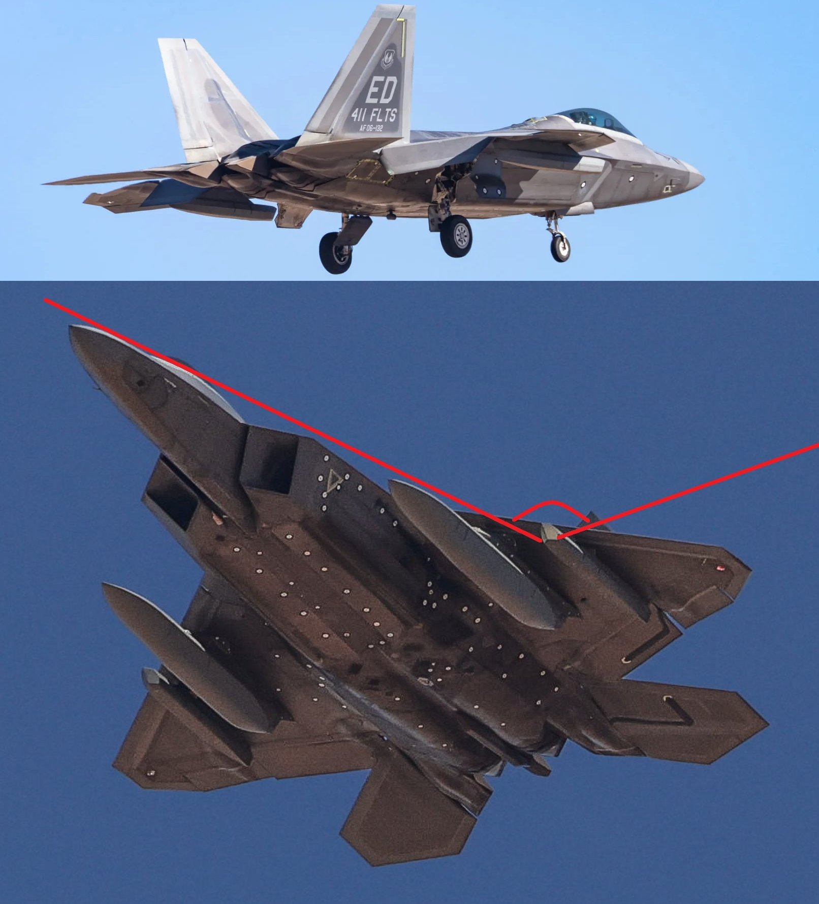

In F-22 MLUs, 1 of the stealthy sensor pod looks EO & other like EW.
So the fuselage acts as a blindspot, can't look the other side.
Then how will F-22 have spherical coverage?
Will 1 group of few data-linked F-22s do the IRST for other clean config F-22s?

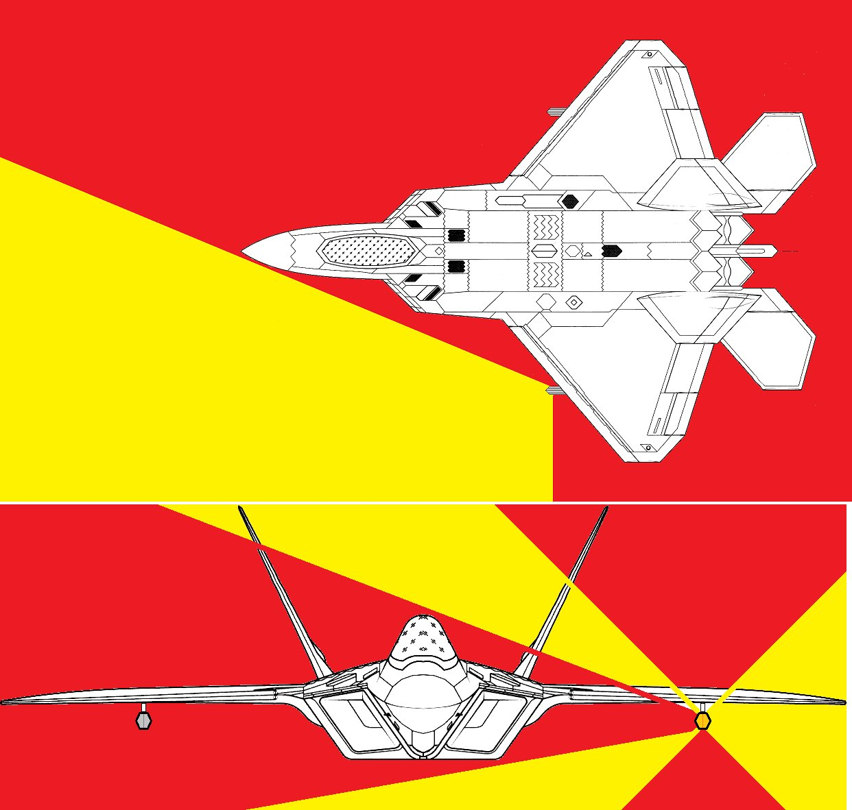

Below i'm assuming that the IRST sensor can look up/down +/- 45 degrees & 180 degrees in azimuth.
RED zone is blindspot.
YELLOW zone is scanned zone.

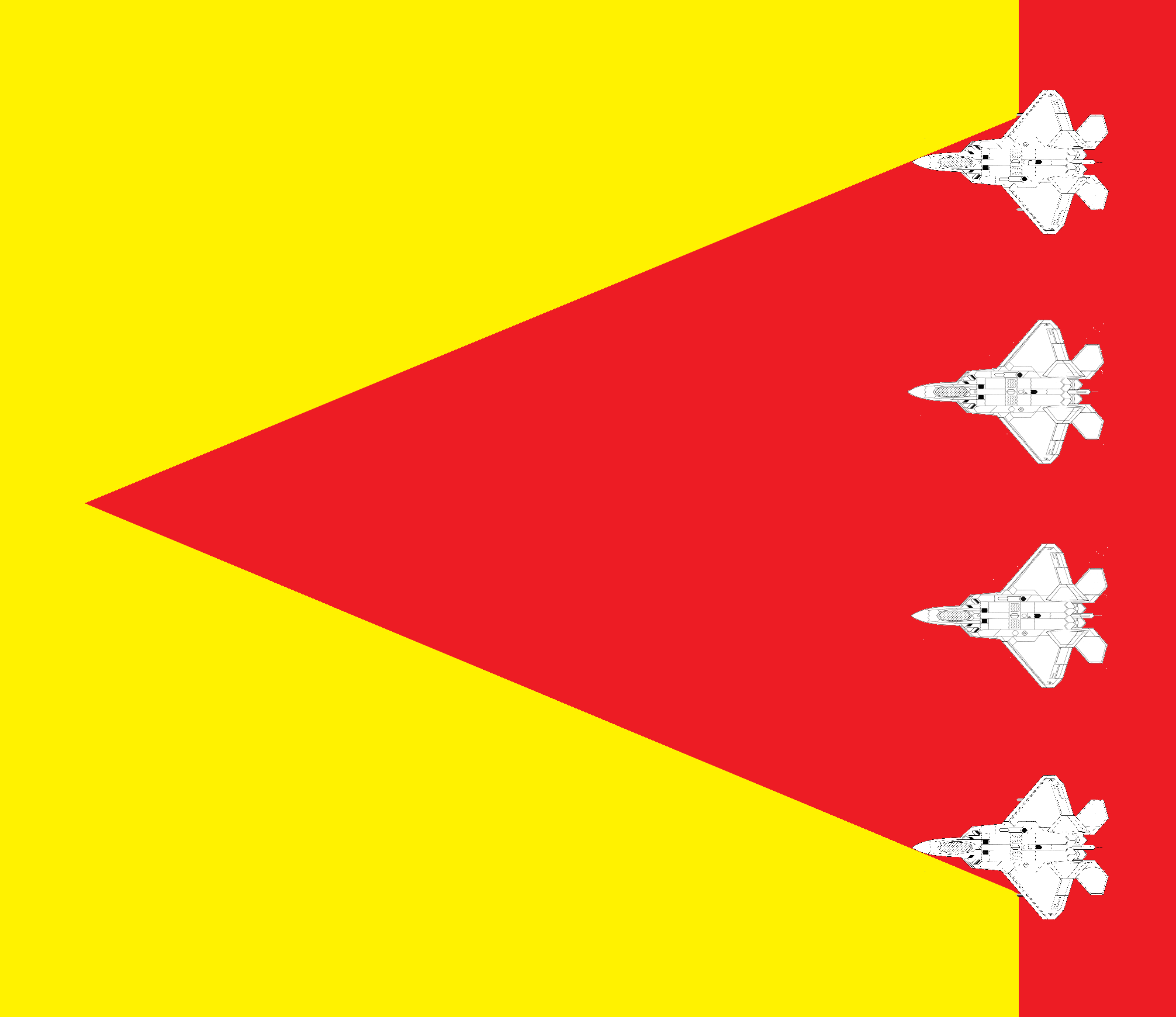

If few data-linked F-22s do the IRST for other clean config F-22s, then the flight group would look like this-

Both pods are IRST
Truth will be revealed eventualy but for now any confirmed/official source?

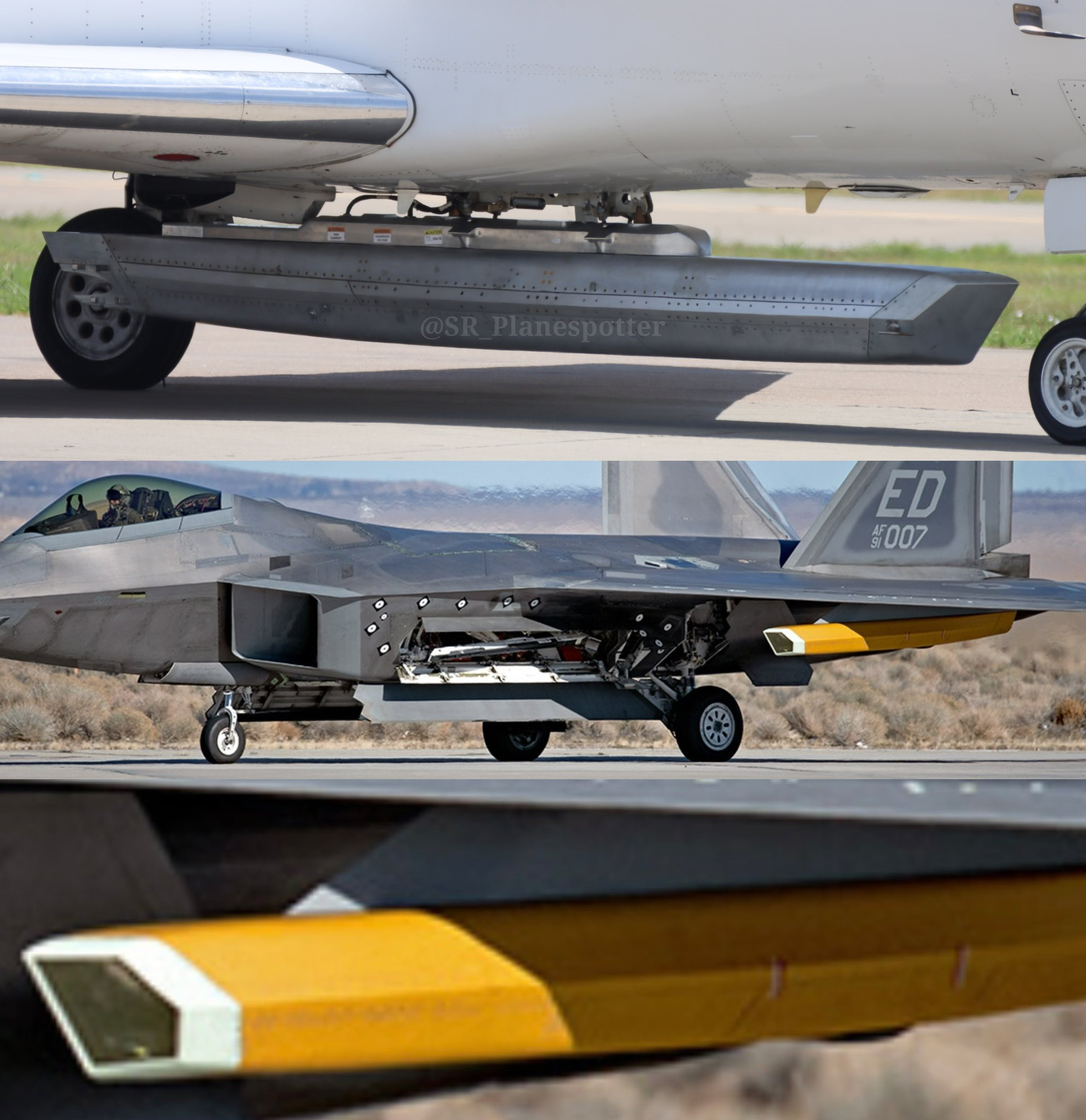

There are many other pics from different angles which people might be knowing & it doesn't look that pods are asymmetrical, but the 2 pods are indeed different, left is EO, right is non-EO, which is mentioned in Sandboxx video in 18th minute & TWZ site in 2022.
"With that in mind, the possibility that these pods represent just such a configuration, with an electronic warfare capability on one side and an IRST on the other, looks more likely than not. The pod on the F-22’s left wing does look like it has a different faceted nose area than the other, almost as if it is meant to be a transparent window, while the other is opaque."

L3Harris tested the combined detection and positioning performance of infrared sensors and the INS system in an air-to-air scenario. Target detection was achieved from a distance of 41.5nm using a camera mounted on the pod. The importance of infrared sensors in ground-to-air engagement was demonstrated in the Iran war.

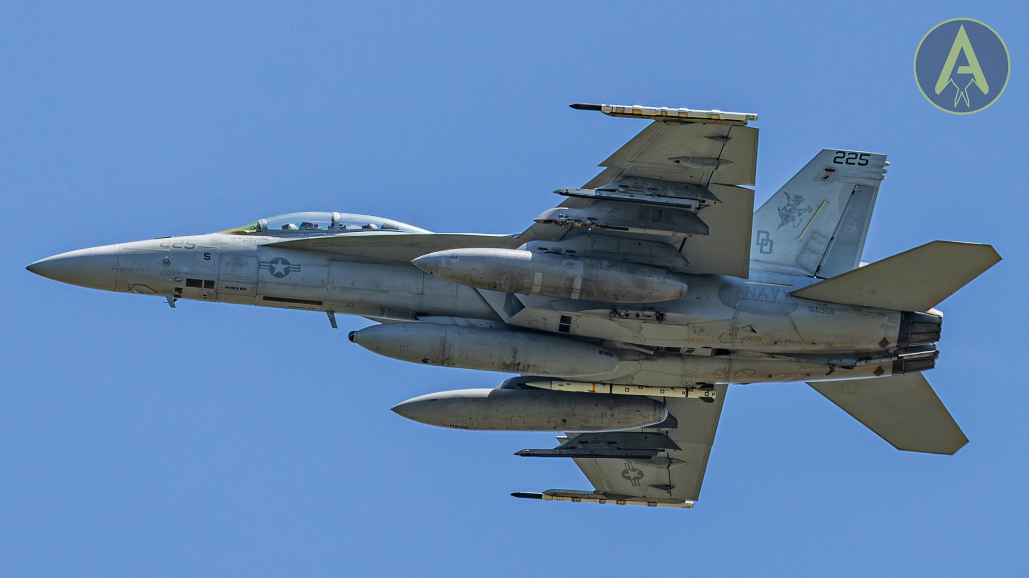

US air force is developing a 460+ km range air to air missile to be used by F35s, F/A18s and future F47s.
This should put the cat among pigeons!!
Built quietly by Raytheon’s Advanced Technology division, the AIM-424 Long Range Air-to-Air Missile (LRAAM) is capable of hitting targets over 250 nautical miles (463 kilometers) away by leveraging its 13.5″ diameter and aerodynamic profile — outranging “any threat” according to Raytheon’s president Phil Jasper.
“LRAAM sustains the Department’s first look, first shot, first kill advantage by providing our aviators greater reach, greater survivability, and greater tactical flexibility in the air-to-air fight. Built for 4th, 5th, and 6th generation platforms, LRAAM is designed for the air wing of today and the future,” the Navy said in its recently updated weapons portfolio overview.

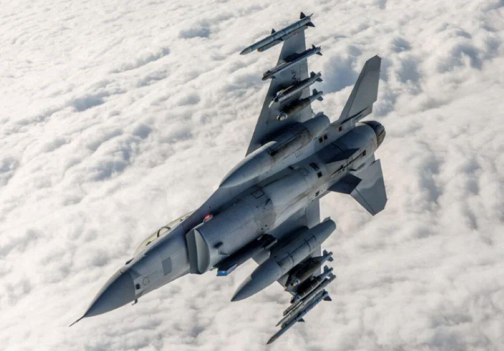

NATIONAL HARBOR, Maryland—Lockheed Martin is pitching an upgraded variant of the F-16, called the F-16G, to the U.S. Air Force to fill Fighting Falcon units that will age out of their existing fighters.
Multiple sources told Aviation Week that the F-16G is an improved version of the latest Block 70 variant of the fighter. A source familiar with the aircraft says it will include conformal fuel tanks, 600-gal. wing tanks, both an infrared search and track and SNIPER targeting pods and a drag chute.
