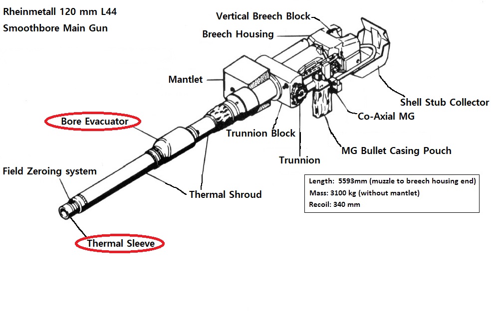

First, Let me briefly explain how and how the main gun of the tank is constructed to help the readers understand.
What we need to pay attention to in this picture is the Thermal Sleeve and the Bore evacuator, Because the design of the leopard 2(A6,A7) and Altay's main guns barrel is different. And I will compare with Leopard 2 A6 and A7 to explain how Altay's main gun differs from Rheinmetall's Rh-120 L55.

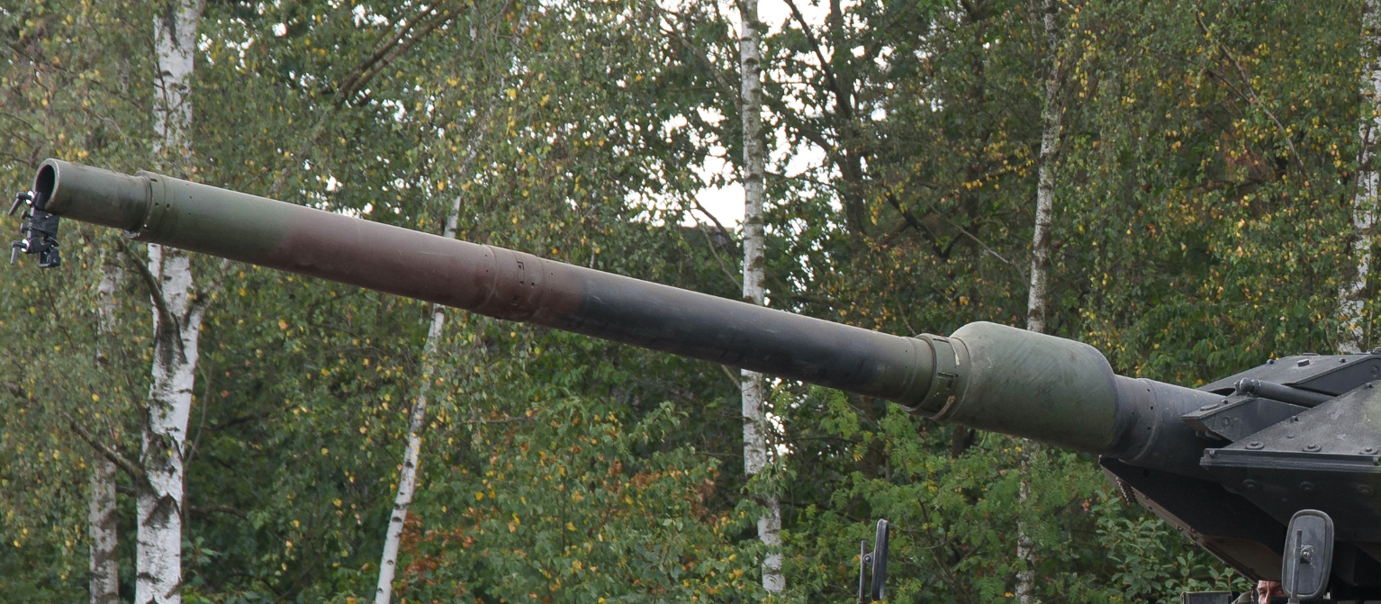

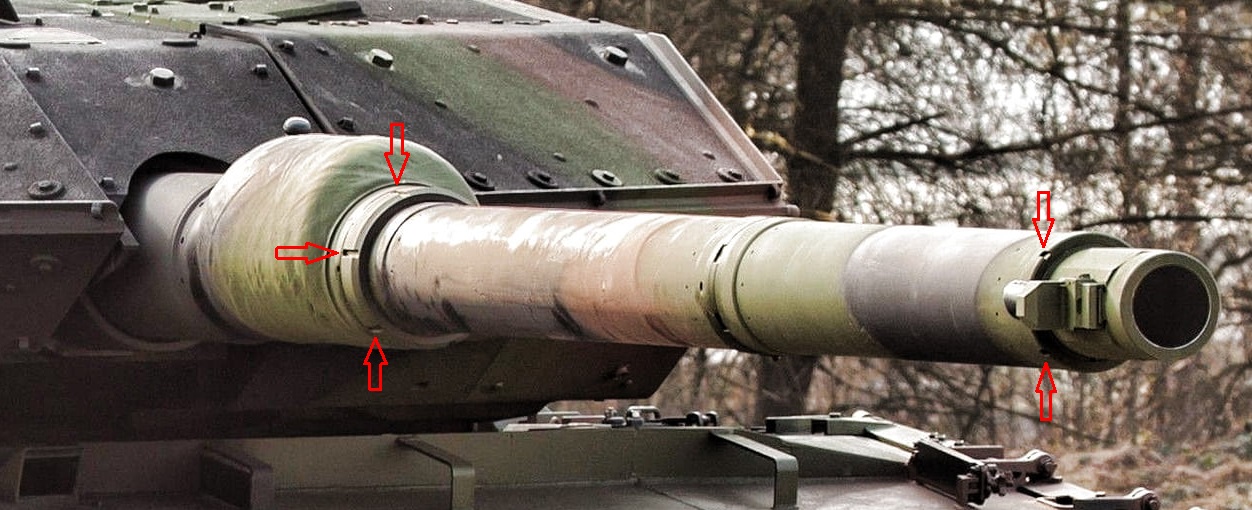

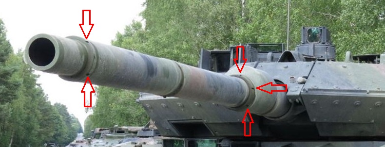

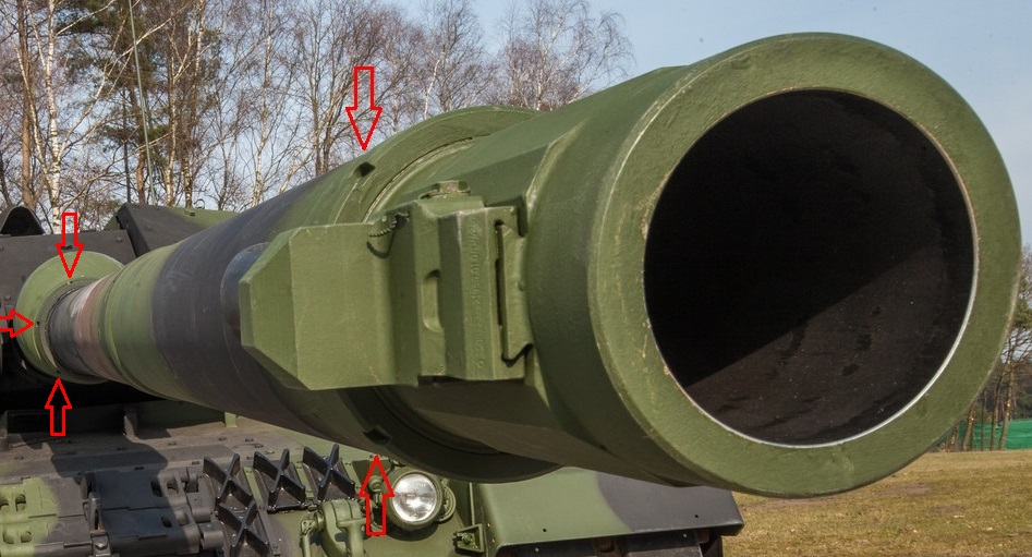

First, we need to look at the exterior of the Rheinmetall 120 mm 55 caliber smoothbore gun of Leopard 2A6 and A7.
A total of 4 grooves exist in the area where the thermal sleeve of the leopard 2 is connected to the main gun barrel. (There are 2 grooves on the left and right sides)
And there are a total of 6 grooves where the bore evacuator is connected to the main gun barrel. (There are 3 grooves on the left and right sides)

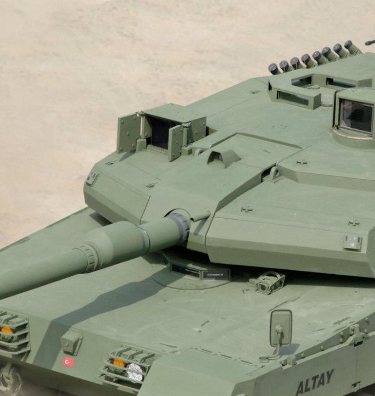

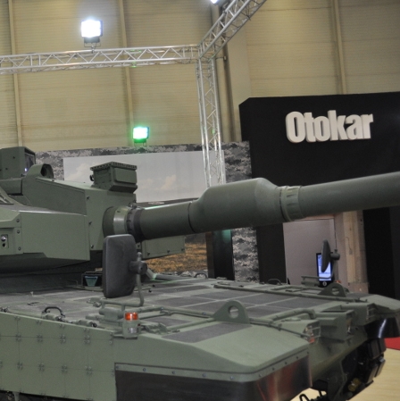

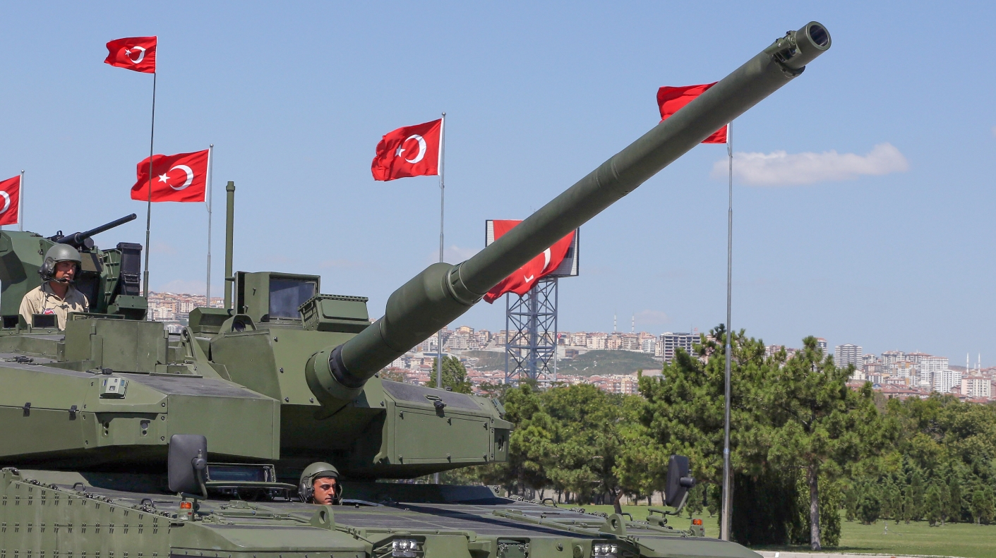

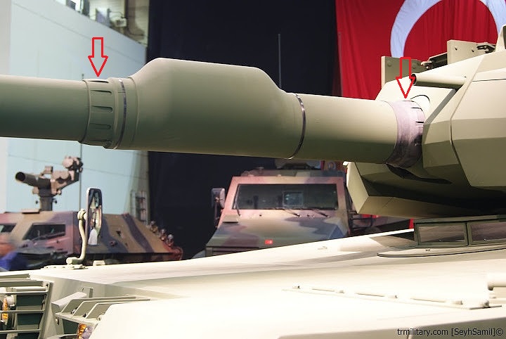

And now let's take a look at Altay's 120mm 55 caliber main gun.
Now, did you find any difference between the main guns of the Leopard and the Altay?
A total of 10 grooves exist in the area where the thermal sleeve of the Altay is connected to the main gun barrel. (There are 5 grooves on the top and bottom)
And there are a total of 10 grooves where the bore evacuator is connected to the main gun barrel. (There are 5 grooves on the top and bottom)

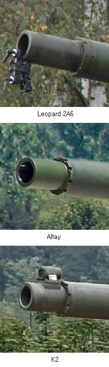

Now we know for sure that Altay's main gun has nothing to do with Rheinmetall. But, a little more comparison is needed to prove that Altay's main gun has nothing to do with Rheinmetall. let's compare Leopard, Altay, and K2's main guns

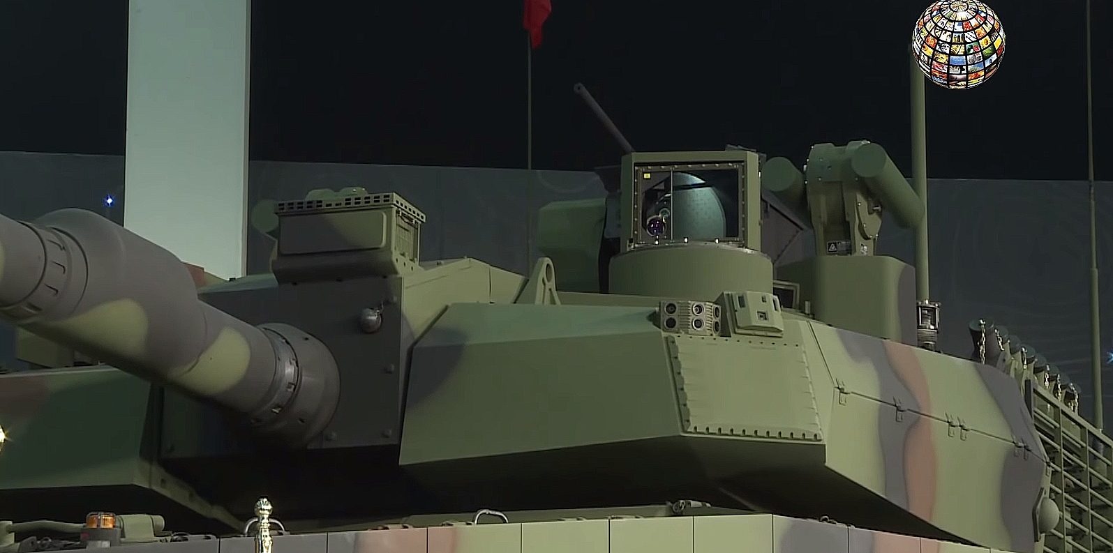

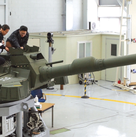

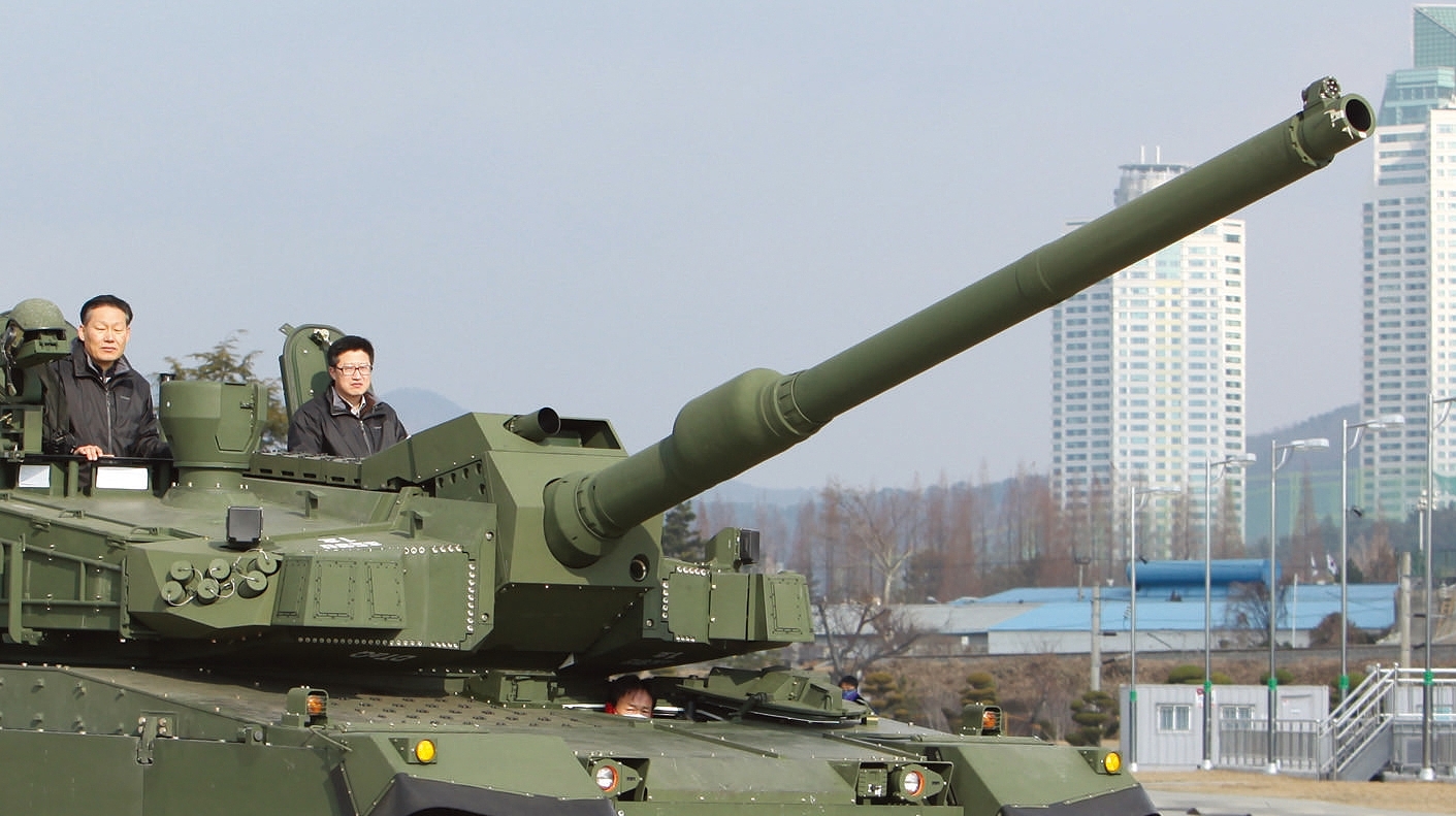

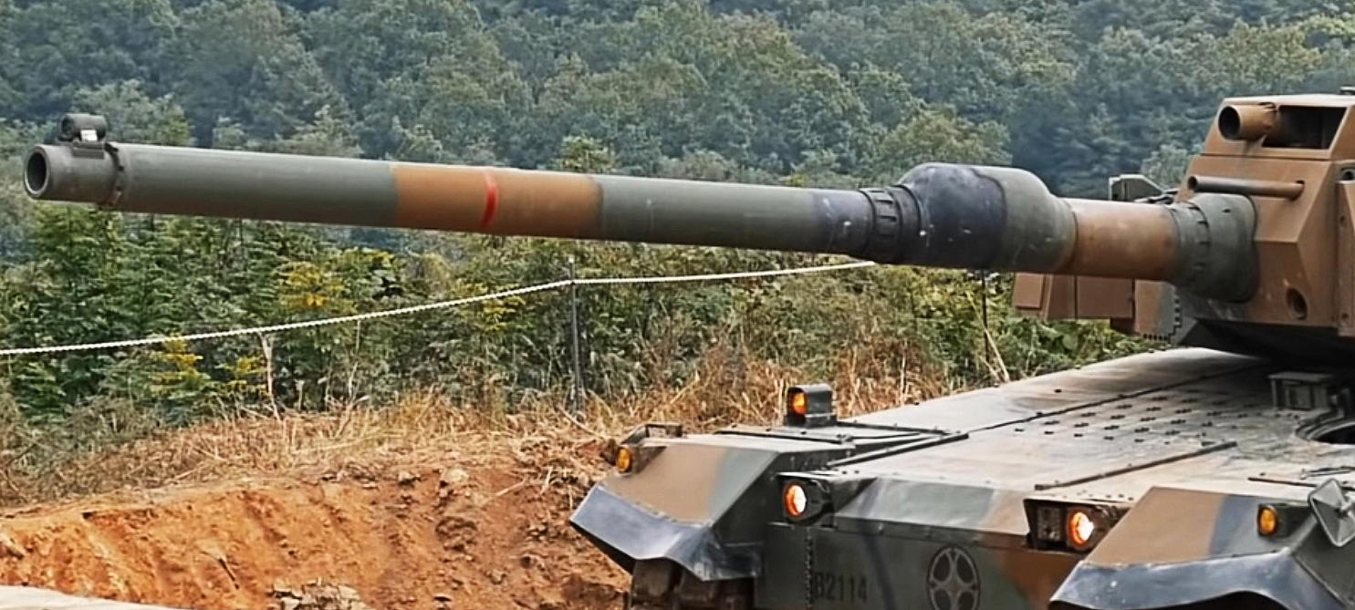

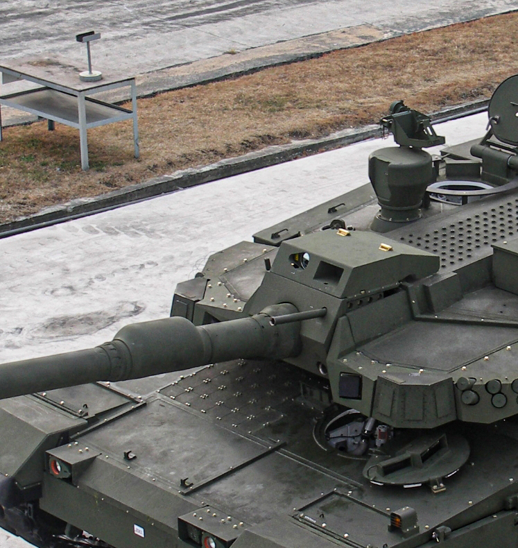

If you look at the barrel of the Altay and K2 main gun, you can see that the Thermal Sleeve and Bore Evacuator have the same appearance. But Leopard 2A6's Thermal Sleeve and Bore Evacuator show that appearance is different from Altay and K2.
The designer of the K2 tank said the CN08 120 mm 55 caliber main gun of the K2 was designed lighter than the 120 mm L55 of Rheinmetall. Leopard 2A6's Thermal Sleeve and Bore Evacuator show that appearance is different from Altay and K2. And I found another difference between Altay and K2's main gun and Rheinmetall's 120 mm L55 main gun.
Certainly, the thermal sleeve of the Leopard 2A6 is designed longer than the thermal sleeve of the Altay and K2. Now we know that Altay's MKE 120 mm L55 main gun has a completely different design than Rheinmetall's 120 mm L55.

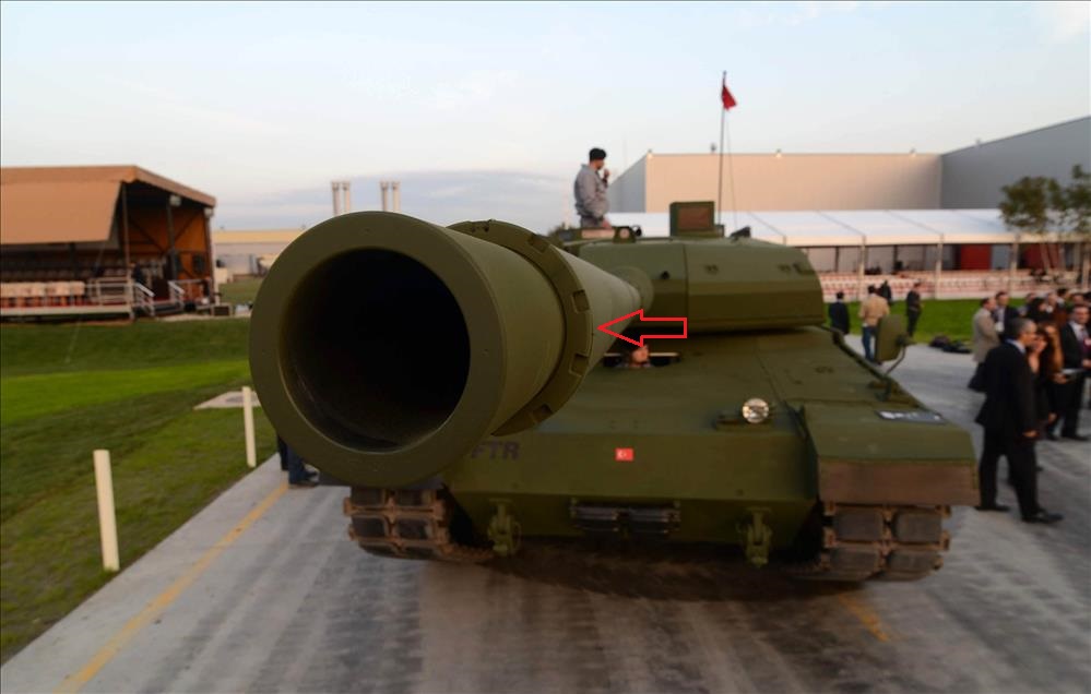

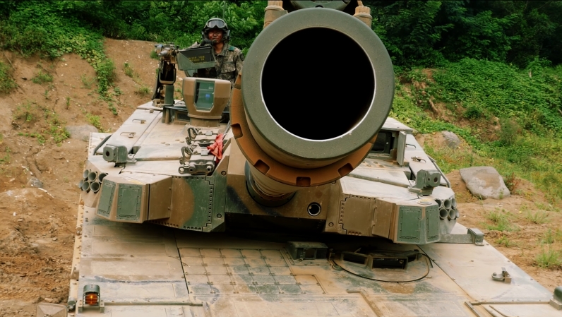

Now let's compare in detail whether Altay and K2 really share the main gun of the same design.
Verified Fact: Krauss-Maffei Wegmann and Rheinmetall did not participate in the Altay tank development project. The Altay Tank development Project was conducted through international bidding, and Hyundai Rotem beat Germany (Krauss-Maffei Wegmann) to be selected as the preferred bidder in June 2007, and Hyundai Rotem and Otokar signed the contract on July 29, 2008.

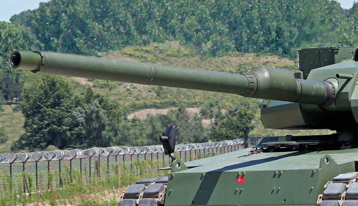

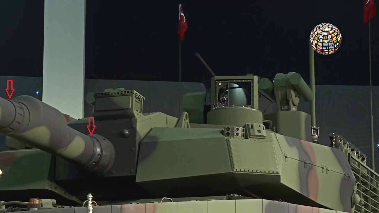

View attachment 33180 View attachment 33181 View attachment 33182
Now we have identified the external difference between Altay and Leopard's main gun. Then there is only one thing we are curious about. If rheinmetall provided technical support for the main gun design of the Altay tank, questions arise as to why Altay's main gun was designed differently from the Leopard.
View attachment 33185 View attachment 33186 View attachment 33187
View attachment 33190 View attachment 33191 View attachment 33192
View attachment 33193 View attachment 33194 View attachment 33195 View attachment 33196
