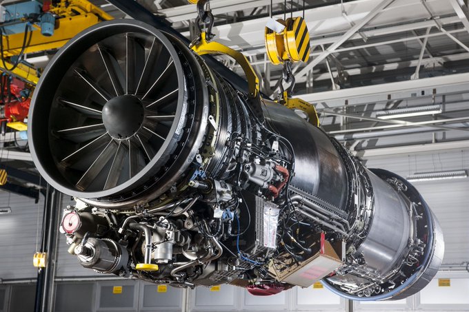

Can turbojets be converted to turboshafts? How does this work in this case?
Yes they certainly can be, if the turbojet (i.e effectively the gas turbine "core") is axial compressor type.
Turbojet/core seeks to output its power fully in the form of jet exhaust.
Essentially all of the variants....be it turbofan, turboprop or turboshaft look to "gear" what this core does....by say converting the jet exhaust into rotary action by addition of one extra turbine at the end (or the equivalent of this with an existing turbine stage).
It is that turbine modification choice that powers a fan, prop or shaft essentially to "gear" air to flow at larger volume but lower speed (compared to what a turbojet does).
Turboprops and turboshafts are especially intimately connected/related to each other...essentially you just design a "free" power turbine to sit on its own spool at the end and that powers either the prop or shaft (which leads to the rotor).
There are generally practical constraints to how far this can be done at small size turbojets/cores (or if they use centrifugal compression)...but if you set up the core correctly with further variants in mind...it should not be too difficult.
Of course this is from new production side (for variants), you can't simply retrofit an existing turbojet to be something else generally.

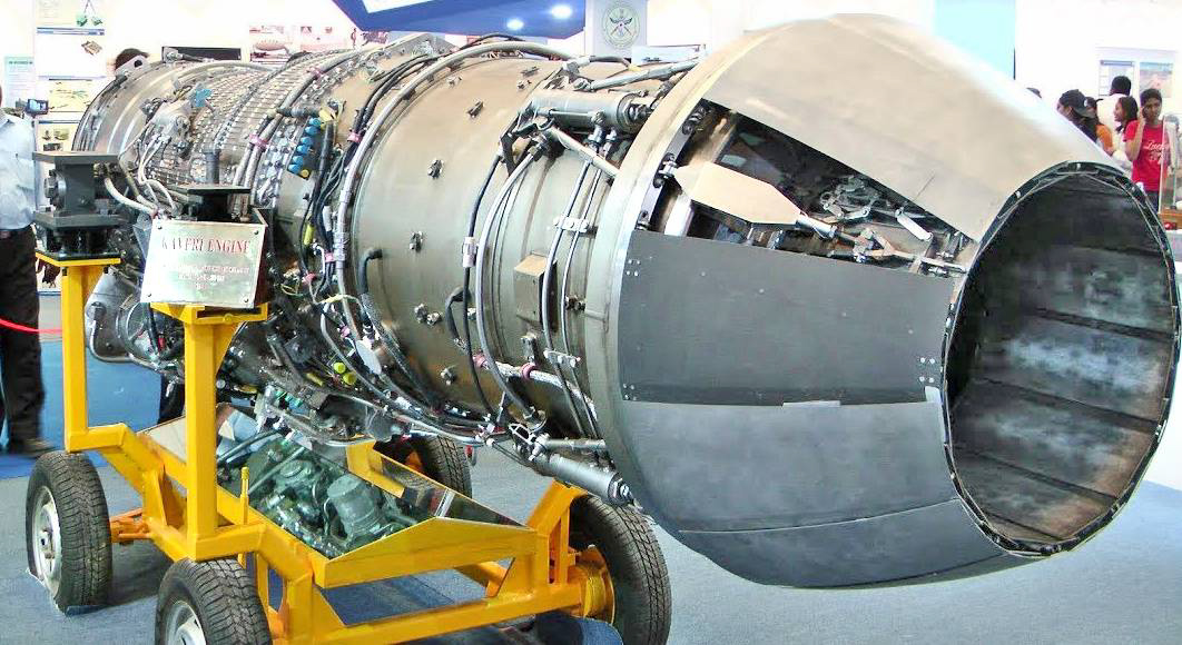

Thought India had already developed this capability with kaveri engine. They could get slot more power out of kaveri engine with single crystal blades and ceramic coatings
Kaveri engine (developed so far) was stuck to directional solidified, which is tier just below SCB....but significant tier difference in the end.
DRDO/GTRE local efforts were aided somewhat by using some level of ToT given by Russians on SCB for MKI engine (koraput production+MRO facility has this machinery and process control I believe)....but maturing the RnD for new effort based only on that was cumbersome in the end ithas turned out....and you are stuck with Russian final level in end too anyway (which is inferior in raw MRO-hours/thrust terms especially compared to western i.e you have not mastered the best option you now have available).
With Indian RnD funding more established in area, SAFRAN/SNECMA now more involved with Indian aviation sector, and from sounds of things (in last couple years) specific consultancy for Gas Turbine Ecosystem going forward at the scale involved, things should bear more fruit this decade given India long term objectives and growing needs in this sector, in both civil and military domain.
There will be a few more core competencies needed to be realised to make jump within SCB though..... from the heli shakti class of turboshaft HPT to the (far more serious) turb-inlet+exit conditions found in HPT and LPT of much larger turbofan....specifically the internal geometries involved for cooling and their process and quality control.
i.e it is a series of steps in SCB field too rather than everything unlocked 1:1 by one initial sub-area.

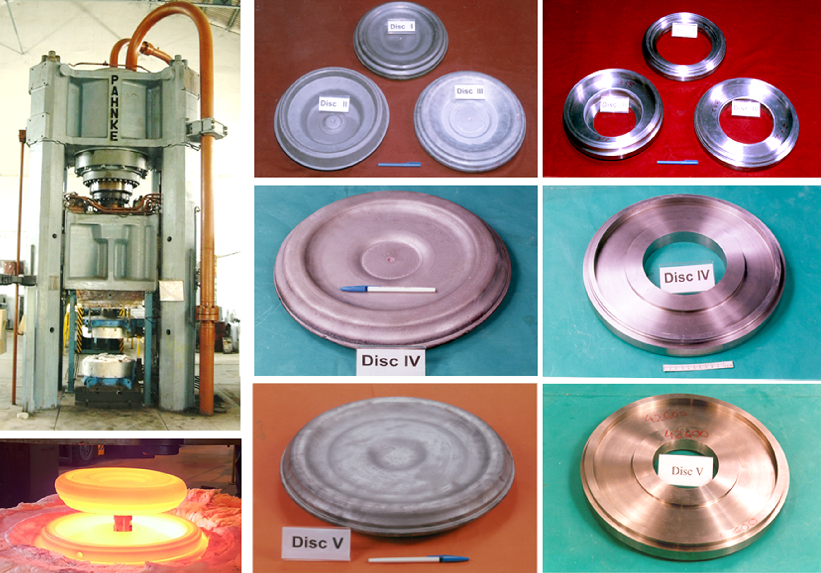

DRDO develops Critical Near Isothermal Forging Technology for aeroengines​
Posted On: 28 MAY 2021 1:58PM by PIB Delhi
Defence Research and Development Organisation (DRDO) has established the near isothermal forging technology to produce all the five stages of high-pressure compressors (HPC) discs out of difficult-to-deform titanium alloy using its unique 2000 MT isothermal forge press. The technology has been developed by Defence Metallurgical Research Laboratory (DMRL), a premier metallurgical laboratory of DRDO at Hyderabad. This is a crucial technology for establishing self-reliance in aeroengine technology. With this development, India has joined the league of limited global engine developers to have the manufacturing capabilities of such critical aero engine components.
To meet the bulk production requirements, DMRL technology was transferred to M/s MIDHANI through a licensing agreement for technology transfer (LAToT). Using the isothermal forge press facility available at DMRL, Hyderabad, bulk quantity (200 numbers) of HPC disc forgings pertaining to various compressor stages have been jointly (DMRL & MIDHANI) produced and successfully supplied to HAL (E), Bengaluru for fitment in to Adour Engine that powers the Jaguar/Hawk Aircrafts.
In India, the Adour engine is overhauled by HAL (E), Bengaluru under a licensed manufacturing agreement with OEM. Like in any aeroengine, the HPC Drum assembly has to be replaced after a specified number of operations or in case of damage. The annual requirements of these high value HPC discs are quite large, warranting indigenisation. HPC drum is a highly stressed sub-assembly and is also subjected to low cycle fatigue and creep at elevated temperature. The raw materials and forgings for HPC drum are required to be of the highest quality which can meet the specified combination of static and dynamic mechanical properties.
DMRL developed this forging technology by integrating various science and knowledge-based tools. The methodology adopted by DMRL is generic in nature and can be tuned to develop other similar aeroengine components. The compressor discs produced using this methodology met all the requirements stipulated by the airworthiness agencies for the desired application. Accordingly, the technology was type certified and letter of technical approval (LoTA) was accorded. Based on the exhaustive component level and performance evaluation test results, HAL (E) and Indian Air Force cleared the components for engine fitment. Apart from DMRL and HAL (E), various agencies such as MIDHANI, CEMILAC and DGAQA worked in unison to establish this crucial technology.

The major problems of the current Kaveri engine were the creep, screech & combustion instability. The last 2 problems were being caused by the afterburner. The dry Kaveri doesn't have the AB section so those problems don't exist on that variant. The creep related problems were sorted out sometime back. So the dry Kaveri was ready for flight tests then, the wet version is ready now. GTRE needs to get on with flight testing quickly.
After flight testing you van certify them to be ready. But what do you deploy these engines on ? There is no current user for the Kaveri with the AB. The Tejas could be a user but the engine doesn't produce enough power & the engines of the Tejas are still very new. Each fighter needs 2 sets of engines. So maybe when the Tejas needs new engines the Kaveri with AB could be used. That's at least a decade away, GTRE has enough time to improve on the engine's AB.
The engine dry thrust is good enough. Further increase in dry thrust will come from the new fan & the high pressure compressor. The fan is already here, the HP compressor is still being worked on. The wet thrust needs to at least match the current 84-85 kN of the GE 404. The Kaveri could get to 81-82 kN with the AB but couldn't sustain that level of thrust due to screeching & combusting instability. Without those problems & with the new compressor we should be able to get to 85 kN. The next set of challenges would be making alloys that can help us get to a higher TET & sustain it for long periods of time.
In the mean time the dry version is going to be operationalized with the Ghatak. With that LSP of the engine will start. Serial production will bring its own challenges. When the production line is established the Kaveri with AB can also be produced there. Thing are looking up for the Kaveri, for the 1st time in many many years.

Creep issues along with combustion instability and screetch issue has been resolved
@Nilgiri @Zapper @Cabatli_53 @Test7 @Nein2.0(Nomad) @MisterLike @Lonewolf @Indos @T-123456
Afterburner issue remaining
Lonewolf
511
298
You mean not sufficient thrust right?
They're redesigning it completely to get more thrust
Ya ,but I meant weight issues too ,hope they don't make it too heavy , if weight is controlled we might see it going into Ghatak ,and some tejas
