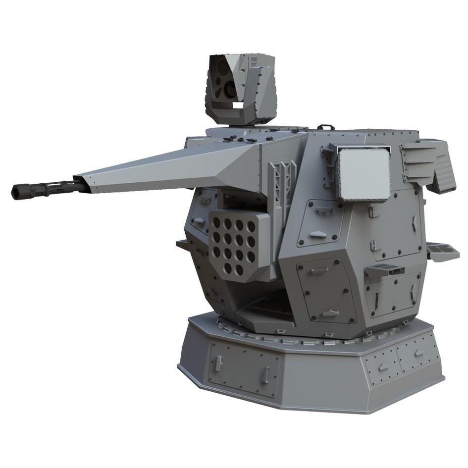

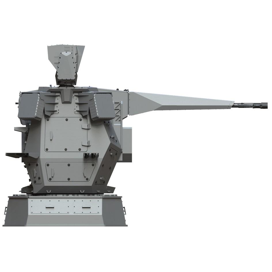

What is hybrid AD? With sungur missiles and AA gun?
2,823
122 14,330
As platforms evolve into higher capacity boats, I expect to see these hybrid, missile + 35mm turrets on USVs. For example, 4/6 KUZGUN, multi-role 35/40mm cannon and integrated PMADS can create an extraordinarily large asymmetric threat against small displacement boats such as adversary patrol/ missile boats; and any military-grade helicopters/logistic operation between islands.

-Will you develop gun based CIWS or missile based CIWS?
-Aselsan : Yes
And it is beautiful.
We need to put this on every ship we have, not because they might need it, but because it is gorgeous.
I wonder what those two designs will look like once we see them as prototypes, Pantsir hasn't covered itself in glory at all, so I'm curious how Aselsan improved on the concept.

Better radars (high resolution x-band that detect drones on time), better missiles (better missile guidance that is).
The Russians did upgrade the pantsir after the TB-2 debacle but they seem not to be able to produce them in numbers to make a change in Ukraine

It seems from the size of launchers that the missile system is not Hisar but land version of Goktug family
Yes, G40 is now in contract phase. There also will be a NASAMS like system.

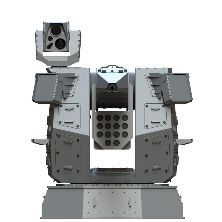

There are 3 Naval point defence systems published by Aselsan;
First; that uses Bozdogan (likely to get a new name) 12 missiles, with 4 AESA (AURA MkII or a new nametag) to scan&track. For fast attack boats that may not fit Hisar-D.
Second; that uses Akdogan missile, higher in count. For corvettes and frigates that do not require autonomous PDMS as they might have 2 + tracking and a stronger search radar. Nonetheless, a long range PDMS is not required as Hisar-D is present, thus a shorter than Bozdogan range Akdogan is used.
Third; Goker-D 35mm + Sungur-N for patrol boats and small vessels (optionally with 4 x AURA radar (ER version) for standalone configuration) . It is made to be installed on 35mm RCWS spots.

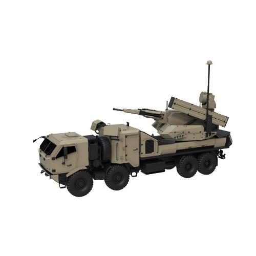

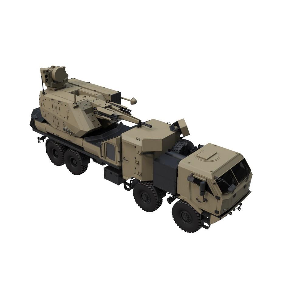

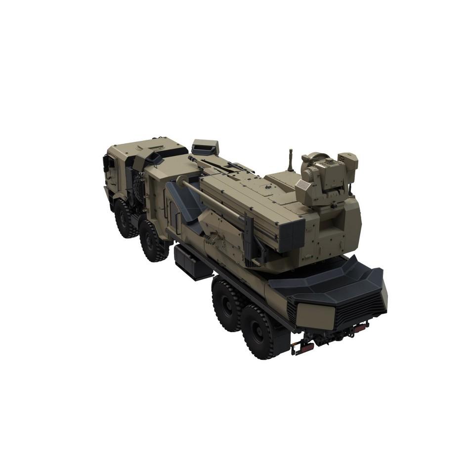

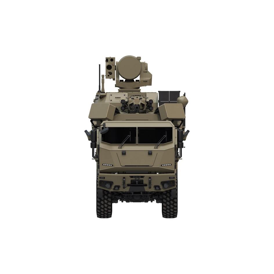

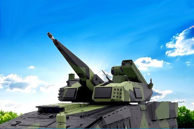

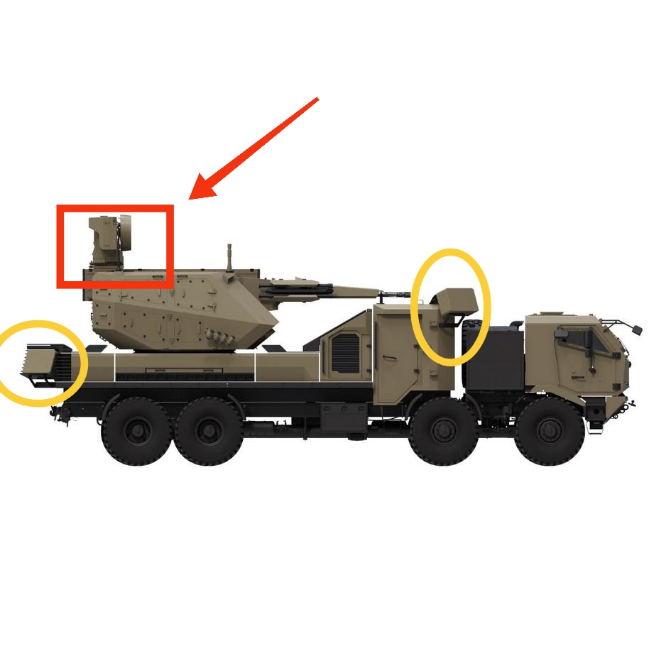

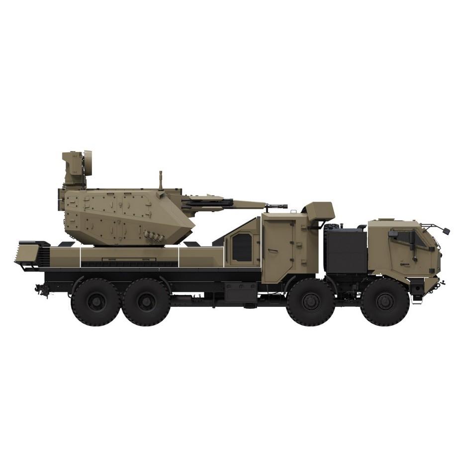

Do you have any idea why wheeled point defense system has a Fire Control Radar and Naval CIWS don't.
While Both have 4 fixed AESA panel why the naval one doesn't have?
AFAIK FCR is needed for the 35mm cannon due to calculate distance for smart ammunition. However fixed AESA plates can determine everything around CIWS . So why wheeled CIWS has a FCR?

Most probably ,fire control radar will guide RF guided missiles ,whereas other ones will use iir guided missiles. And 35 mm can use aesa panels only
2,904
58 5,192
I don't think so. If wheeled CIWS has RF guided SAMs,it will be crazy. I think the wheeled one is not original image from ASELSAN.

Maybe AESA radar doesn't have enough angular or distance resolution.
2,904
58 5,192
But the naval one doesn't have any FCR! If the AESA plates weren't enough to calculate distance, the naval one should also have FCR.
Edit:
Skyranger also doesn't have additional FCR. Just 5 AESA plates.
Edit:
Skyranger has 2 AESA pointing directly forward. This might be how they increased the angular/range resolution. I don't know, we'll see when the actual prototype is shown.
