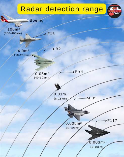

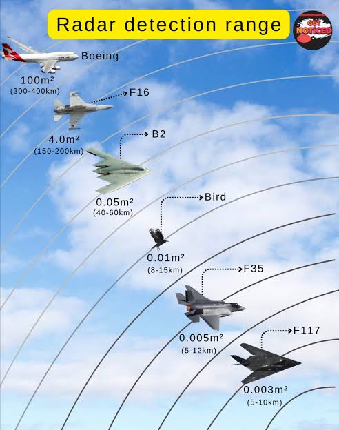

Detection range of F-35 is 10km , ok then? What if F-35 flies over 10km altitude? İt is over the detection limit?
So we should turn all radar antennas 90 degree looking to sky?
Behind the 10 km f-35 is stealth, don't forget.
Also with which weapons could you intercept target that had LowRadarSection ? Just thermal seekers could recognize. At 10km altitude , top of the radar , Korkut won't work. RF guidance won't work. Just IIR guided missiles could intercept if Data-Link supplied enough information.
If f-35 flies over 10km , detection range will be 1meter which is length of antenna.
I don't know how they calculate these numbers. Distance for ground radars? Or from other fighters?
If the numbers given for ground radar ,At which altitude? Radar source emits Signal from which angle degree?
Abi benim İngilizcem yetmiyor, anladın sen beni.
@Yasar_TR
I don’t know where you got those detection ranges. But it doesn’t sound logical for the stealth planes. Even RCS values are subjective to a degree.
I remember reading that export level S400s could lock onto F35, 35-50km away depending on position etc. Russian claim that their S400 apparently can lock on to it 50-80km away. With GaN modules and latest technology available at Aselsan, I am sure that our long distance detection ranges are a lot more than what you have given here. I am sure during Iran bombing, when Israeli F35s came close to our borders we had a chance to test their detection ranges.
Radar power and quality makes a big difference. A radar like SABR and a radar likeTyphoon’s ECRS-Mk2 with hybrid GaN modules will have totally different detection ranges For a 1m2 RCS target.
