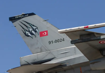

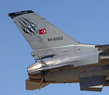

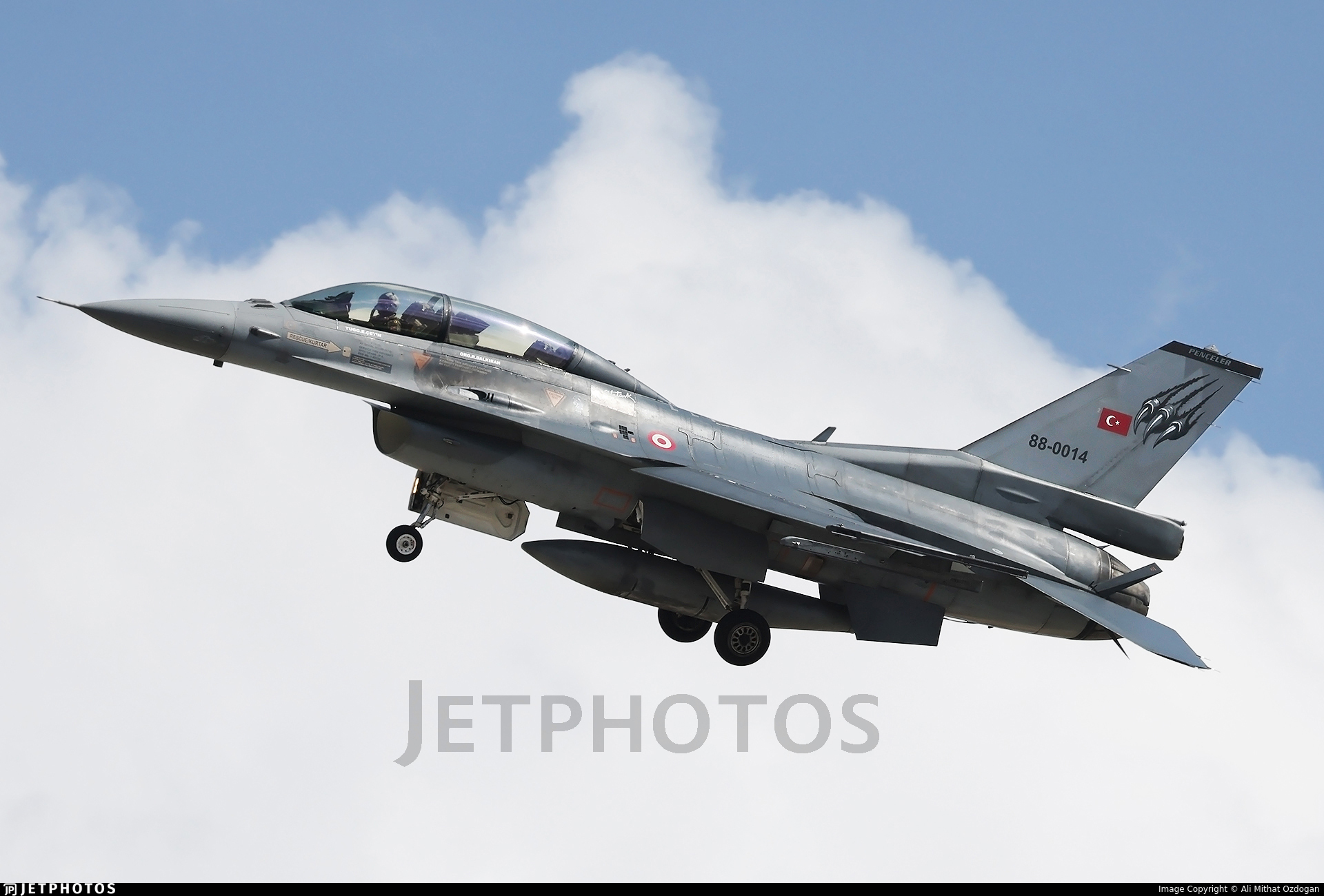

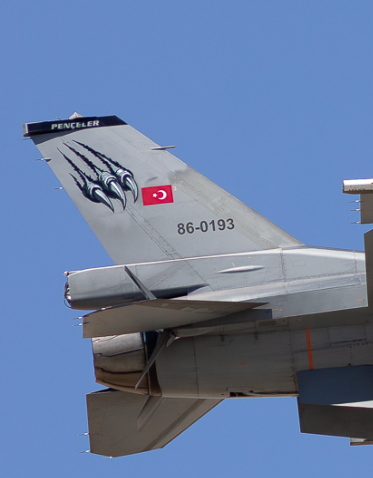

Looks like the old 133 "Claw" was brought back to life as well. They used to fly F-5s and it was disbanded in 2013. The "132" detail on the first patch makes me think they will possibly be another tactics and training squadron like the 132?
Funfact, with 133 being returned back to life, we now have a full house at Konya 131 through 138. Only 132 and 133 are fighter squadrons, but fun still.
First Claw seen with a F-16D B40M. This aircraft used to fly under 132 Daggers, so we can indeed say 133 was born out of 132. I also now see the dagger the bird is holding on the first patch; must be a reference as well.

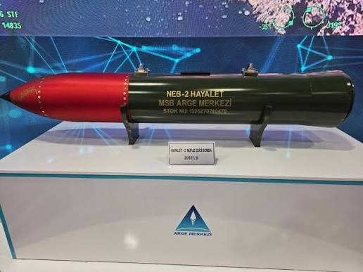

Let us not get ahead of ourselves.
I have written about the bomb in question here before, which is dubbed as “hayalet”, in my previous post in below page Post number #10354
Hayalet and gbu57 are very different bombs. GBU 57 is a monster bomb compared to Hayalet. What we have with hayalet is a poor man’s GBU-57.
I think the point here is that the GBU-57 has a tenfold weight compared to ours.
The point here is that two of them could match a 13-14 tonne GBU-57 in penetrating enemy bunkers.
Unless our bomb somehow defies the laws of physics, that is simply impossible.
After the shit they pulled in this years IDEF, I don't believe anything MSB Arge says mate.

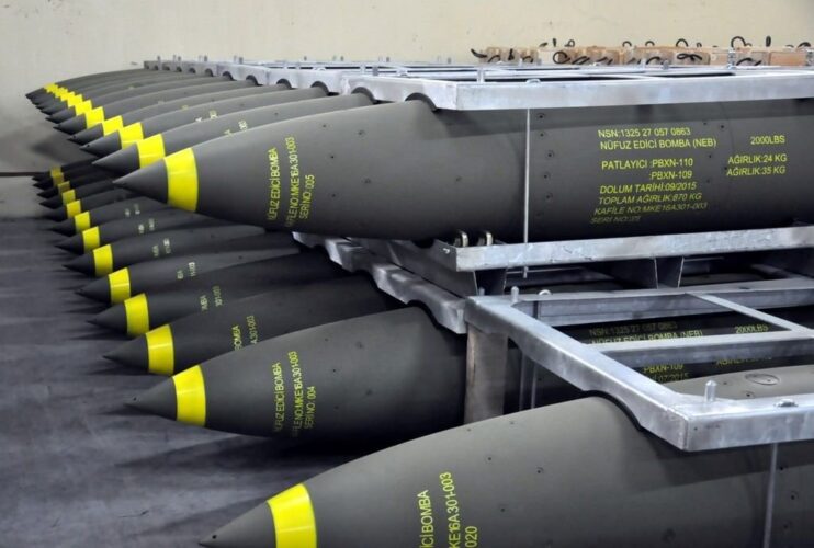

When a bunker buster bomb explodes underground in a “confined” space, the explosive force has 3 basic physical parameters.
1. Kinetic and thermal energy release
2. Confined space pressure release
3. Shockwave pressure release.
GBU-57 has 2400kg of explosive
Hayalet has 250kg of explosive
So for the first two parameters, GBU-57 has linearly 10 times more effect as it’s weight is nearly 10 times more.
But for the shockwave pressure release GBU-57 only has the effect of cube root of 10 as per the related physics law ; which is 2.15 times more effect than a Hayalet.
Bunker buster bombs’ explosive weights are only around 20% of their total weight. Where as for surface exploding bombs it is close to 50%.
Bunker busters’ main weight is for it’s thicker skin and outer shell rigidness to allow it to drill itself in to ground.
Although the initial shockwave of the GBU-57 bomb is only twice as intense, it’s real power inside a bunker comes from the confined gas expansion, which delivers 10 times more destructive pressure and energy, guaranteeing total structural failure, whilst hayalet weapon might only cause localised damage.
@boredaf bro, after that IDEF, I am sceptical about the MSB Arge as well. But we have all seen the test firing videos of the Hayalet under horizontal ground testing and vertical drop testing from a fighter jet.
Dropped from 30000 feet it has reached over 1.2 Mach speed when arrived at ground level. (It can reach 1.4 Mach speed if released from 40000feet). It only has a diameter of 40 to 45 cm. Yet GBU-57 has a diameter of 80cm and a terminal speed of 1.15 Mach . So it is normal for Hayalet to go deeper. But it is nowhere as destructive as a GBU-57.
I didn't necessarily mean to the same effect. Merely penetration.
In many cases the GBU-57 would be an expensive overkill. Just MHO.
