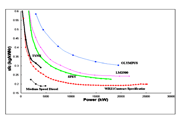

What do you mean, diesel versus turbine efficiency?
SFOC curve of gas turbines is not linear, there is a reason why we have combined propulsion units instead of a single engine to do it all. To operate engines most efficiently at two desired RPM and power output. At cruise speed (maximum range) 2 50 MW GT would consume more than 4 25 MW (according to the given graph) thus lowering the available range.
There is also LM6000 (however i doubt if it is for military use) and Navies would have opted for this if they needed less engines.
Turbines work with their best efficiency between 90% and 100+% throttle but for some reason the UK went for a twin RR engine. Probably because it is UK made instead of American. Same applies to us if we can have our own engines we can mix and match as we wish. Smaller engines with large engines and diesel with turbine. We need to make marine diesel engines for whips as well. There was an initiative about it which we haven't heard about in years.
