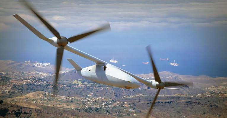

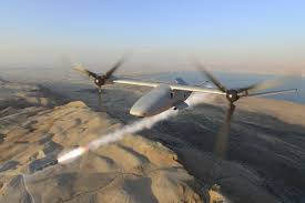

Gyrocopters, VTOL aircraft, ballistic parachutes, seaplanes, floatplanes, helicopter based UAVs, all should be considered. Maybe we should not obsess with deck based UAVs only.
