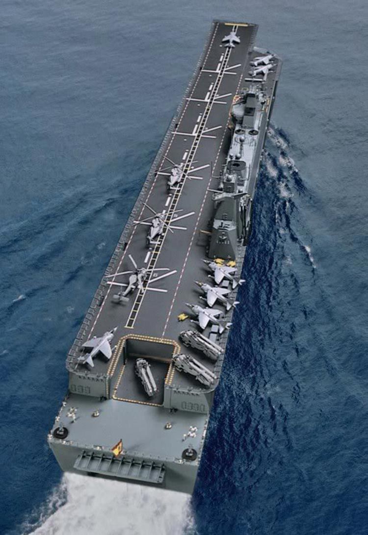

These are technical details that can be solved (by using for instance 2 different arresting systems, one for Hurjet, one for drones)
Hurjet and Harrier have approximately same size, just to have an idea the picture below
Interesting :)
Hurjet has more wing area and about roughly the same amount of thrust too - Hurjet with composite build, will weight a heck of a lot less. To me it seems feasible, TAI - god damnit - make it happen.
