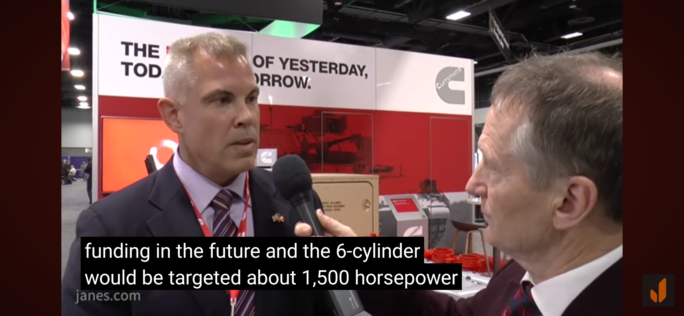

Guys opposite free piston engines are coming for US Army.
( one cylinder two pistons)
Most probably US army next gen MBT will have this.
ACE’s innovative OP technology provides a 50% increase in power density, a 20% reduction in heat rejection, and 13% improved fuel efficiency when compared to today’s best in class combat engine. ACE’s flexible layout options allow the engine to be configured in 3 cylinder, 4 cylinder, and 6 cylinder arrangements to deliver power ranging from 750 to 1,500 horsepower. ACE can be integrated into hybrid architectures enabling commonality, thereby eliminating the expensive logistical burden of having multiple combat powertrains and facilitating the incorporation of new electrified technologies.
Conventional v shaped 15liter diesel engine produces 750hp.
But this box shaped 10liter engine produces 1000hp!!!
With Cummins Again Achates company!
Could we see this engine as generator in future electric MBT?
25%fuel efficiency
25%heat reducing.
Mate, at least let us master the diesel engine for Altay first before coming up with future possibilities of an electric tank.
We seem to be solving outdated problem." Conventional diesel ICE , transmission, Powerpack " those are our current problem right?
Especially we are in trouble with transmission which is today totally outdated. We are in the new electric ERA. Electric motors don't need transmissions which causing power losses.
We should try to copy and transform Ukrainian TD-6 engine which is identical to free opposite piston engines. It would be generator of Altay. That's all. Easy. All problem is solved.

I am hundred percent sure Abrams X will have this technology. Sonra bizde kafamızı dikelim niye Ukrayna motorundan istifade etmedik diye.
There isn't a single electric motor powered tank right now, and even the one that is most likely to be cutting edge, Abrams X, will run on a diesel-electric hybrid engine. We are solving todays problems with todays reliable and proven solutions as we cannot afford a mistake or misstep.
We are trying to solve the problem which doesn't exist.
Tank transmission?? Peh.
Cummins already supplied those engines. We are looking for trouble.
We must create an electric motor for Altay! not a transmission!!. (Engine) generator is ready from Ukraine.
Mate, you're the one trying to solve a non-existent problem, in multiple threads with multiple posts for some reason. You do realize that the engine you're giving as an example that "we're looking for trouble" will be working with transmission, ACT-1000, right?
Cummings' engines has a different technology than what we are going with Batu but it is still a diesel engine. US has two new programs one is for a new MBT and another for armoured vehicle and both are going to be either diesel or diesel-electric hybrid. Completely electric MBTs might be a thing in the future but we need solutions right now.
Our companies have experience in various diesel engines and the infrastructure and knowhow is there for Batu. To make a electric engine that might be able to power a tank as heavy as Altay reliable we would need to start from ground up. From designs and development to facilities to build and test them it is a far too long process for a tank that is already delayed way too long. And not just that, you want us to rely on a foreign engine while we wait for all that process to complete.
What we are doing is the most risk-free way of getting what we need, an engine that we know how to build and that we can use on other platforms for a long time while we look for other technologies. And I am absolutely glad that we are not considering even more delays just to jump onto the next big thing .

If someone could explain why should we prefer investing and developing in a mechanic transmission (plus less fuel efficient heavy big engine) rather than hybrid electric drive , i will quit.
Moreover next 30 years we will have to maintain those transmission and engines.
Series hybrid IFV!!
