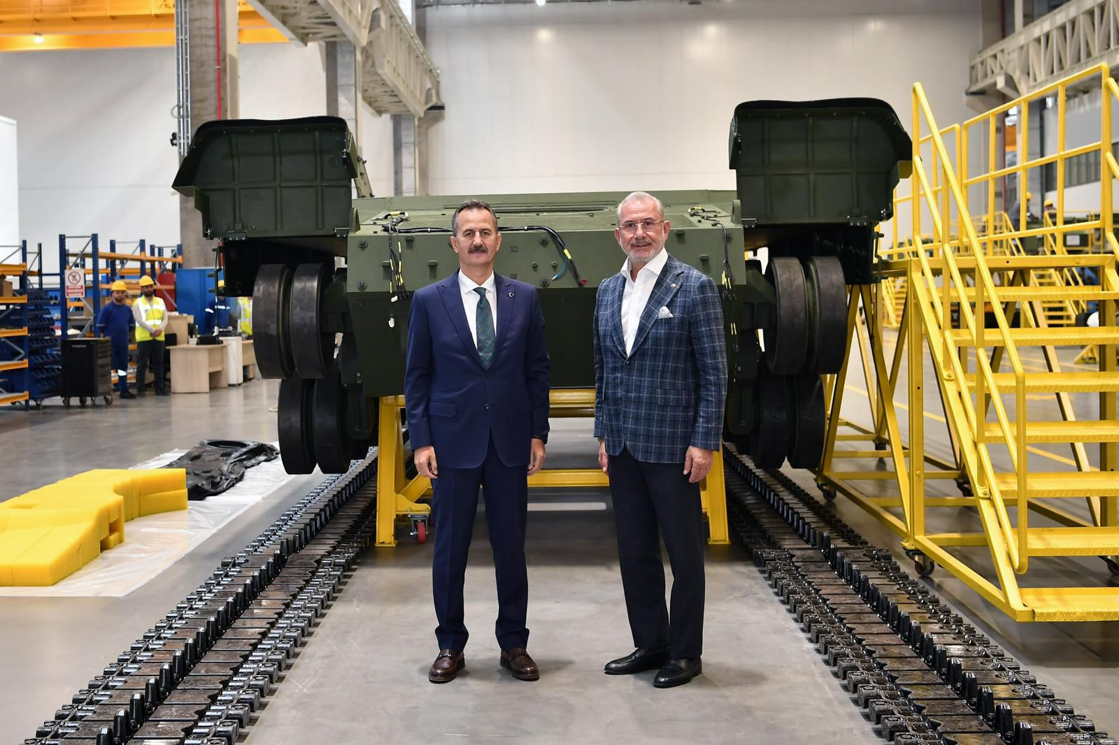

It means BMC is blatantly lying. We have photo evidence. They are not isolated ammunition racks. The first 40 tanks will probably be delivered without those capabilities in line with existing plans.
What they are saying is partially true because the ammo racks in the turret are isolated also that picture is more than 5 years old
Can you please enlighten us why/how that one picture proofs your point? How did you determine from that picture that it won't be in the final product? Which mechanical parts are missing from doing it? Why can't it be added further down the production line?
Ammo racks on the turret being isolated is a 60 year old design, that's not the point of the discussion. Photo was shared today by Güngör's twitter account during his visit to the factory.
All of it. There's nothing to argue here. We knew for 6 years that T1 would come with open hull stowage. An isolated stowage would be isolated, it's not an add-on.
So are you saying that isolated rack is a whole module which has to be assembled outside of the tank and then put inside the hull as a whole module?

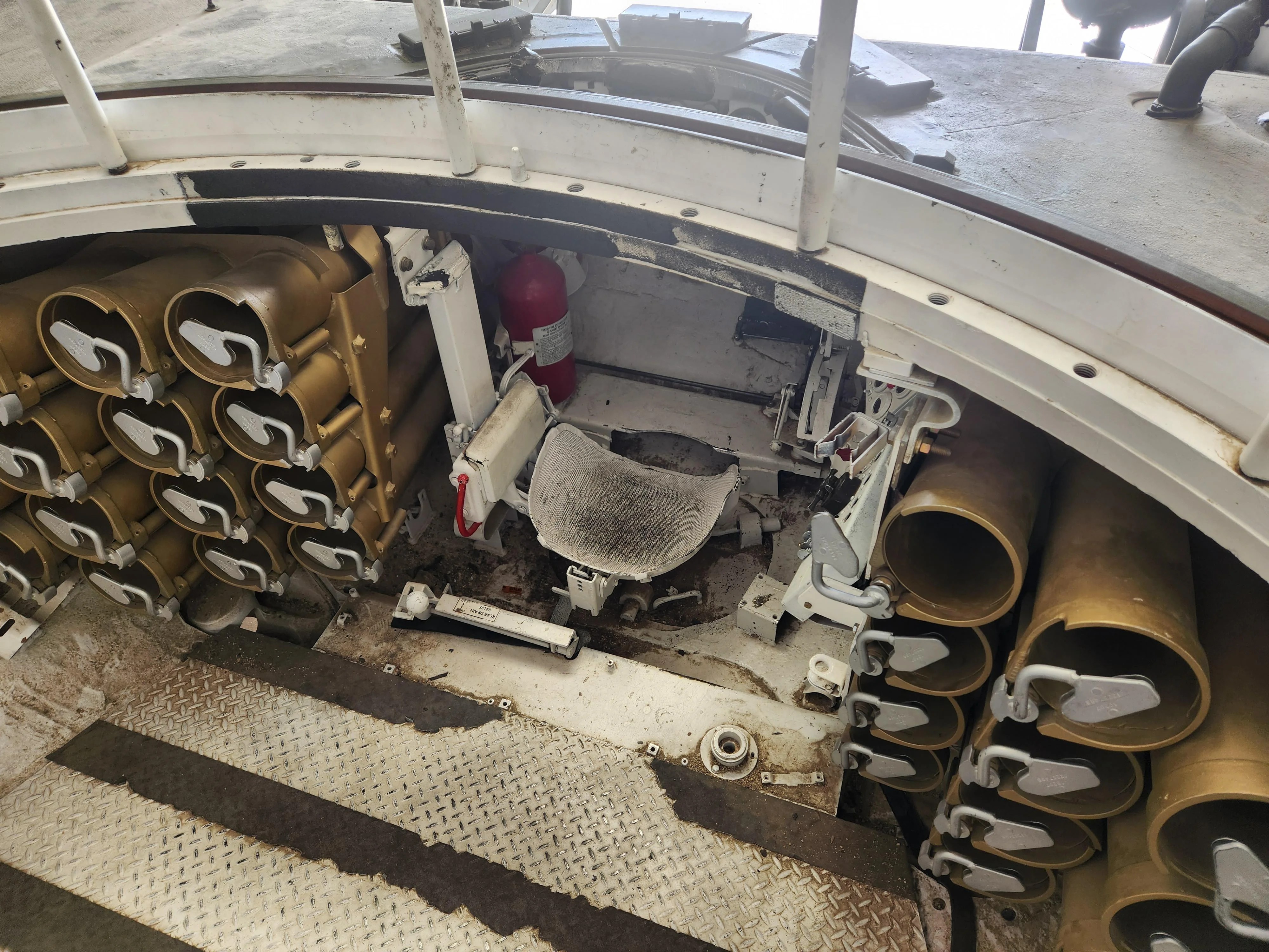

Yes. This is how it looks on M1, though M1 carries most of its load on the turret:

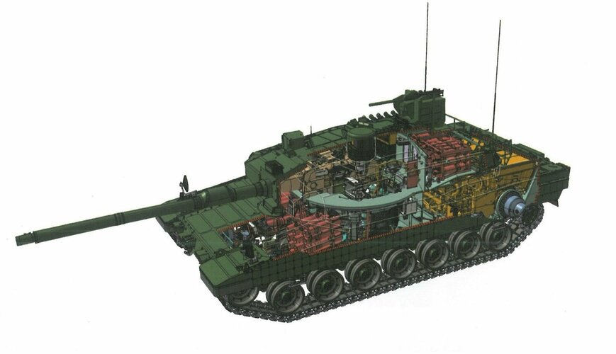

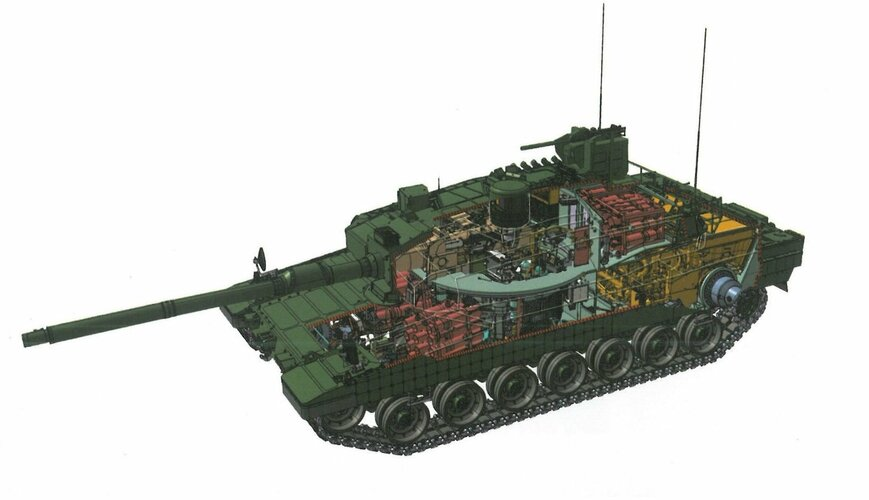

Im not denying that i meant the graphic that was shown about the program development is a old picture
But still mostly up to date.

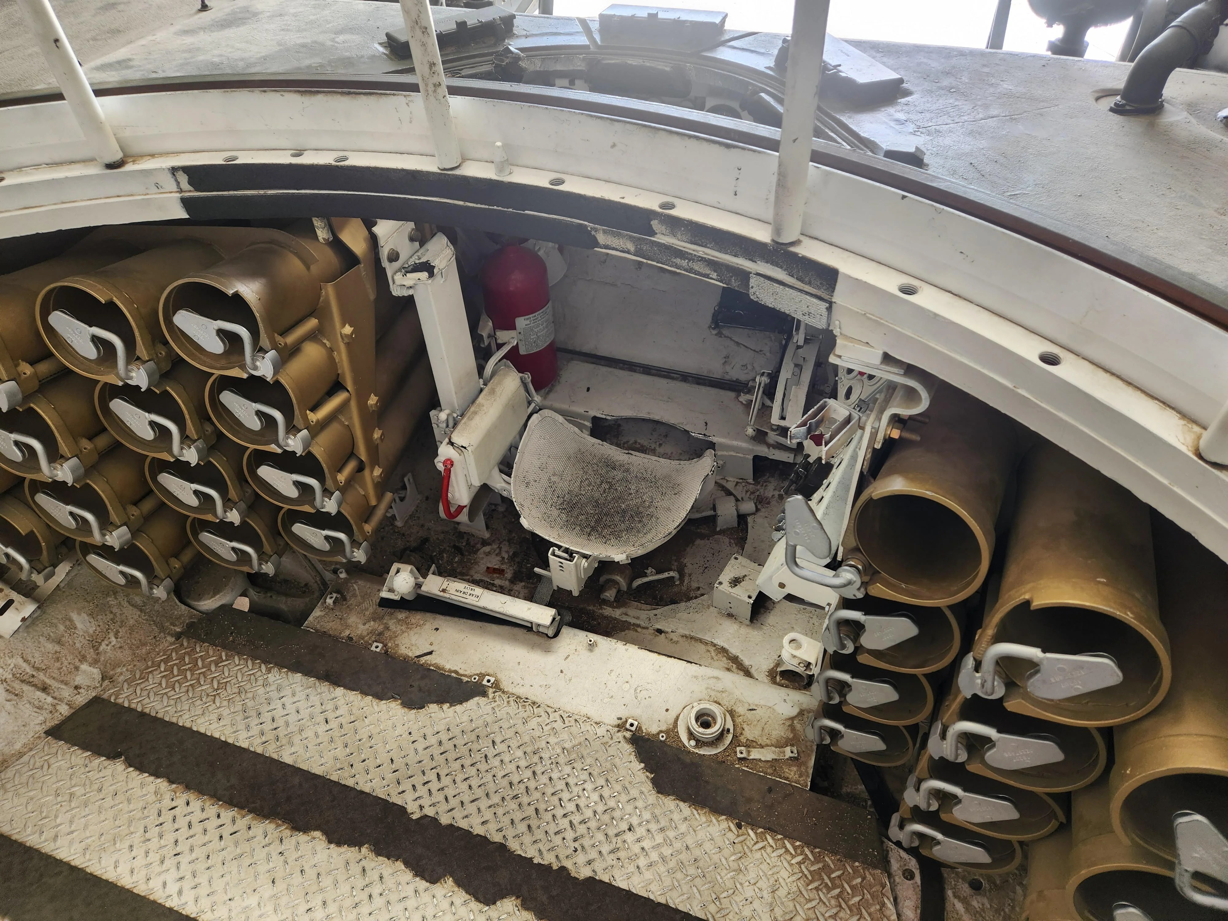

That's what they said, but the photo from yesterday shows they did fuck all. This is M-60s ammunition storage, does that look all that different to you?
I just want to understand why that photo from the assembly line indicates that it won't have isolated hull ammunition racks? What in that photo indicates that it will stay the same all the way until the end of the assembly line? According to @Sanchez it had to be installed as a whole module, but i am not statisfied with that answer. Like why, only because it was done by other manufacturers or what are the limitations to do it that way? I don't give a fck about BMC.
An isolated rack is a whole module. Tank's internal design must be fitted to it. It's not an add-on or something that can be modernized into an existing design easily. Germans only did it with the Leo2 RC 3.
Altay T1 doesn't have it, T2 will. It doesn't have it in T1 because our army saw Leo2 as the pinnacle of tank engineering, a 50 year old design; so it was seen as a not that important of an upgrade. Then our Leo2s blew up in Syria.

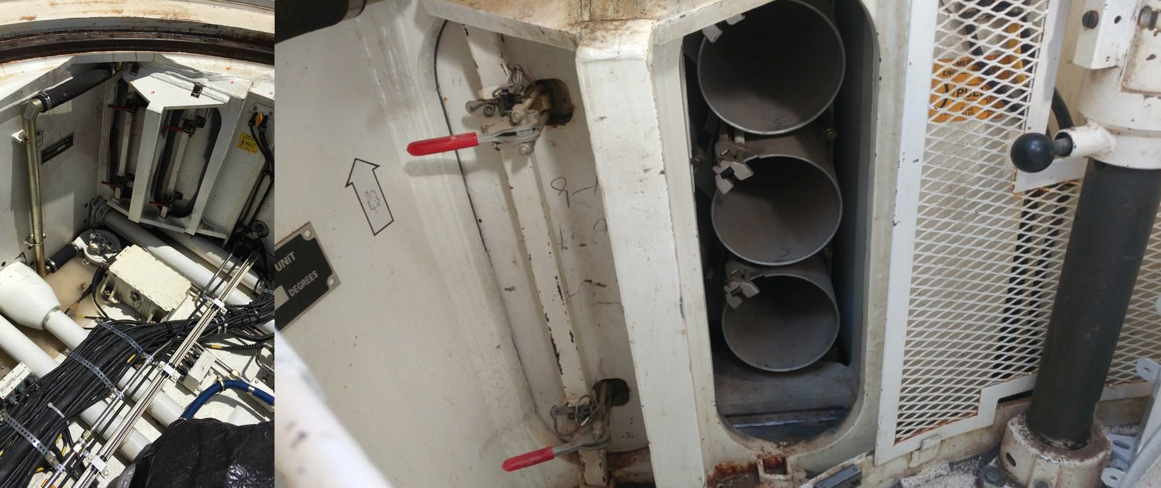

What are you talking about mate? The photo is literally from the tweet from yesterday, shared by SSB president:
Here it is from a different source, and below is the full photo. This fits with what was on that board.
G2V-EcRWUAA8cg9
One must not forget. ALTAY is largely based on K2. In the K2, the ammunition storage is also to the left of the driver.
It was anticipated that in the ALTAY T1, 12 shells would be stored on the right and left of the driver, respectively. But in the picture, we see 10 slots on the right and left. The rectangular empty slots (4 pieces) should make us think about whether these gaps are planned for countermeasures for possible fire suppression systems?
