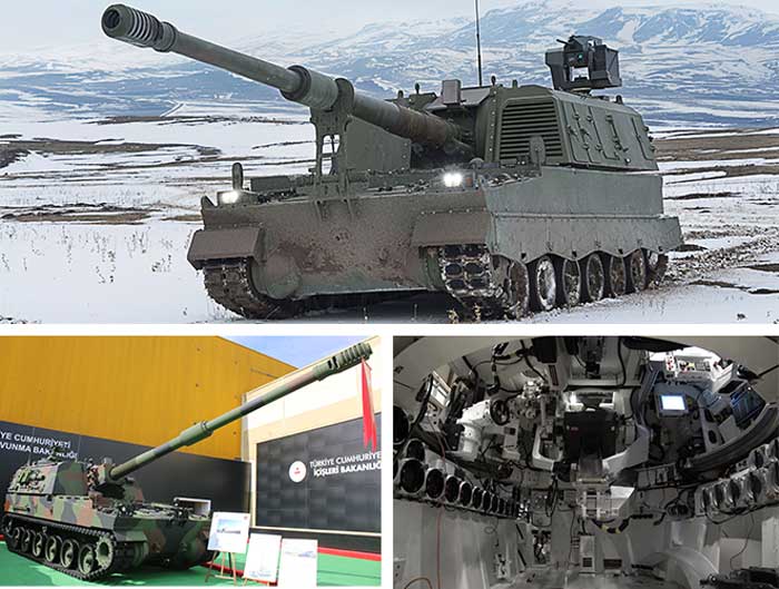

Firtina II Procurement Retrospect.
03/2020
Agrrement with L3 Harris for the AVDS-1790 Engines and Serial Production start at Arifiye.
12/2020
Initial Batch of 3 Firtina II were Produced
06/2021
3 more were delivered until June 2021.
Until 06/2021 BMC (ASFAT) have produced 6 Firtina IIs with MTU 1000HP Powerpacks used from Stocks at Arifiye Plant.
Interview from 04/2021
Muhsin Dere, Deputy Minister of National Defense:
"In Cooperation with BMC Defense We plan to take 140 T-155 Self-Propelled Storm Howitzers into the inventory between 2022-2027."
"The production of 3 New Howitzers was completed in December 2020, and it is anticipated that 3 more will be completed by June 2021."
> Production Line will start again some time in 2022.
News from 06/2022
53 AVDS-1790 Engines in 2022, From June to December.
If the Production of 140 Firtina II is supposed to be between 2022-2027 than this faster than needed.
140 Firtina II in 5 Years equals 2 per Month.
53 Engines a 2 Howitzer/Month = 26 Months
> Production until at least 07.2023 with AVDS-1790 Engines,

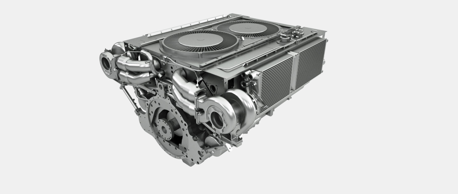

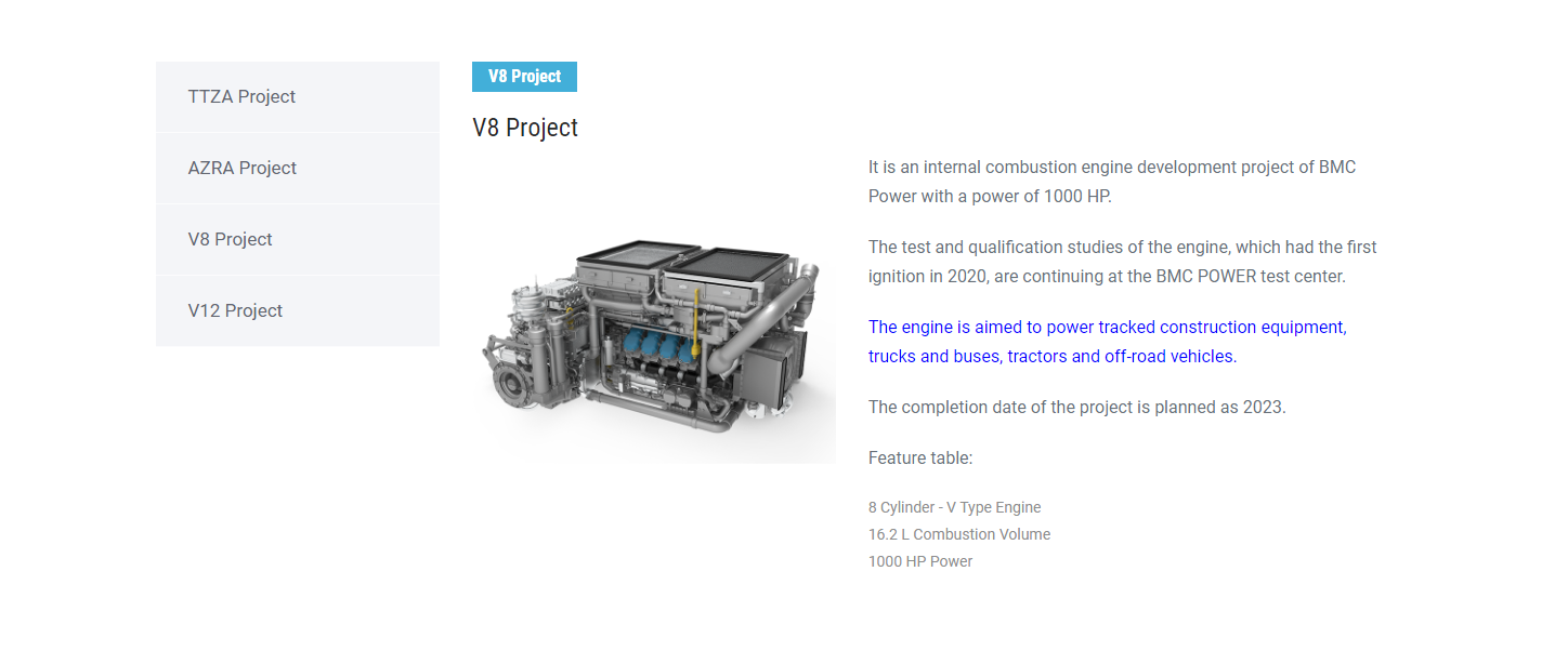

BMC Power 1000HP was stated to be completed in 2023.
Including Tests and Optimizations this will likely take till late 2023 early 2024.
We may see the switch to the National Powerpack around 2024
