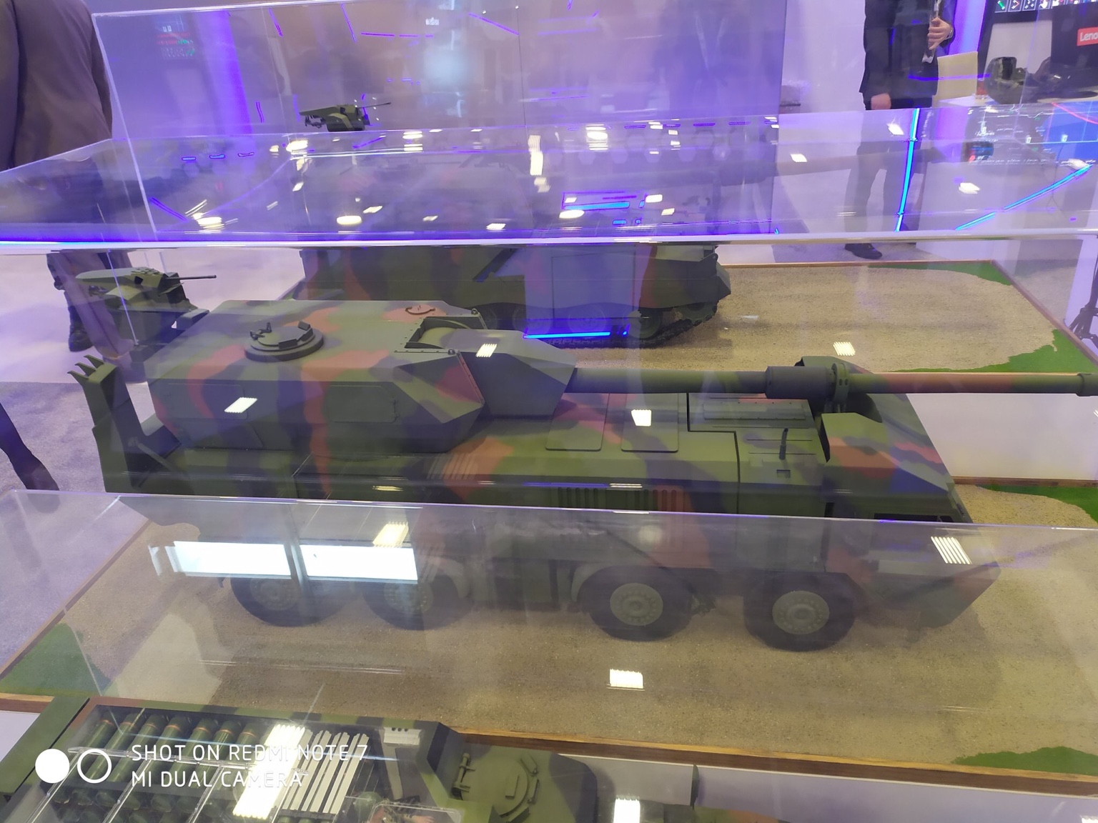

I dont like MKE Yavuz because its semi-automatic if we are gonna make truck based howitzer we should make it comparable to Archer , fully automatic enclosed turret.
Archer
In fact when first MKE Yavuz news come out Aselsan released an intent to make similar truck howitzer but that one fully closed turret(therefore full automatic).We should go with Aselsan's concept.Be it lowering personel number level or faster response time Archer concept would be superior.Not mention we could steal Archer's export customers.There are many trucked howitzers like Yavuz in arms market but there is only one Archer and Sweden wouldnt sell this system to countries outside Western Europe easily.When we wanna export Yavuz tomorrow it will always defeated by its Chinese counterpart , we are making a huge mistake.
Here found photo on PDF shared by @Hexciter
Aselsan's truck howitzer

This was T-155 Panter
Panter was actually the name of this towed howitzer produced during early 2000s now its became howitzer's name .BTW same 155 MM 52 caliber howitzer also used for T-155 Firtina tracked howitzers.Like other members said there was a flaw found in T-155 Panters after some units produced and production stopped.Last we heard Aselsan was gonna fix this flaw and make T-155 Panter good again but no news ever surfaced again(probabaly they abandoned it).Now MKE putting same howitzer into truck calling it Yavuz.
MKE Yavuz
Archer
this concept looks amazing!
