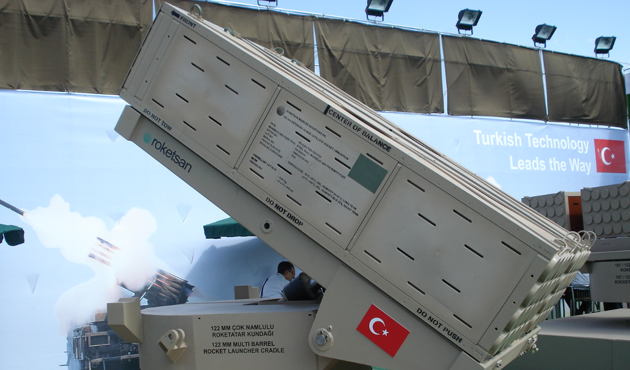

In September, the Turkish munitions producer Roketsan introduced a satellite-guided artillery rocket for use from its T-122 Sakarya multiple rocket launcher system (MRLS).
This new rocket – named TRG-122 – is derived from the 122mm TR-122-line of rockets, specifically the extended-range variant – which is capable of covering a distance of 40 km. According to IHS Jane’s, each TRG-122 weighs 72 kg (including an 18.4 kg high-explosive or fragmentation warhead). The customer has the option to supplement or supplant the GPS-based seeker with GNSS. The TRG-122’s accuracy is set at <50 m circular error probe (CEP). Roketsan hopes to have the TRG-122 ready for orders in 2017.

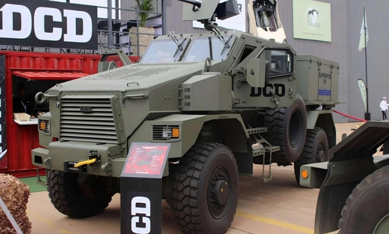

ASELSAN’s original design, the ALKAR 120 mm Mortar Weapon System provides high mobility and precise firepower.
It was seen on a South African armoured vehicle this month

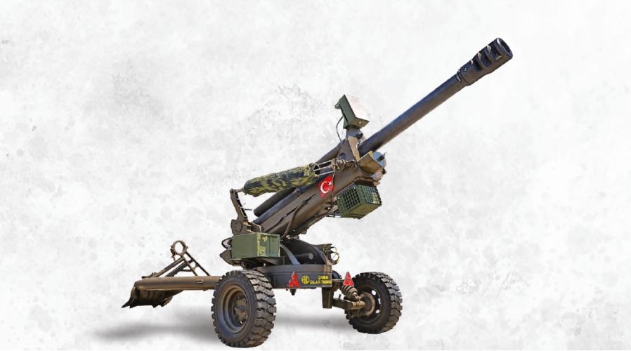

North Macedonia announced that three batteries, that is, a total of 18 BORAN Light Towed Howitzers, will be received from Turkey in the first quarter of 2025.
