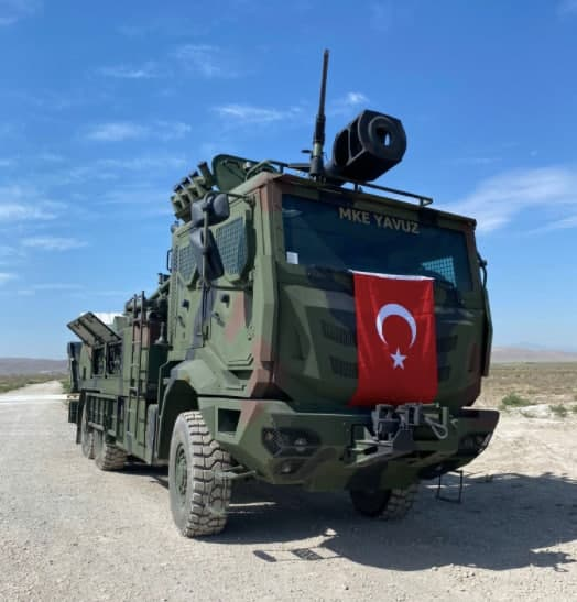

T-155 YAVUZ Howitzer developed by one of our members YOL-BAK company with MKE Institution successfully completed the field and firing tests.
In the tests carried out in the second half of May 2021, the T-155 YAVUZ delivered 6 consecutive shots to the target with a deviation of only 1 meter.
YOL-BAK: weapon and fire control software, all engineering activities including the superstructure, armored double cabin, all the hydraulic system including the software, analyzes and designs were completed in accordance with all military standards.

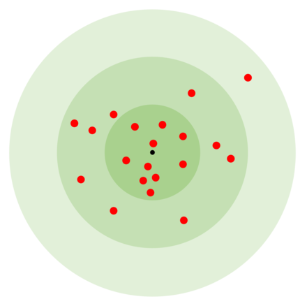

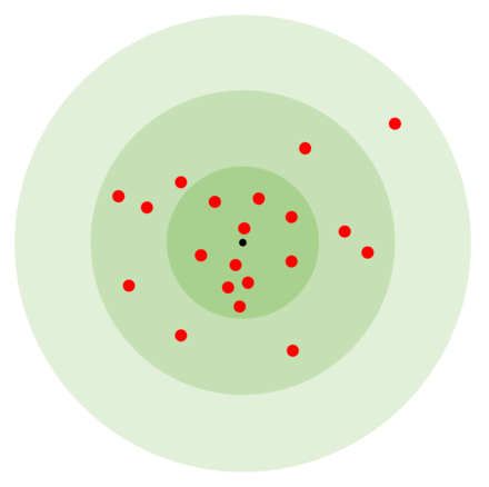

Can anybody believe that statement? “ 6 consecutive rounds delivered with only a deviation of 1m. “ ?
Even Excalibur shells are not that accurate!
Whoever wrote that article needs to get his head examined.

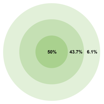

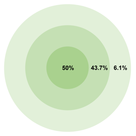

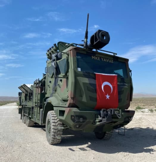

Even with the new ”Mesafece duzeltme system” that Roketsan has introduced they only managed better than 30 metres CEP. (The stated CEP of this system is 50m.) If our artillery systems are so accurate why does Roketsan bother with range correction kits for artillery?
50m CEP means : 50% of rounds will end up in the darkest green central area of 50m radius. Some may be as far as 150 m away from the very centre, where the target is.
Bottom picture shows a 20 hits distribution.
They didn't claim a CEP of 1m. CEP is a statistical guarantee and is given at maximum range. 6 shots in 1m at an unknown range just means the Yavuz is very accurate in those firing conditions.
CEP is also usually overstated. See for example the CEP spec of MAM-L and compare that the the accuracy shown in the hundreds of videos we've seen (<1m).
