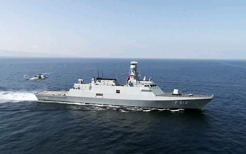

The Turkish defense industry made a bid for the Heavy Missile Patrol Ship (LPC) Tender of the Bangladesh Navy with MİLGEM ADA Class Corvette and ATMACA Anti-Ship Missile.
Bangladesh launched a tender for the procurement of large-type patrol ships (LPC) equipped with 8 Anti-Ship Missiles (AShM) in response to the needs of the Bangladesh Naval Forces Command. According to the Bangladesh press; Held on 26-28 October 2020, the online date 6. Defense Port Turkey during the event, Turkey's ADA ATMACA Anti-ship cruise missile equipped with a tender was announced to offer with Class Corvettes.
According to the information obtained; The Bangladesh Navy has shortlisted the ADA Class Corvette and the ATMACA Anti-Ship Missile System. Bangladesh wants the ships to be built in domestic shipyards.
Four ADA Class Corvettes, which have been produced for the Turkish Naval Forces Command so far, draw attention especially for their submarine defense warfare (DSH) capabilities. The first three of the ADA Class Corvettes have the US production Harpoon Block II Anti-Ship Missile, while the last corvette, the TCG KINALIADA (F-514), has both the Harpoon Block II and the Roketsan ATMACA Anti-Ship Missile, developed with domestic facilities. Mass production ATMACA deliveries to the Turkish Naval Forces are planned to begin in 2021.
In addition, construction activities for Pakistan of four warships (Jannah Class Frigates) similar to the ADA Class Corvette design continue. Two of the four corvettes in Turkey and two in Karachi Shipyard / being produced in Pakistan.
On the other hand, the construction activities of TCG ISTANBUL (F-515), the first frigate within the scope of the MİLGEM I Class Fırakteyn project, which is a continuation of the MİLGEM ADA Class Corvette Project, continues.

@anmdt posted some Corvette designs in another thread that looked pretty awesome too for BDN.
Yes but probably Ada class will be offered as-is.
I wonder if gas turbines will be delivered too. It would be nicer to see actual requirements to make comment on it.
Especially Durjoy class is classified as LPC (65 meters 650~tons), It is a great opportunity to push for alternative and smaller designs of Milgem (of 78-85 meters length ~1200-1600 tons) to meet their needs in smaller sizes.

C1200 (Corvette 78) fits perfectly to all requirements:
Main gun can be replaced with 30 MM stop, Gökdeniz CIWS might be added, there is space enough for all.
Length (OA)78.00 m
Length (WL)74.37 m
Beam12.00 m
Draught (design)3.00 m
Displacement1200 t
Max Speed+27 kn
Max Cont. Speed15 kn
Economical Speed15 kn
Endurance3000 nm @ 15 kn

Only C 78 (1200 tonnes variant) is available at the website but so far it suits to all needs:

Ada-class looks like an overkill for given specs, probably this ASuW variant by TAIS has been tailored for Bangladesh along with newly introduced OPV class & LPC class: Also showcased in SAHA Expo without any names given
1x Smash
2x Stamp
Smart-S / Mar-D
AKR-D Block A1
1x RHIB
8x AShM
Tonnage is given as 660 for standard, in full load exceeds 700,
All but range and endurance fits to the requirements in RfP;
Range is given as 1500 NM at 19 Knots, in excess of 2000 NM at 14-15 Knots (not available on paper)
