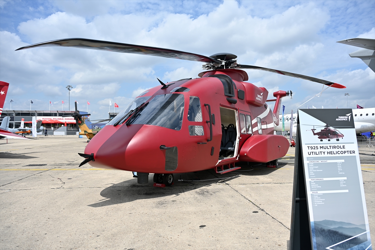

This is T-925:

Sorry guys but may some1 remind me what was the difference between the T-925, T-929, and T-625 again as I completely forgot😅
edit. Deleting the photos as Heartbang also added them.
T625 Gökbey is a 6 ton general use helicopter similar in size to AW169, H160 and Dhruv
T629 also known as "Atak 1.5" is a 6 ton attack helicopter using the same engine and transmission as the T625. It will be a bit heavier than T129 Atak and much more capable, and fully Turkish unlike T129.
T925 is a 11 ton general use helicopter similar size to Sikorsky S-92 and Eurocopter Caracal or Super Puma.
T929 Atak 2 is a 11 ton heavy attack helicopter using the same engine and transmission as the T925 and is similar sized to Ka-52.
