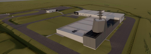

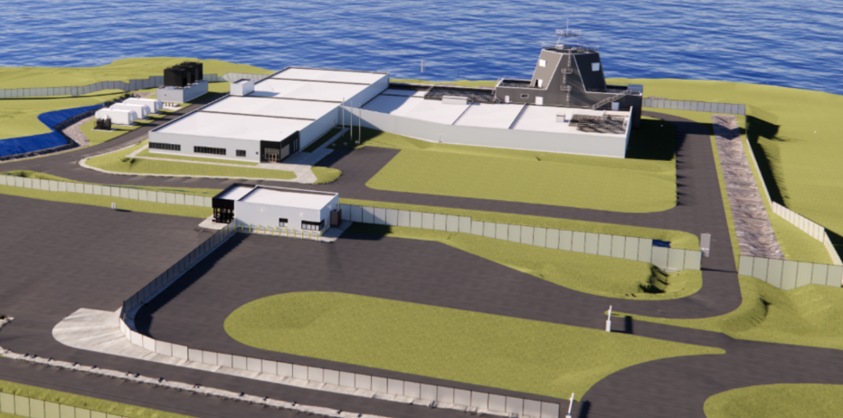

The Trident news (online) has an article on a test facility build in support of the River Class Destroyer:
River Class Destroyer Land-Based Testing Facility
The Department of National Defence (DND) is building a Land-Based Testing Facility on a portion of DND-owned land at Hartlen Point in Eastern Passage, Nova Scotia.
Construction timeline update
Construction of the River Class Destroyer Land-Based Testing Facility (LBTF) will now take place at Hartlen Point in Eastern Passage, Nova Scotia, between summer 2025 and fall 2027. This includes building the facility and supporting infrastructure such as security fencing, parking lot, roads, and utilities. See the most recent rendering of the LBTF below (Figure 1) for reference. Although construction is expected to be complete by fall 2027, timing is subject to change based on the progress of the design and construction processes. Updates will continue to be provided as new information is available.
The article is fairly long, so I won't copy and paste it all here.
Hello "oldcpu". Yes, the LBTF is coming along much faster than our CSC River Class Destroyer build!!

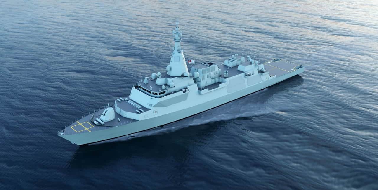

The Government of Canada has awarded a contract to Irving Shipbuilding Inc. (ISI) for the construction of the River-class destroyers, a new fleet of warships based on the UK’s Type 26 design.​
The deal, worth an initial $8 billion, will fund the construction of the first three ships, with a total estimated programme cost of $22.2 billion.
The River-class destroyers will replace the ageing Halifax-class frigates and the long-retired Iroquois-class destroyers, providing the Royal Canadian Navy (RCN) with a multi-role combat vessel capable of high-intensity warfare, intelligence and surveillance, counter-piracy, counter-terrorism, and humanitarian assistance.
Based on the BAE Systems Type 26 Global Combat Ship, the River-class destroyer follows in the footsteps of the Royal Navy’s City-class frigates and Australia’s Hunter-class vessels. However, Canada’s version will include enhanced underwater sensors, state-of-the-art radar, and modern weapons systems to meet the country’s unique operational needs.
“By investing in our own industry, Canadian workers are helping to build the fleet of the future, equipping the Navy and our members in uniform with the modern and versatile ships they need,” said Bill Blair, Minister of National Defence.
The first three ships will be named:
  • HMCS Fraser (Pacific Ocean)
  • HMCS Saint-Laurent (Atlantic Ocean)
  • HMCS Mackenzie (Arctic Ocean)
The River-class programme represents Canada’s largest shipbuilding project since the Second World War and is expected to support over 5,250 jobs annually while contributing $719.3 million to the country’s GDP.
The construction will take place under Canada’s National Shipbuilding Strategy (NSS), with Halifax-based Irving Shipbuilding Inc. leading the project. Canada is also investing $871.7 million in shipyard infrastructure to support the new fleet’s long-term sustainment.
“This contract validates more than a decade of hard work by industry and government and provides stability for the men and women who design, build, and maintain Canada’s fleet,” said Dirk Lesko, President of Irving Shipbuilding Inc.
