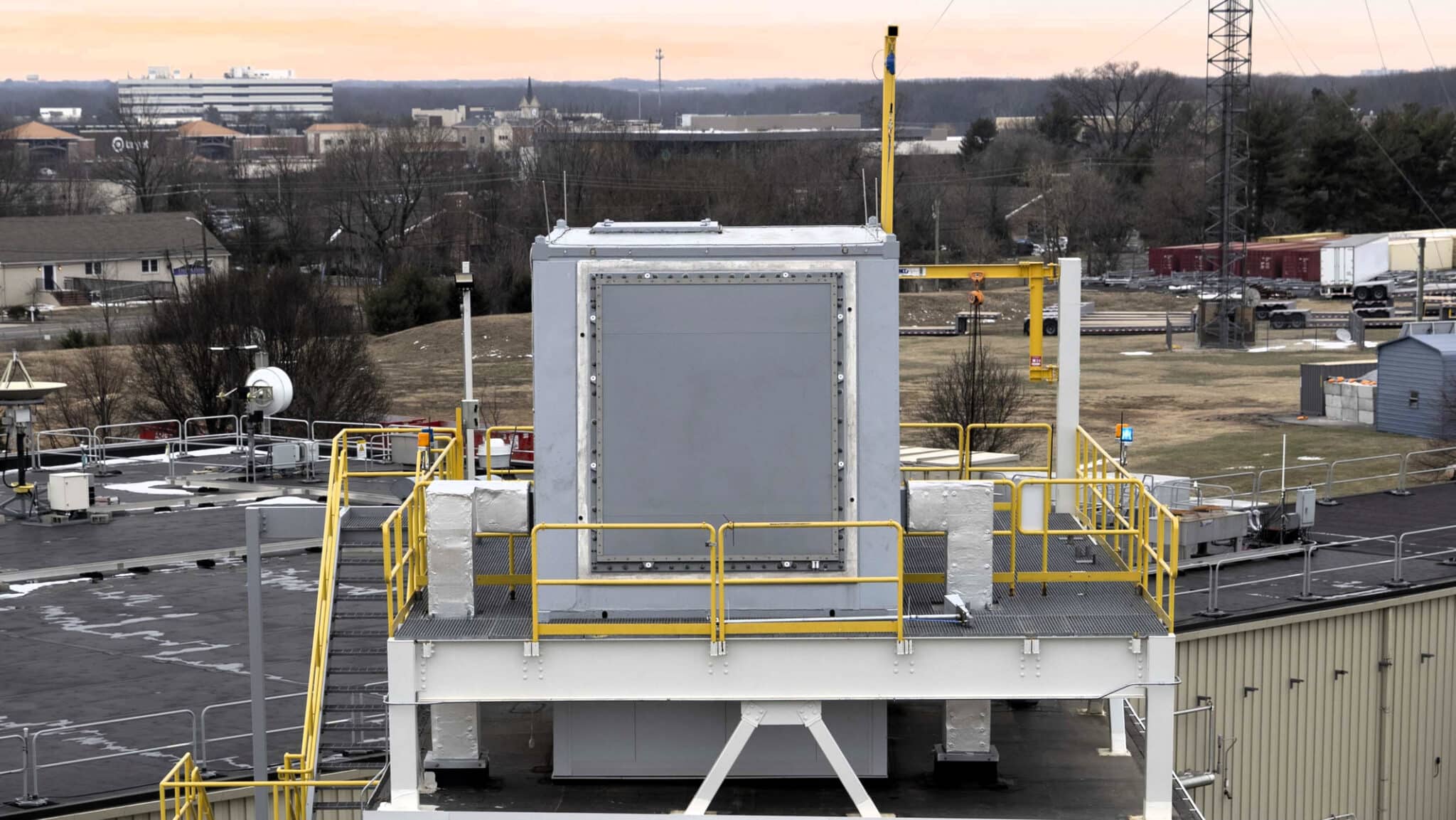

There is a post on the "Royal Canadian Naval Alumini" page about the River Class and early activity starting in regards to the Aegis Combat System (ACS) Integration Center:
I suspect one may need a facebook account to read the link:
so I copied it below:
Another chapter complete in preparing for our future River-class Destroyers!
Within the United States Navy’s Combat Systems Engineering Development Site (CSEDS) is where you can now find our Aegis Combat System (ACS) Integration Centre. Its unveiling took place on November 21st; Rear-Admiral Charlebois, Director General of Future Ship Capability, had the privilege to unveil the facility which is where the River-class Destroyer’s ACS software will be developed and tested.
The activation of this facility at CSEDS is an important milestone for our Navy toward the ultimate goal of delivering the River-class Destroyer to Canada. Once the software is developed, it will be delivered to the Land Based Test Facility in Halifax.
The AEGIS weapons system is part of the ACS for this new class of warships for our future fleet, and is responsible for the ship’s integrated air and missile defence capability - it will provide blanket air defence for an entire Task Group. Furthermore, the RCD ACS will enable the RCN with a pan domain combat capability.

There are a couple of recent articles in Naval News about the SPY-7 radar, where that is the main air-search radar planned for River Class Destroyer.
The following Naval News article is entitled "Live Track Test Demonstrates SPY-7 Capability and Scalablity".
It refers to a successful live radar track test of the AN/SPY-7(V)2 radar, which is the more precise variant planned for the Spanish Navy's new F-110 Bonifaz class frigate. Purportedly a satellite target was tracked in the test, and also a commercial aircraft has been tracked with the system.
The article notes: "Alongside Spain’s F-110 frigates receiving AN/SPY-7(V)2, the AN/SPY-7(V)1 system will be fitted on Japan’s two Aegis System Equipped Vessels (ASEVs), and Canada’s River-class future destroyers will carry a combat system combining AN/SPY-7(V)3, Aegis, and Lockheed Martin’s CMS-330".
I haven't found an article yet that explains the differences between the AN/SPY-7 (v)1 (Japan), vs the (v)2 (Spain), vs the (v)3 (Canada). I assume there is significant commonality between the radars and a lot of the verification for the (v)3 variant (for the River Class destroyer) could be 'by similarity' with the (v)1 and (v)2 variants.
EDIT: Looking at some old notes of mine I read that the v(3) may have a target illuminator built in ... but I did not write down my reference for that so i don't know if that is accurate, as i can no longer remember. Further, I also have vague recollection that MDA were providing a target illuminator. I don't know the facts here.
Also of interest was the emphasis that the SPY-7 software can be upgraded without hardware changes needed, which is useful as threats evolve. This (upgrading software capability) was purportedly shown by the US navy operations against Houthi rebel air and missile threats to the Red Sea shipping off of Yemen. Purportedly Aegis software updates were provided within 24 hours.
The other 15-January-2025 news was : Lockheed Martin Delivers First ASEV AN/SPY-7(V)1 Radar Antenna to Japan

Hello "oldcpu". Yes, I saw those articles from LM on the SPY 7s as well. This is a very powerful and "scalable" radar that Canada is acquiring for the River Class Destroyer. The RCN insisted on this radar from the beginning. A great choice! LM also asserts that the SPY 7s will be even more capable and out-perform the Raytheon SPY 6 radars now being installed on the AB IIIs. I believe the only differences between Japan's SPY 7 (V1), Spain's SPY 7 (V2) and Canada's SPY 7 (V3) designations is the combat systems each radar will be integrated with and possibly the number of Radar Module Assemblies (RMAs) each ship will have. This radar has a built-in Target Illuminator and does not require a separate TI. It seems that the Lockheed Martin SPY 7 is the Radar of the future and will be a powerful Long Range Discrimination Radar (LRDR) for Canada for CEC, BMD & Hypersonic Missile Tracking/Targeting. Having this radar for Canada's River Class fleet will be a "game-changer" for Canada! Cheers!
I was curious and tried to dig into this a bit further.
I could not find any information on the quantity of RMA in any of the SPY-7(v)1, nor (v)2, nor (v3). This is in contrast to the USNavy SPY-6 were a number sources state which class of warship has how many RMA in the different SPY-6 implementations.
It was easier in regards to the combat system differences.
According to different press articles, the Spanish F-110 class frigates frigates SPY-7(v)2 variant will be integrated as part of the Aegis Weapon System, and incorporate the International Aegis Fire Control Loop (IAFCL) integrated with SCOMBA, the national combat system developed by Navantia.
Its posted in many places that the Canadian River class SPY-7(v)3 will also have Lockheed Martin’s Aegis Fire Control Loop (IAFCL) integrated with Canada’s combat management system, CMS 330 (which was developed by Lockheed Martin Canada for the Royal Canadian Navy).
As for the Japanese, I read (albeit I don't know how up to date this may be) that the Japanese government is planning to build their system with the Aegis system (Aegis BL9, called J7 in Japan) and radar (SPY-7(v)1), initially contracted for Aegis Ashore.
Given I believe the quantity of RMA in a radar such as the SPY-6 and SPY-7, is a factor in assessing a warship's sea going stability, I confess I was surprised that i could not locate such. Perhaps it is treated as 'classified'.
