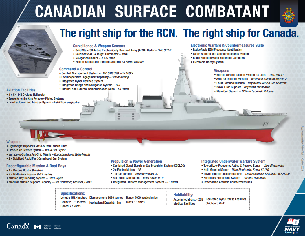

New concept art from LM

Nice image Ted however a 360 degree computer graphic view from LM would be better.
There are all kinds of those pictures and video, its just that they are not released to the public. Just last week I saw a presentation on the CSC, very interesting.

New Graphic from the RCN confirming my prediction of 24 VLS. It still has CAMM VLS with 24 more missiles.
Can you at least tell the forum what "version" of the MARLIN 30 30mm gun did Canada buy? Also, if they have moved the Satcom antennas fwd to around the "new" mast, why could they not then increase the size of the CIAD Sea Ceptor missiles from 24 to 48? There would certainly be enough room for them there either side of the VLS there now and would not be a problem with weight distribution. Just a thought. Cheer!;)
