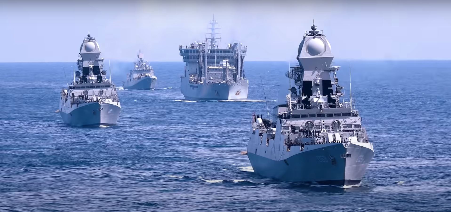

In May 2019, two Kolkata-class destroyers of Indian Navy conducted their first Joint Taskforce Coordination (JTC) exercise where the JTC mode on the CMS-15A Combat Management System (built by Tata Power SED) was validated. JTC is the Indian equivalent of what is known in Western navies as Cooperative Engagement Capability (CEC), where one of the DDGs took control of the Indo-Israeli Barak-8/MRSAM missiles on the other DDG and launched them on a target that the 2nd ship never saw with its own radar.
Now I'm thinking all the ships that use CMS packages of the same calibre (P-15A & P-15B DDGs, P-17A FFGs and also the P-71/IAC-1 carrier) should also be capable of CEC of the type enabled by AEGIS.
India is the 2nd country to fully demonstrate a locally-developed CEC (along with locally-developed data-link) under real-world operating conditions (unclear if the French system was demonstrated or not, if they did, then 3rd):
The INS Vikrant (IAC-1) Carrier Strike Group would be the first truly network-centric & fully integrated carrier group operated by the Indian Navy in its 50+ years of carrier ops history, keeping in mind that unlike most Western carriers, the Vikrant also carries its own set of long-range SAMs and multifunction radar capable of fire-controlling them.

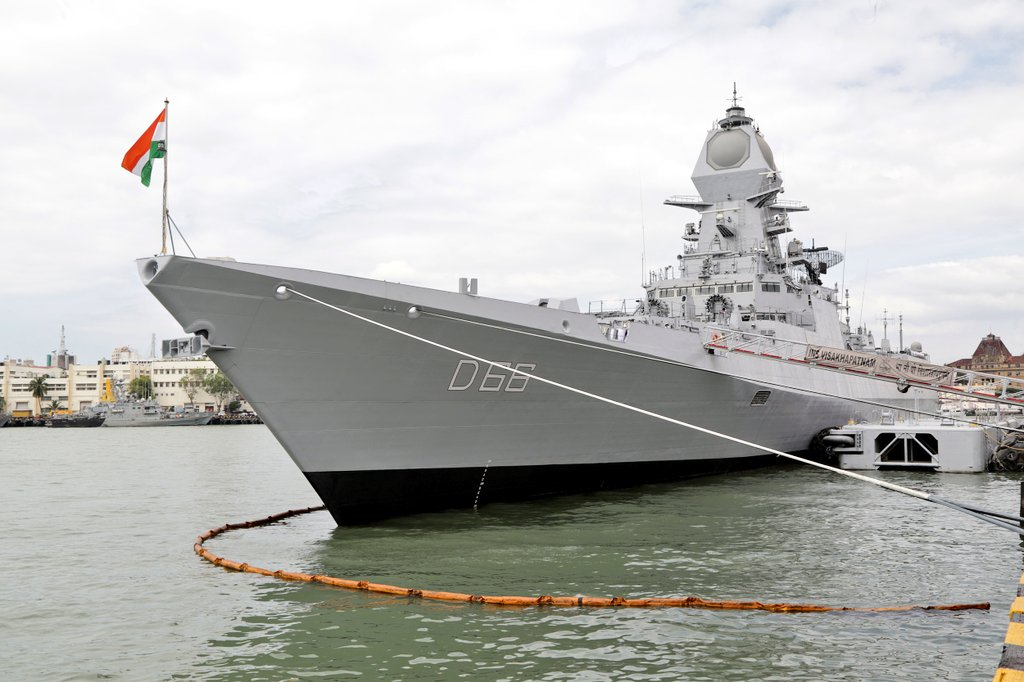

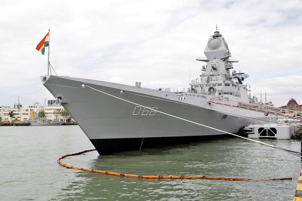

A nice ship for sure, but i have doubts on the stealthiness :) .

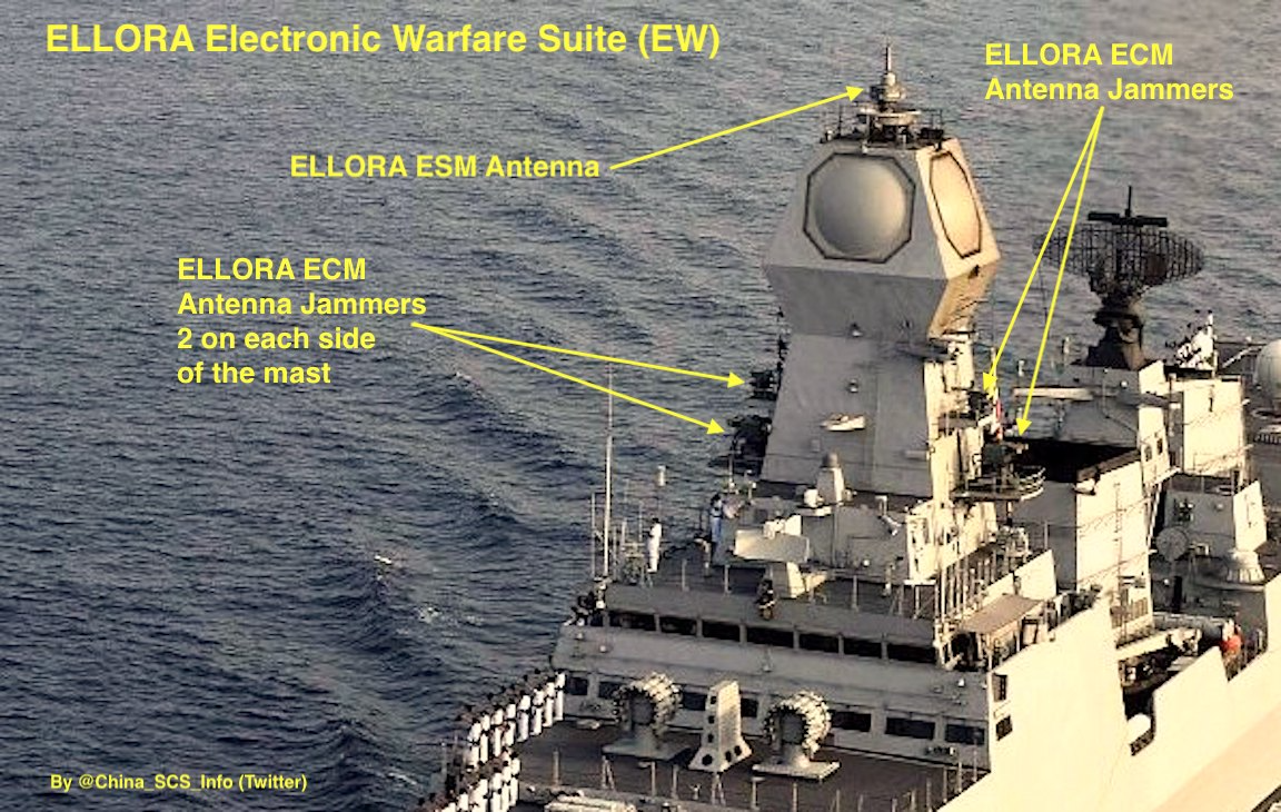

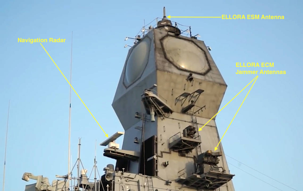

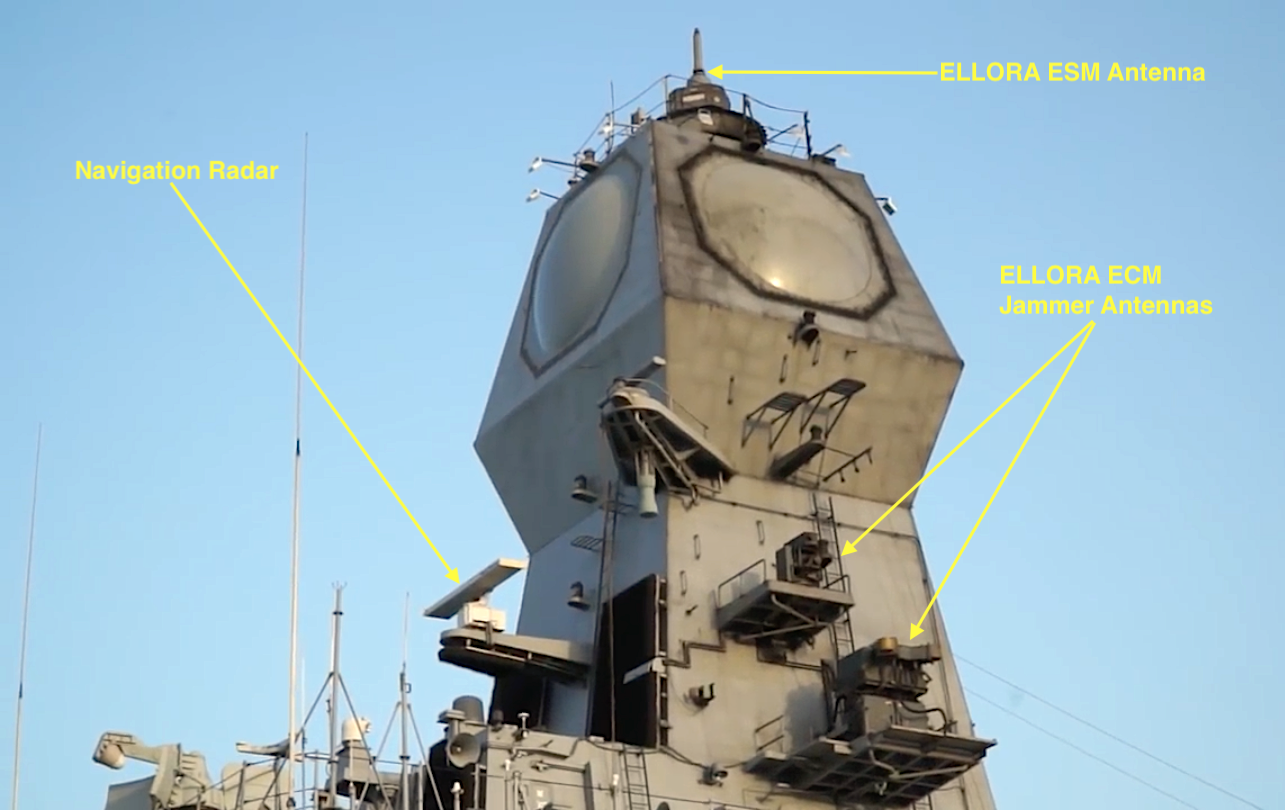

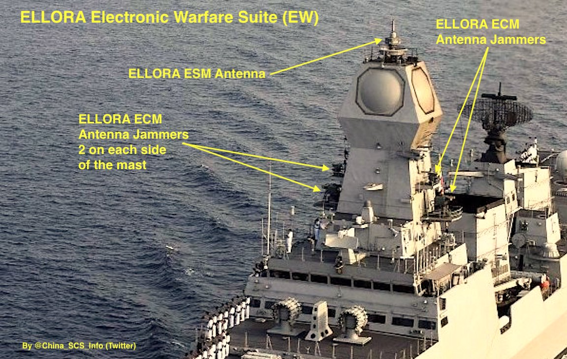

What are those "horns" in an X shape below the radar dome? I noticed them on several modern warships, but...
I think those are struts on mast to house things like the smaller navigation radar antennae and the ELLORA ECM jammers (also found on kolkata class in same way).
Thanks. Interesting that the ship you used as an example here has that X-shaped structure below the rear radar array (one that looks more like a dish antenna).
