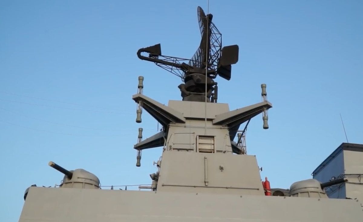

Thanks. Interesting that the ship you used as an example here has that X-shaped structure below the rear radar array (one that looks more like a dish antenna).
Well spotted, that arrangement seems to have been retained overall in the thales radar mast area (from kolkata ---> vizag class)
I think on that "2nd mast", they are some kind of communication antenna array.
The lengths of the antenna subcomponents lead me to think there is both a VHF and UHF combined antenna etc.
How (2nd mast) looks on vizag class versus kolkata class respectively:
A google search brought me these so looks like my hunch was right:

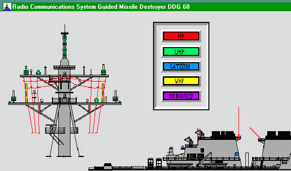

How Arleigh Burke does it:
https://sgfs.sitcdn.com/DG/2021/11/20/Delhi/TDG/5_08/f7bded1c_6211_P_3_mr.jpg https://miro.medium.com/max/2400/0*DFbYe5Ur8b0nnlH6.jpg
https://s1.manualzz.com/store/data/012075167_1-a3b8c579eb9d3a876b91f6a6d1874cb7.png https://s1.manualzz.com/store/data/008380157_1-ea0c2c4e90910736613604fef986171c-360x466.png
