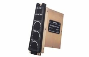

ENGINE INDICATOR DISPLAY:
Compact, platform-specific configurable and user-friendly design, EID unit; It meets user needs and platform requirements for displaying engine parameters, which are critical platform data. With its redundant and reliable design, it will make pilots feel safe even in difficult flight conditions.

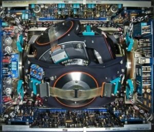

INERTIAL NAVIGATION SYSTEM:
Inertial Navigation System - INS; These are the systems that can produce navigation information and navigation performance information on their own. These systems operate by expressing the response of the gyroscope and accelerometers to the movement with numerical values. Since there is no signal received from any ground station, it is closed to signal mixing sabotage. INS does not need continuous data retrieval after entering the required initial values.

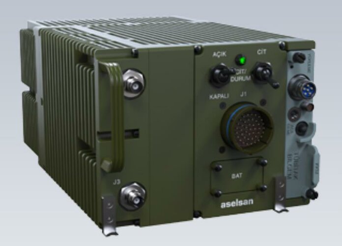

ADVANCED IFF SYSTEM
The System will be able to transmit IFF information to radars as Long Range Interrogator. By bringing NATO STANAG compatible IFF Mod 5 / S Systems to its product family.
