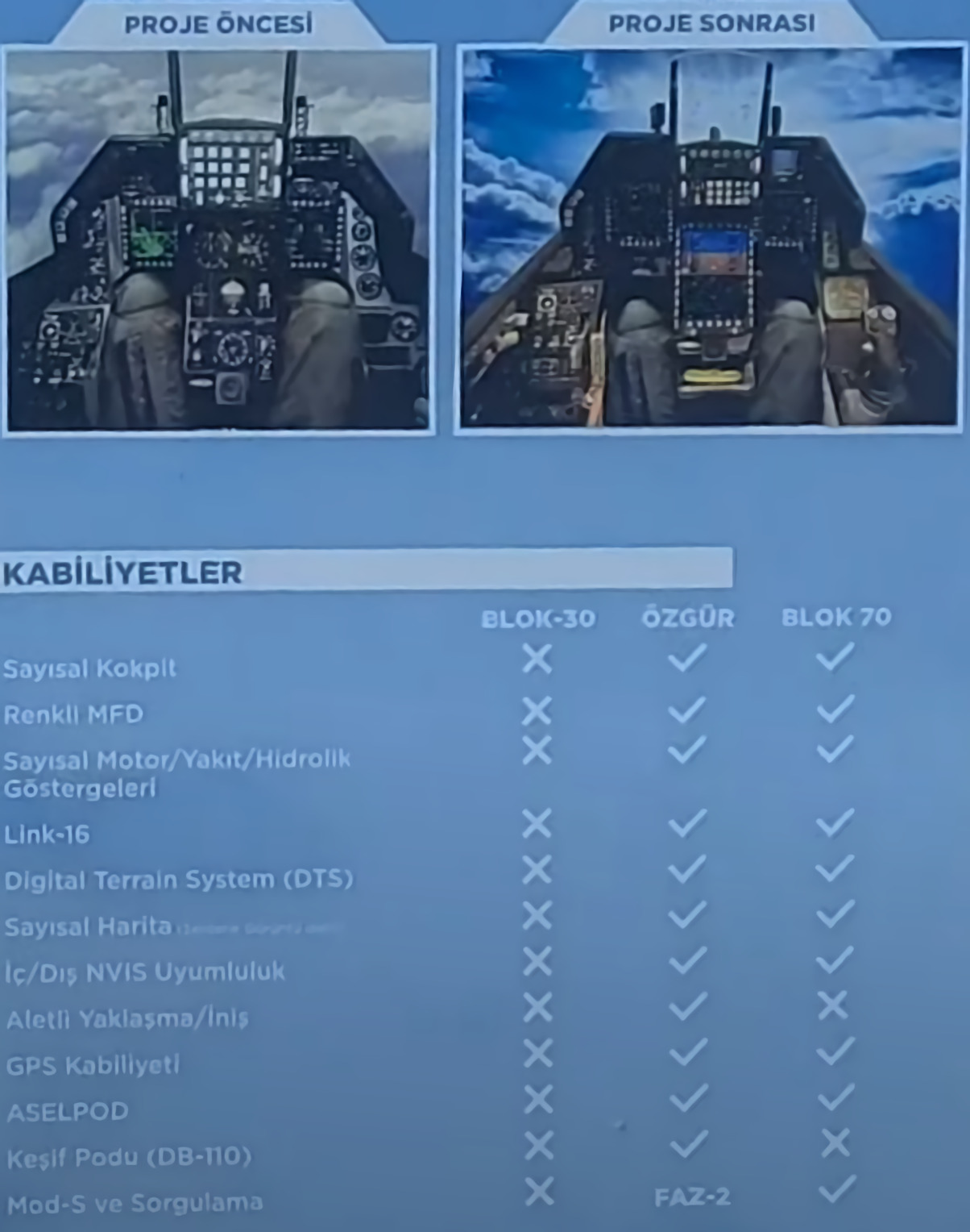

Which updates/upgrades comes with Ozgur project?
1. lifespan from 8000/h to 12000/h
2. New avionic/cockpit sytems
3. New pilot helmet
4. AESA radar
5. link-16
what I remember.
4,333
276 22,692
3. New pilot helmet
4. AESA radar
5. link-16
what I remember.
OK thanks !
1. Lifespan upgrade is not part of the Ozgur. They were for Block 30 only. Ozgur is for all aircrafts.
2. New avionics and cockpit system are definitely part of Ozgur.
3. The new helmet too is part of Ozgur. Although CCIP upgrade gave some form of Helmet cueing capability, Aselsan Helmet design will come with more upgrades for the Ozgur project.
4. Aesa too is a vital part of the Ozgur.
5. the Joint Helmet-Mounted Cueing System, Link 16 data link, were added to the f16’s through CCIP upgrade package of 2005. This will be added to the Planes.
5. indigenous IFF system too will be added to Ozgur.

F16 Özgür vs Block 70
