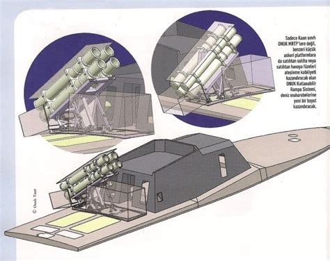

A few more note since i didn't have time earlier:
--installation with exhaust and in MK56 like VLS form only complicates the design and creates a perfect flat surface which AShMs can easily engage on.
instead of a VLS like integration, as an interim solution the following solution can be adapted:
--Between of two structures which missiles are installed on, a multi-purpose missile bay with oblique surfaces attaching to the board can be created to store missiles horizontally, thus managing Vertical Center of gravity while the vessel is on the go. Hisar-O is about 4.5+ meters with canister, and vessel is 7.6 meters in width.
--A common land vehicle launcher platform has 6 missiles on both Hisar-O and TRLG 230 / MRAShM, effective length of such a bay is about 8-8.5 meters thus 3 of such launchers can easily be installed, a pop-out mechanism can be used to elevate the launchers in oblique position when they are meant to be used.
-- for allowing Hisar to be launched vertically, exhaust redirection plates can be installed to direct exhaust towards to the sides.
Benefits:
-Common land launcher platforms are used and integrated with hydraulics,
-Stabilitiy, vertical center of gravity is protected in bad weather
-RCS has been managed remarkably
-Flexibility is provided, plug and play any missile you want.
Something like this with more extended application:
P

Yes, the Hisar canisters are displayed too large on the images. IRL it will be smaller.
9,866
67 22,010
I thought the Hisar canisters looked really wrong with respect to the vessels balance and efficiency.
It also looks very bulky. If it was possible to have missiles like Sakarya type (TRG-122) and size perhaps even T-107 type with IR that could be pretty awesome.
I would imagine that FAC are primarily suppose to be carrying AshM, so loading them with Hisar would imo be counterproductive. it's better to go for SR AD that doesn't take away the vessels main purpose.
If FAC are going to be able to receive target data from ULAQ. Then we could use the ULAQ to send target data for TRG-122 or even TRG-230 (depends on size).
Small and deadly means, small and hard to hit :)

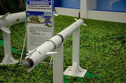

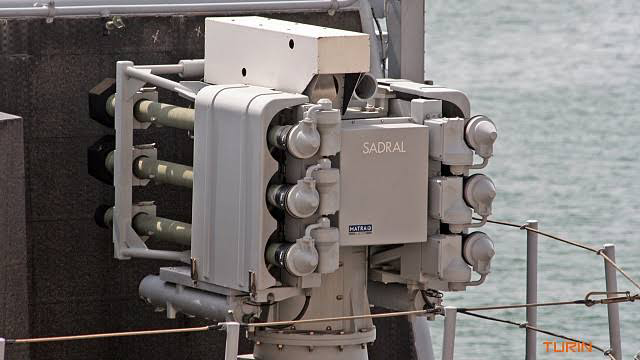

Gökdeniz CIWS and Hisar A combination should be used on old Gabya/ Barbaros frigates.
IMO there is one reasonable solution which is Turkish RIM-116 missiles for FACs.
The Chinese created FL3000N whose length is just 2 meter.
Being 1 Meter shorter than RIM-116, the FL3000N missile system occupİes little space.
For compact naval vessels maximum 6 missiles would be enough . Look French Navy how secure their warships.
Mistral Sadral
Mistral Sadral

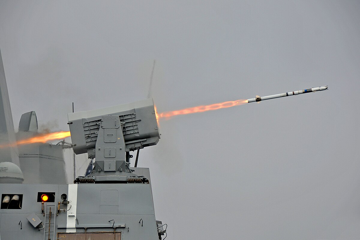

Are we producing RIM-116 ?
10 km range doesn't seem like much today.
  • Primary function: Surface-to-air missile
  • Contractor: Raytheon, Diehl BGT Defence
  • Length: 2.79 m (9 ft 2 in)
  • Diameter: 127 mm (5.0 in)
  • Fin span: 434 mm (1 ft 5.1 in)
  • Speed: Mach 2.0+
  • Warhead: 11.3 kg (24.9 lb) blast fragmentation
  • Launch weight: 73.5 kg (162 lb)
  • Range: 10 km (6.2 mi)
  • Guidance system: three modes—passive radio frequency/infrared homing, infrared only, or infrared dual-mode enabled (radio frequency and infrared homing)
  • Unit cost: $998,000
  • Date deployed: 1992
Turko
Not yet :) but soon we will see it.
We shouldn't expect Air defence frigate role from FACs . Both RAM and FL3000N are best defense systems against cruise missiles since they aren't launched vertically.
Moreover FAC's mere threat is cruise missiles.
UAVs , Fighters and other threats which fly at higher altitudes are the business of air defense frigates and land based long range SAMs.
Remember our ADA-class has just RAM.
