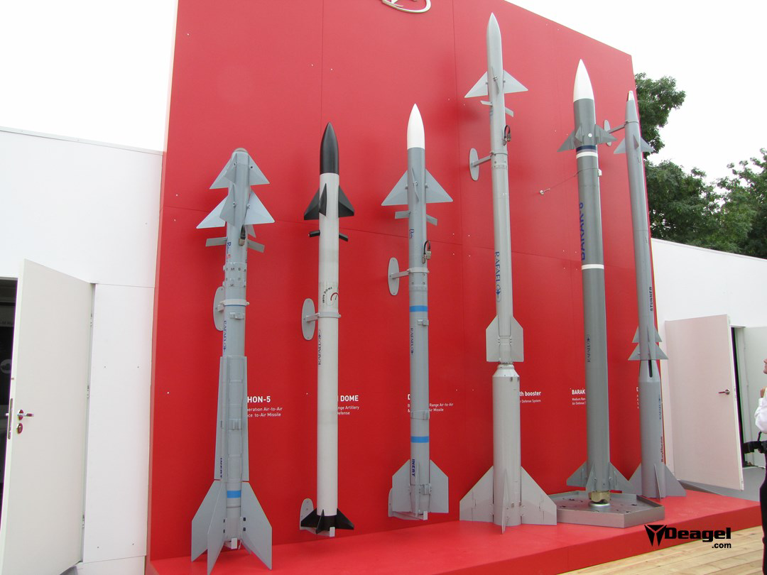

Look here is the Tamir missile. I cant see any IR seeker.
AFAIK Barak 8 reaches long range thanks to its speed, burning rocket fuel slower than other SAMs.
Comparing SAMs with 80 km range such as patriot, aster 30 the Barak 8 looks smarter. They have same dimensions with ESSM which has just 40km range.
İt's tricky how İsraeli rockets can reach longer range.

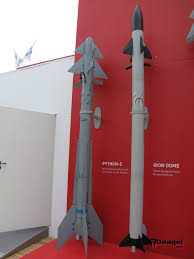

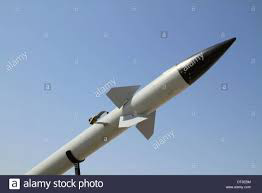

In order to reduce the drag detachable fairings are used:
In this video at 0:57 u can see the fairing separation well:
Long range of Barak 8 is achieved thanks to 2 pulse engine. First pulse accelerates missile and flies through ballistic trajectory (similar to artillery rocket) and when it approaches the target second pulse ignites to achieve maneuver and interception. You can see second pulse ignition in this video at 0:37:
Latest version of Patriot PAC-3 (MSE) also has two pulse engine.

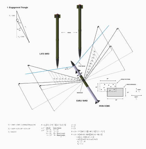

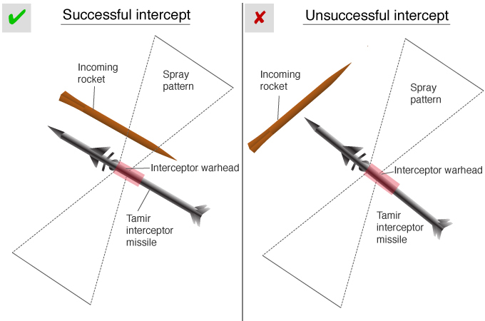

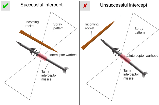

Tamir missile doesn't have IR seeker. It has very advanced proximity fuze.
Updated : the missile might have radar seeker!!??
Iron dome uses ELM-2084 S-band radar. S band is good for long range detection, its good for detection of stealthy targets and jam resistant. But it has low accuracy compare to cm and especially mm wave radars.
That's why the seeker is absolutely must have for the Iron Dome.
RF seeker would not need the separated fairing (they could simply use RF transperent fairing). Only IR seekers need it (IR seekers have relatively high drag),
BTW. Pantsir, which is pure radio guided missile uses mm wave radar to guide its missiles. That makes Pantsir vulnerable to weather conditions (clouds, rain, fog, dust), to stealth and jamming.
